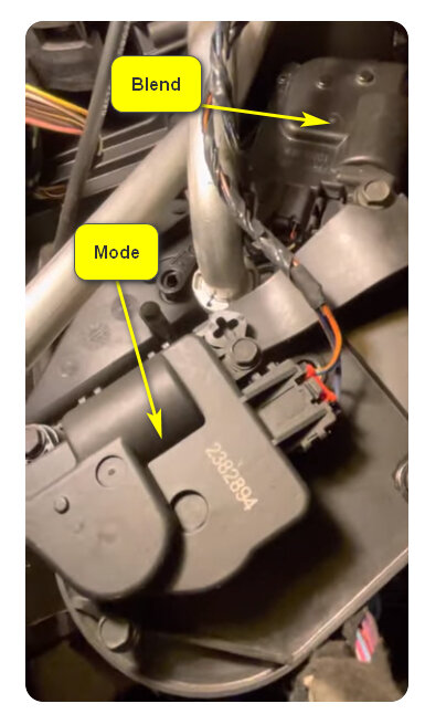

After the car runs for 15 to 20 minutes there is a single click that can be heard behind dash and immediately the temperature and mode climate controls become unresponsive. (Also, the two actuators on driver side. I know this because I have looked under the dash when the system is down, and neither actuator will be moving anything) However the fan speed will respond and the A/C will kick on if you push the A/C button. The car is a single zone system, not dual. I have already put a new climate control module/panel into the dash and replaced the mode actuator. I have not yet replaced what I think is the blend door actuator which is way up under the dash and very hard to get to. Strangely enough, if I turn the car off and then restart it all the controls will immediately begin working again, usually for a few minutes until I hear another single click behind dash and then the above mentioned controls and both actuators quit responding again.

For reference the blend door actuator is located just above the mode door actuator.
For trial you could fit the old mode door actuator in place of the blend door actuator.

Thanks Boris. Like you suggested I had been giving some thought to using the old mode door actuator which I had already replaced ( and which turned out not to be the problem) up at the blend door location instead of buying a new blend door actuator. I’ll see about my friend rescanning it first if he says he did the scan during a period when the climate controls had temporarily come back on due to the car being restarted, rather than during an inoperative period. The blend door actuator will be a very difficult replacement due to its location but I’ll have to give it a try unless another scan actually shows code(s) that indicate a different issue. Am hoping it is not the blend door itself sticking.

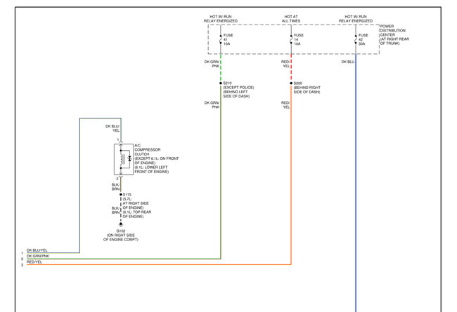

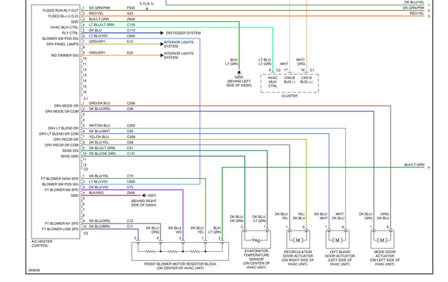

The blend and mode door actuators are directly controlled by the HVAC control module.
The HVAC control module is powered by fuse F41(10A) and fuse F14(10A) in the trunk fuse block.
Fuse F42(30A) supplies the blower motor with 12V ignition via dark blue wire to pin 2.
The only relays you have are for the AC compressor clutch and cooling fan activation.
Pin out at HVAC module connector C1(16 pin)
Pin 1, dark green/pink wire 12V ignition from fuse F41
Pin 2, red/yellow wire Constant 12V from fuse F14
Pin 3, black/light green wire Ground
Connector C2(12 pin)
Pin 1, orange/dark blue wire to mode door actuator pin 6
Pin 2, dark blue/orange wire to mode door actuator pin 1
Pin 5, white/dark blue wire to blend door actuator pin 6
Pin 6, dark blue/white wire to blend door actuator pin 1

Boris, I went ahead and replaced the blend door actuator and took the Chrysler 300 for a 45-minute drive. All the climate controls worked throughout the trip instead of the temperature and mode controls shutting down after about 15/20 minutes as had been the case. At this point it appears that the problem is corrected. Thanks again for your advice and assistance.
