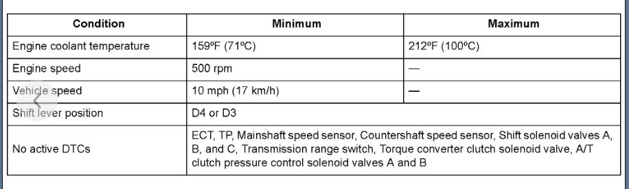

Good day to you all. My car shifts erratically and bangs when coming to a stop and when accelerating. In the morning when driving the car it shifts smoothly but later in the afternoon when the outside temperature is hot it begins to slips and shifts roughly. It will also accelerates slowly from stop on engaging the throttle and when it comes to a stop it bangs and and thud. When I checked the transmission fluid it appears stained with dark substances. On OBD scan it throws out the following codes: P1381, P1491, P0141, P1456, P0730. I want to know if my auto transmission is going bad to worst, do I have to change any of the shift solenoids, or is the problem internal within the transmission that is beyond repairs?. The last time this happens was in 2013, we only changed one of the solenoids ( I think A and B) and everything returns to normal shifts. But this seems to be worst than the previous one.
Please any opinion or suggestion will be helpful. Thanks and God bless.
N/B: please take note that the D4 light didn't blink. It all appears normal. No problem with the light

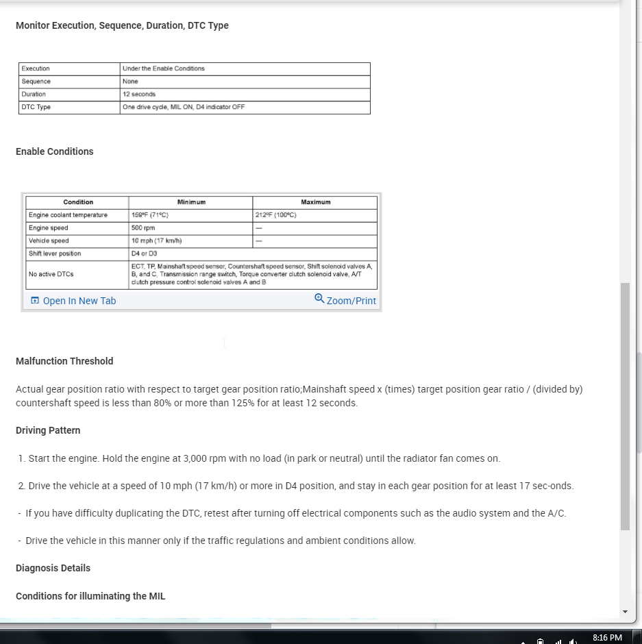

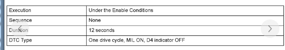

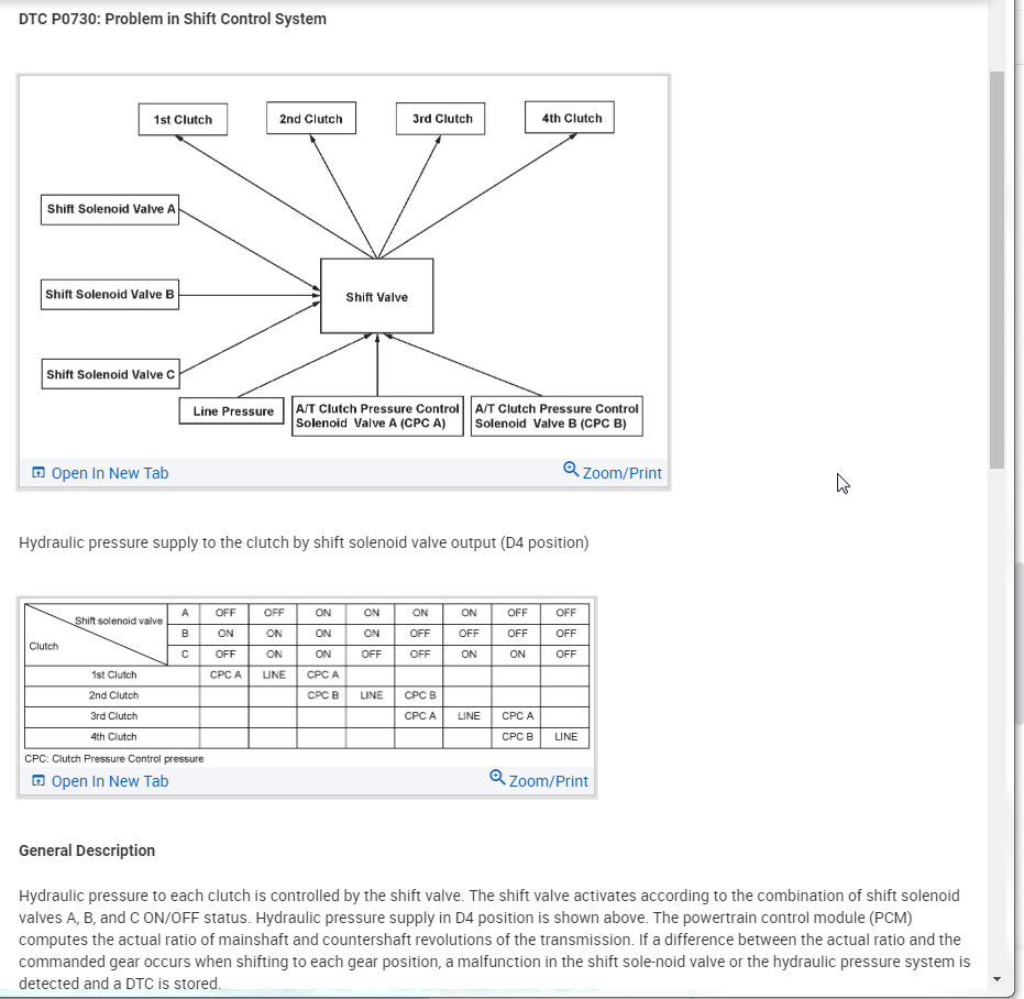

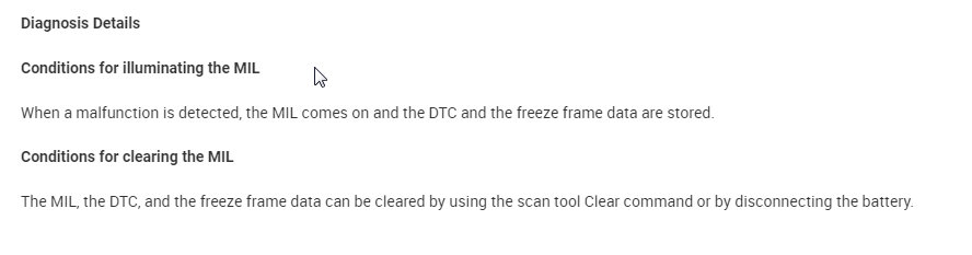

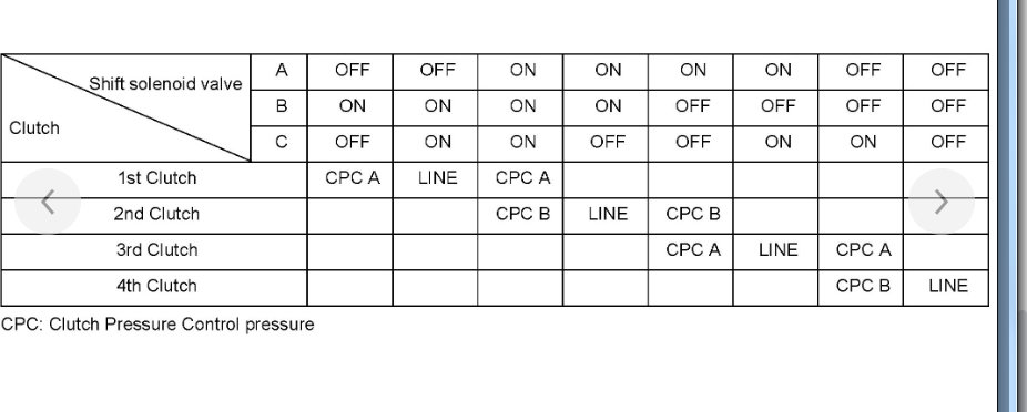

P1456 - EVAP Emissions Control system leakage
P1381 - Cylinder Position Sensor
P1491 - Exhaust Gas Recirculation EGR valve insufficient lift
P0141 - Secondary Heated O2 sensor
P0730 - Problem in Shift Control System
I would focus on the P0730. I attached the testing for this so you can run through it. Let me know what you find and we can go from there. Thanks

Thanks for replying, I am really grateful. I actually consulted a gear specialist in auto transmission, he was able to remove the three solenoids attached and then inspects it for any damages. He discovered the shift valve was malfunctioning and wasn't clicking very well so he has to able to correct it. He told me to change the transmission fluid to another brand probably dexron 111 oando products, that the present transmission fluids inside the gear is too watery.
I am planning replacing the fluids next week. Presently the car drives smoothly no sudden shifts from one gear to another but the distance is just few kilometers from my home to office. I will get back to you after all is done.
