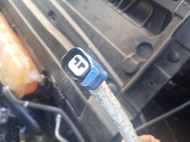

Greetings!
After rewiring a contaminated harness, I have a single, 2wire connector that I cannot locate it's location.
I know that it is an easy place to find, and will feel stupid once told where it goes. After all, I am the one who initially removed it.
Please advise thanks.

It looks shielded, like a knock sensor connector but if you tell me the color of the wires going to it I can tell for sure.

That would be green, green, yellow, brown, violet, and then of course, the solid black.

Also, that is the aluminum tape I used to cover the plug. There is no shielding on the actual plug itself OEM. However, This is coming from an electricians perspective, so, I am merely assuming I know what I'm talking about. Shielding is typically TeleData in my field of non expertise.

Hmmm,, it looks like a two wire connector? Am I missing something?

My apologies. I've asked a separate question related to a different set of wires. Please see the image below. White/violet, and black/violet.

That goes to the A/C compressor, please double check the wiring colors with the wiring diagram below. Check out the images (below). Please let us know what happens.
