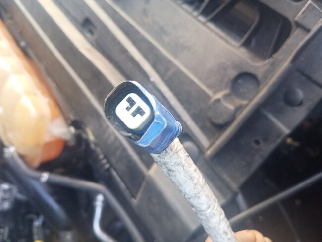

After rewiring a contaminated harness, I have a single, 2wire connector that I cannot locate it's location.
I know that it is an easy place to find, and will feel stupid once told where it goes. After all, I am the one who initially removed it.
Please advise thanks.

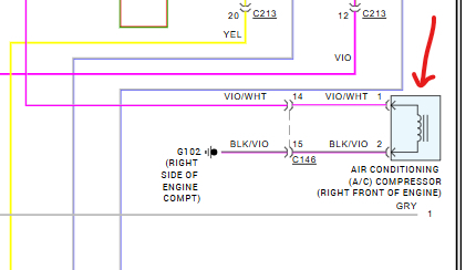

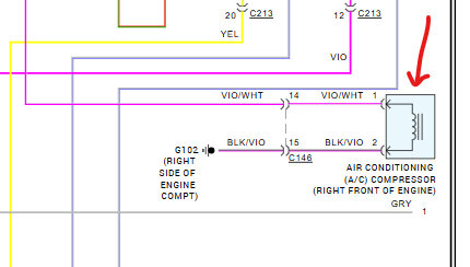

My apologies. I've asked a separate question related to a different set of wires. Please see the image below. White/violet, and black/violet.
Sep 18, 2025 at 7:47 AM
  • 55,433 POSTS
That goes to the A/C compressor, please double check the wiring colors with the wiring diagram below. Check out the images (below). Please let us know what happens.
