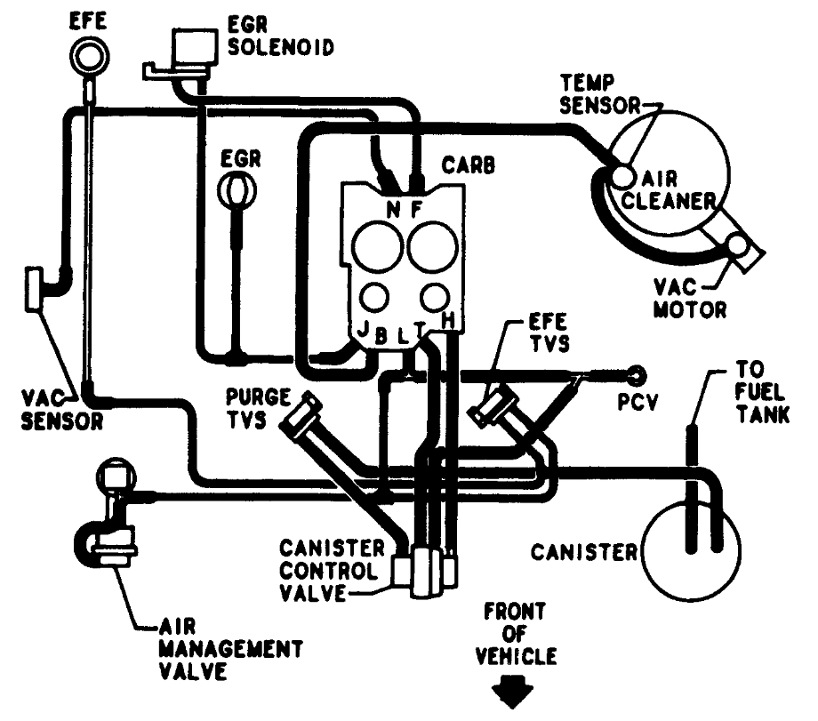

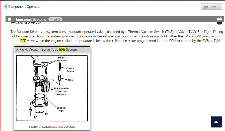

I would like to know what these two parts look like and do I have to TVS? My emission hose diagram shows to a purge TVS and ERE TVS.

If your asking about the EFE style vacuum servo your car will only have one in the exhaust system.I've attached a picture below.Hope this helps and let me know if you have any other questions.Thanks for using 2CarPros.

Now the hose on the EFE that plug into the vacuum source in the diagram what is that leading into. Because mine is just a long hose To nothing

Here's the vacuum hose diagram for you.
