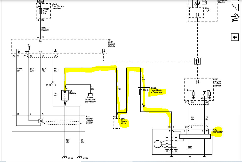

Also, I need you to check the red wire at the alternator to make sure there is battery power to it. Power to that wire starts at the battery, goes to the starter motor, and from there is goes through a fuse and to the alternator. If there is no power present, the alternator won't charge.
I attached a schematic below and highlighted what I am referring to. Make sure power is present at that wire on the alternator. Note: It should have power at all times, to make sure not to cause a short.
Let me know what you find.
See pic below.

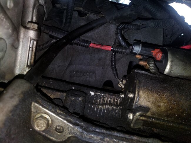

This is what I see between the starter and the alternator.

  • 110,248 POSTS
Hi Sidney,
I don't think the fuse is in a fuse box. Rather, I believe it is incorporated into the wire between the starter and alternator.
I copied your pic above. I circled what I believe may be the fuse. Note: This is a 200-amp fuse. I am able to see the number 2 in the pic. Is that 200?
Also, to check for power at the alternator, you can use a voltmeter, a multimeter or even a simple test light. We just need to determine if there is power at the alternator from the starter. If there isn't, then the fuse is the likely cause. If there is power, we can assume the fuse is good and we need to check in other places.
As far as a test light, you can get one for under 10 dollars. I attached an example of one on amazon below. If you had that light, the alligator clip would go to the battery negative terminal, and you would probe the pointed light side on the wire you are checking for power. If there is power, the light would turn on.

SIDNEY HUGGINS
  • 15 POSTS
Hello, I did the test light and it seems to be getting power on all the red wiring I checked from the starter to the alternator I even checked the power from the battery and it was good please tell me what's next.

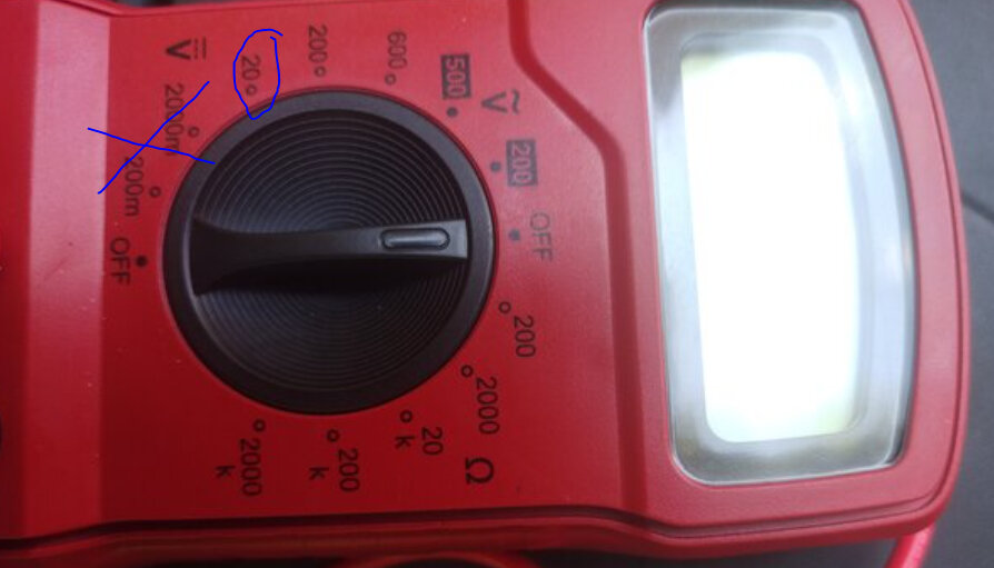

Hello and thanks again for your help. I haven't done the test yet but when testing for power I found a lose wire it was connected back when I cranked up everything ran fine for about 20 minutes then my dashboard lights started flickering and the messages begin to appear again then the vehicle eventually shut off and won't turn over because the battery is drained again.

SIDNEY HUGGINS

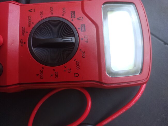

This is the multimeter I have which setting do I use to perform the test there is no plain v setting.
Aug 1, 2023 at 5:46 AM
  • 110,248 POSTS
I copied your pic and circled where to start. The section I placed an X over is millivolts. If you set it there, it will damage the meter.
Before testing, set it where I indicated and check the battery voltage right at the battery. It should indicate around 12v. If it is below that, we have a weak battery.

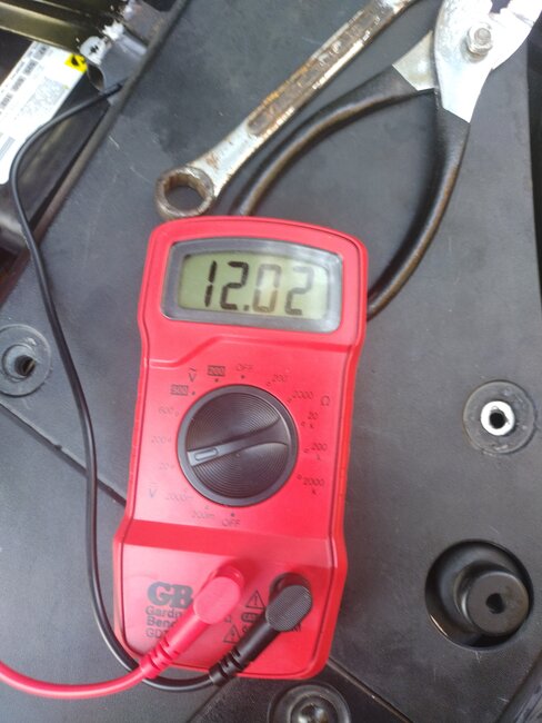

This is what I read with the engine off however car won't turn over.
Aug 1, 2023 at 9:36 PM
  • 110,248 POSTS
Won't start or the starter doesn't engage? If the starter won't engage, see if the voltage at the battery drops when a helper turns the key to the start position.

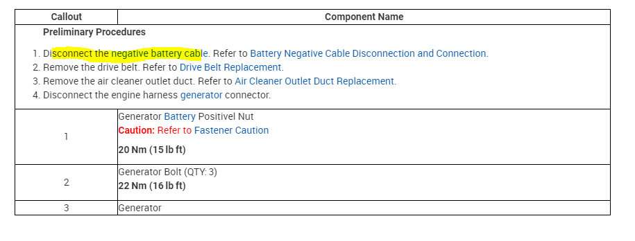

If the voltage continues to drop while the engine is running, the alternator isn't charging the battery. We need to remove the alternator. Once that is done, take it to a parts store and ask them to bench-test it. If it fails, replace it.
I attached directions below specific to your vehicle. Take a look through them and let me know if you are comfortable doing it. Note: Make sure you have the battery disconnected before you start working on the alternator.
Also, here is a link that explains how to replace an alternator in general. I feel it is more descriptive and helpful.

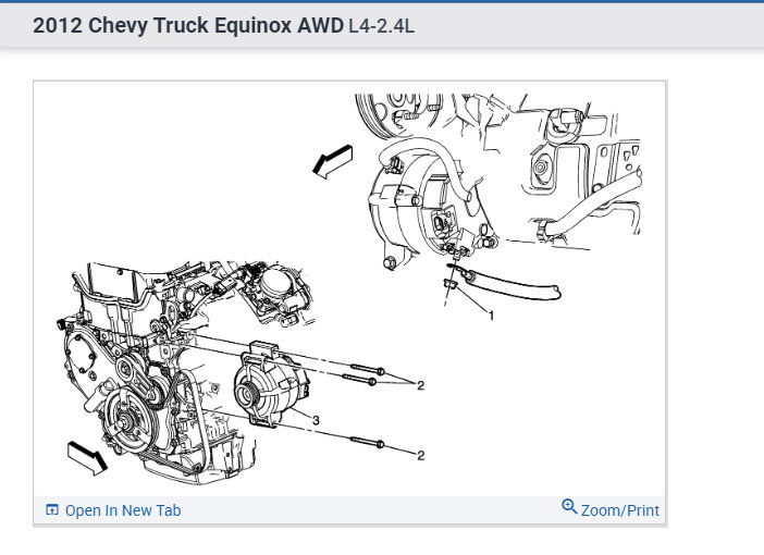

Okay, after looking again there is a wire running into the alternator that I did not check because I couldn't get to it with the tester. It looks like that same wire is running from the inline fuse to the starter that I already tested were good. Do I need to take the alternator out to check that wire?
Aug 6, 2023 at 9:58 PM
  • 110,248 POSTS
You shouldn't need to remove the alternator to check it. Could you take a pic of its location and upload it for me to see? Maybe I'll be able to give you some ideas.
Note: Remember that the wire I am talking about should always have battery voltage (if the fusible link is good). Be careful not to short it on anything metal.
