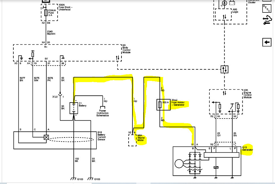

Hi
By chance, did you check the alternator output using the link I attached above?
Also, I need you to check the red wire at the alternator to make sure there is battery power to it. Power to that wire starts at the battery, goes to the starter motor, and from there is goes through a fuse and to the alternator. If there is no power present, the alternator won't charge.
I attached a schematic below and highlighted what I am referring to. Make sure power is present at that wire on the alternator. Note: It should have power at all times, to make sure not to cause a short.
Let me know what you find.
See pic below.
Jul 27, 2023 at 1:26 PM

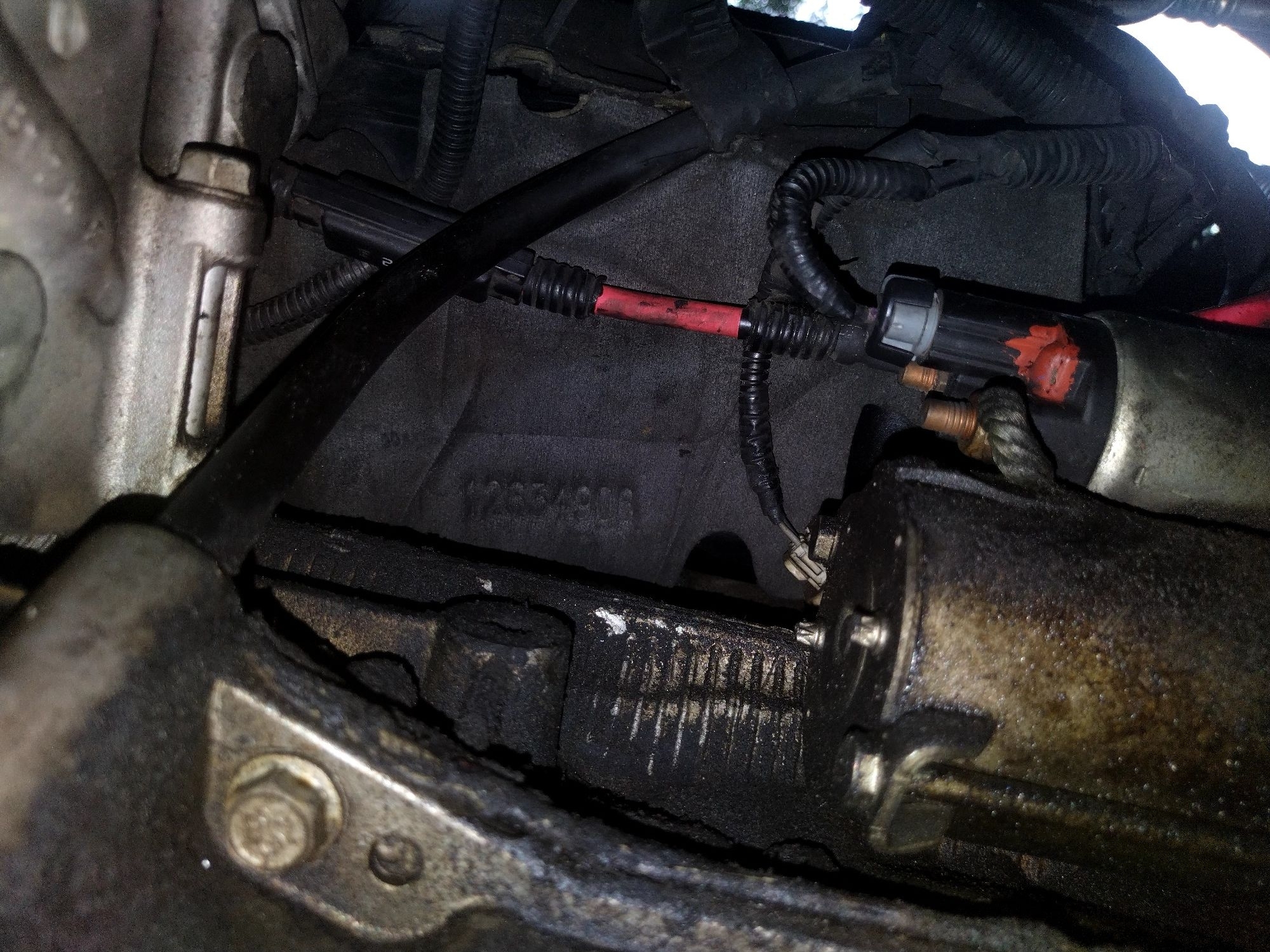

This is what I see between the starter and the alternator.
Jul 29, 2023 at 7:26 AM
  • 110,240 POSTS
Hi Sidney,
I don't think the fuse is in a fuse box. Rather, I believe it is incorporated into the wire between the starter and alternator.
I copied your pic above. I circled what I believe may be the fuse. Note: This is a 200-amp fuse. I am able to see the number 2 in the pic. Is that 200?

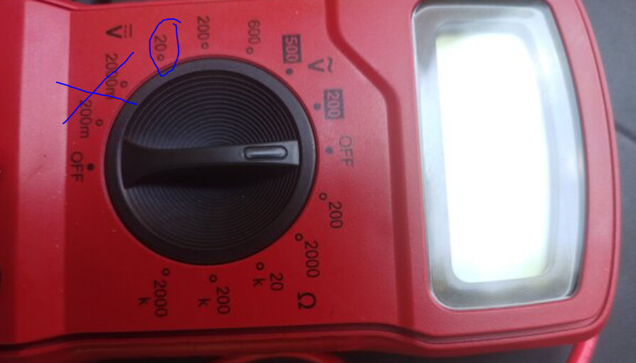

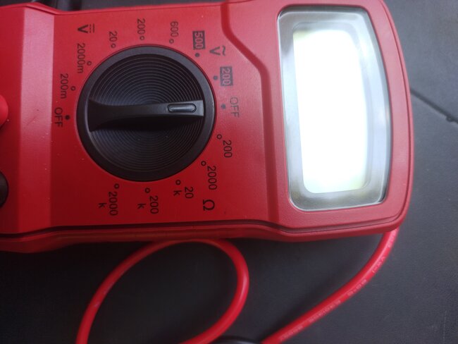

This is the multimeter I have which setting do I use to perform the test there is no plain v setting.
Aug 1, 2023 at 5:46 AM
  • 110,240 POSTS
I copied your pic and circled where to start. The section I placed an X over is millivolts. If you set it there, it will damage the meter.
Before testing, set it where I indicated and check the battery voltage right at the battery. It should indicate around 12v. If it is below that, we have a weak battery.
Let me know what you find,
see pic below.
Aug 1, 2023 at 12:54 PM

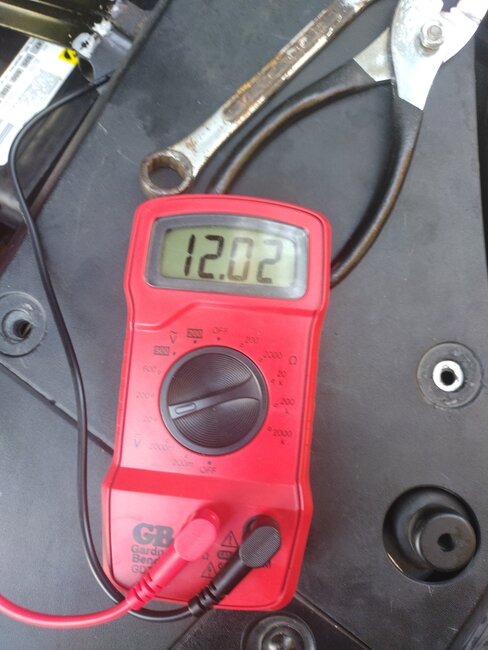

This is what I read with the engine off however car won't turn over.
Aug 1, 2023 at 9:36 PM
  • 110,240 POSTS
Won't start or the starter doesn't engage? If the starter won't engage, see if the voltage at the battery drops when a helper turns the key to the start position.
Aug 2, 2023 at 10:45 AM

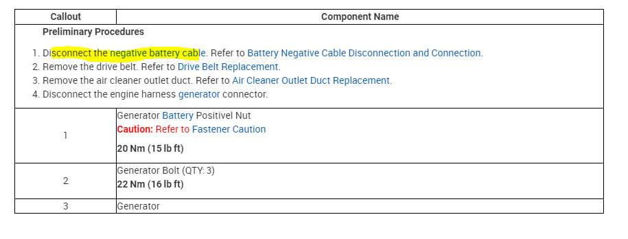

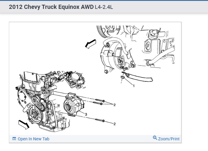

If the voltage continues to drop while the engine is running, the alternator isn't charging the battery. We need to remove the alternator. Once that is done, take it to a parts store and ask them to bench-test it. If it fails, replace it.
I attached directions below specific to your vehicle. Take a look through them and let me know if you are comfortable doing it. Note: Make sure you have the battery disconnected before you start working on the alternator.
Also, here is a link that explains how to replace an alternator in general. I feel it is more descriptive and helpful.
https://www.2carpros.com/articles/how-to-replace-an-alternator
