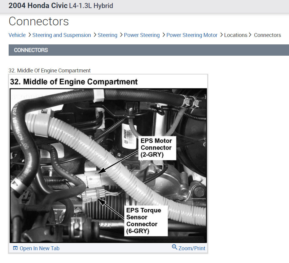

Greetings, please I need help for my car.. the steering is heavy and EPS light is on the dash board. My technician advised me to get another EPS control unit which i got from the same model of the car but from a diesel car. The problem still the same and my technician advise I get another EPS control with a matching parts number for it to activate the rack. This is diagnosis result.
1. A problem with circuit torque sensor Amp.
2. A problem with voltage for torque sensor VT3 and VT6 .
3. Excessive charge of the vehicle speed sensor signal.
4. A problem with the engine speed signal circuit.
5. A problem with the motor voltage.
6. Fail -safe relay.
Please what can i do to fix this? it is driving me crazy. Solomon from Nigeria.

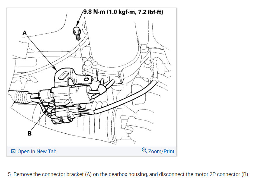

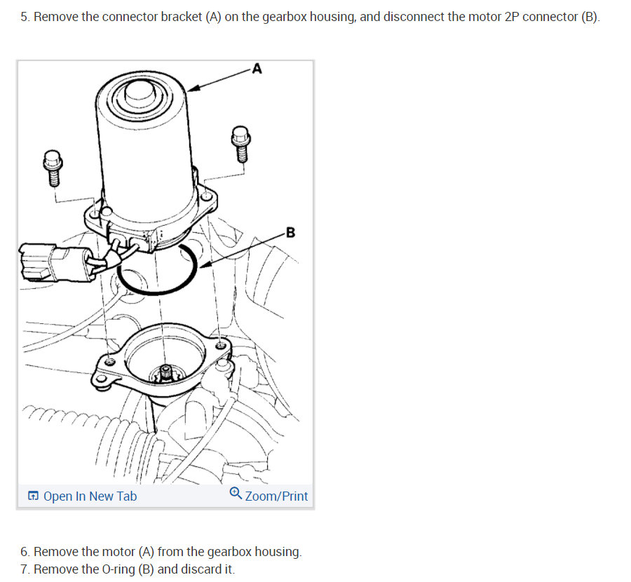

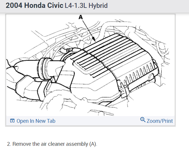

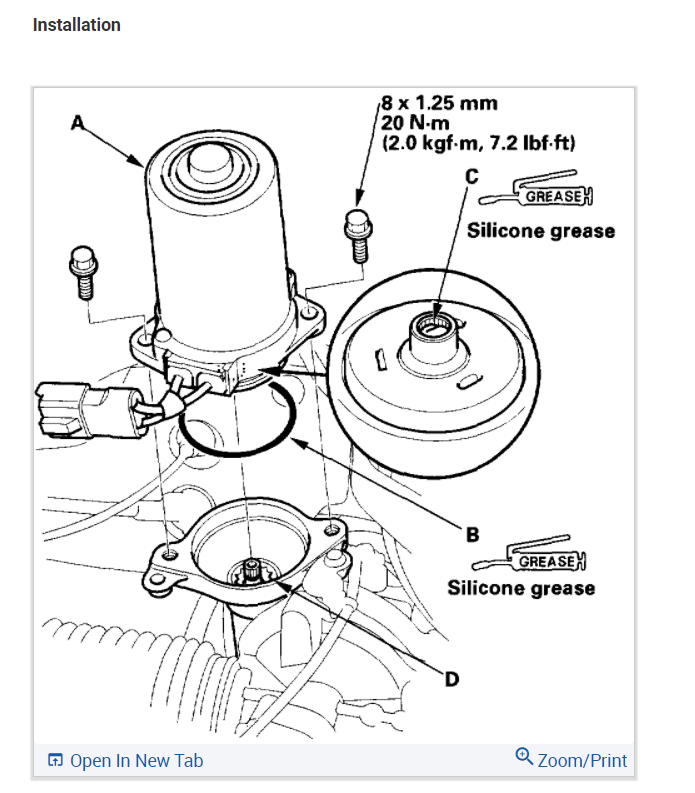

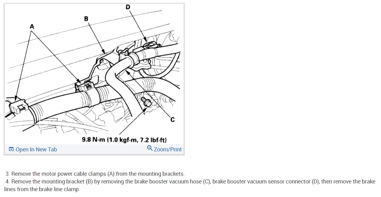

9 times out of 10 it will be the power steering motor here are the instructions on how to change it out in the diagrams below. Check out the diagrams (Below). Let us know what happens and please upload pictures or videos of the problem.
Mar 1, 2018 at 1:19 AM
SOLOMON EHIWARIO
thank you for your help I got a used unit worked great! I love this website :)
