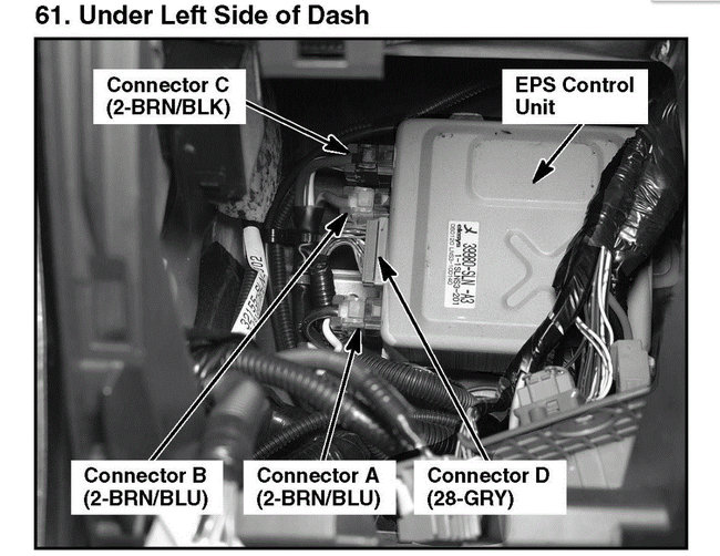

My power steering light comes on when I start my vehicle. I’ve tried shutting the car off and back on and the light remains. I have no power steering as long as that light is on, if I drive it for approximately 2 minutes the light kicks off and my power steering comes back. I went to a local garage and they gave me the 37-01 code.

This seems to be a common problem with the EPS control unit. The first thing I would suggest is to check the wiring to the control unit. Make sure nothing is loose, damaged, or corroded. If everything checks good, chances are the EPS control module has an internal fault and will need to be replaced.

The EPC control unit is under the left side of the dash. If you look at pic 1 below, it shows the part and connectors to it. Make sure they are in good condition and not damaged.

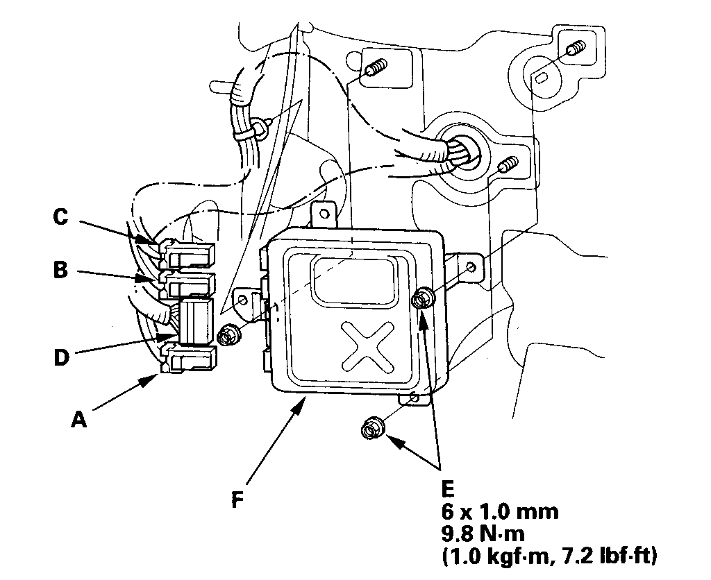

If you determine the control unit is bad, here are the directions for replacement. Pic 2 below correlates with these directions.

EPS CONTROL UNIT REMOVAL/INSTALLATION
EPS Control Unit Removal/Installation
1. Make sure you have the anti-theft code for the audio system.
2. Make sure the ignition switch is OFF, then disconnect the negative cable from the battery.
3. Remove the driver's dashboard undercover.
4. Remove the under-dash fuse/relay box).
5. Disconnect EPS control unit connector A (2P), connector B (2P), connector C (2P), and connector D (28P).
See pic 2
6. Remove the nuts (E) from the EPS control unit (F).
7. Remove the EPS control unit.
8. Install the EPS control unit in the reverse order of removal.
NOTE: The EPS control unit has three 2P connectors; make sure they are correctly reconnected. The locations of the three 2P connectors are the top: connector C (RED, WHT/RED wires), the middle: connector B (GRN wire), the lower: connector A (BLK, WHT/BLU wires).
9. Reconnect the negative cable to the battery, and do the following items:
^ Enter the anti-theft code for the audio system.
^ Set the clock.
^ If the EPS control unit is replaced, the EPS control unit must memorize the torque sensor neutral position.
10. After installation, start the engine, allow it to idle, and turn the steering wheel from lock-to-lock several times. Check that the EPS indicator does not come on.
