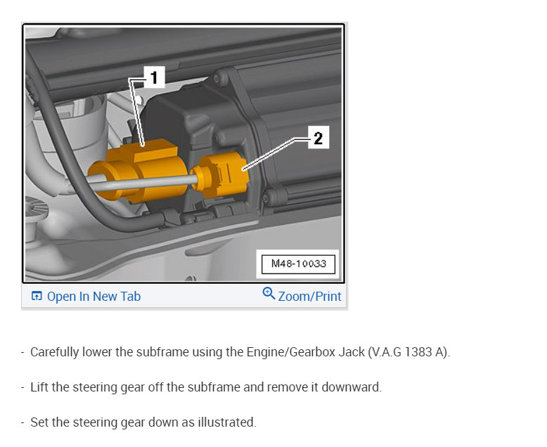

After being diagnosed, I was told it was an EPS pump. I had new pump and warning light still on.
Sep 26, 2022 at 8:05 AM
  • 55,395 POSTS

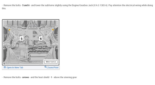

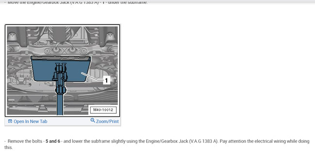

With the light on it has a code that needs to be found out Euro cars are a little different, but I would do a CAN scan which is easy. You can get a CAN scanner (Controller Area Network) from Amazon for about $36.00. here is a video to show you how. It sounds like it is the electric rack is out this what they replaced?
https://youtu.be/u-4syLc-ifQ
and
Amazon CAN scanner link for about $35.00.
https://amzn.to/3R9lJ60

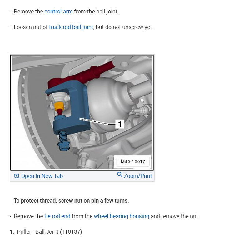

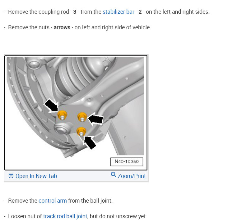

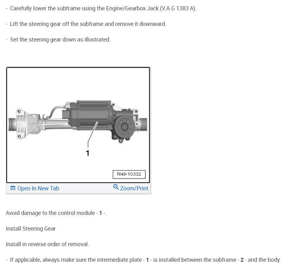

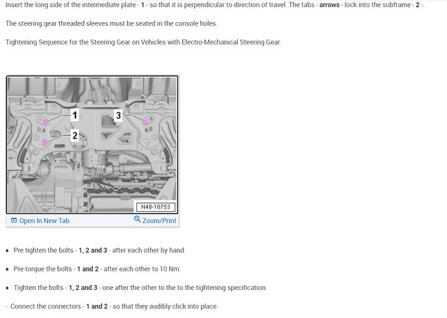

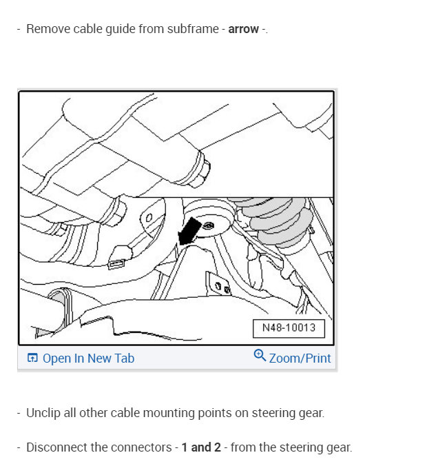

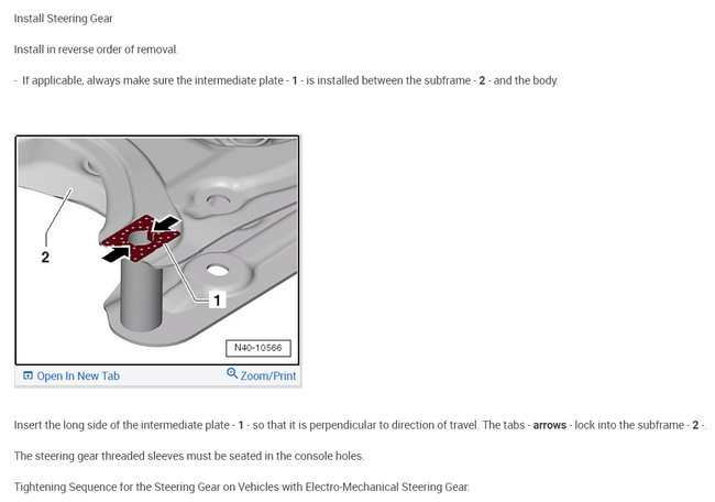

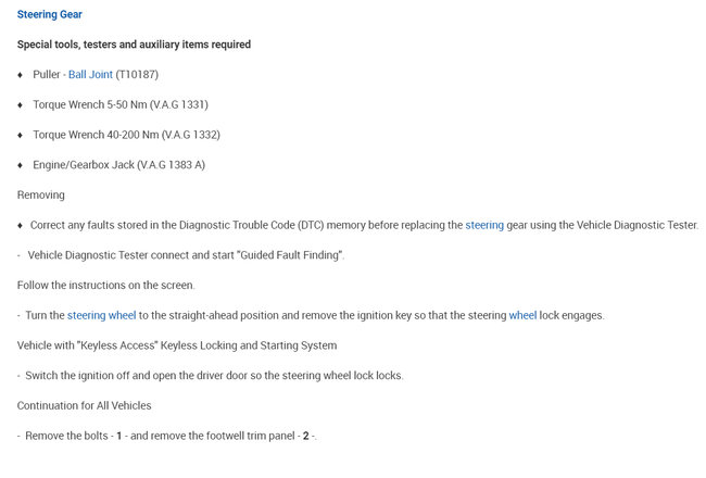

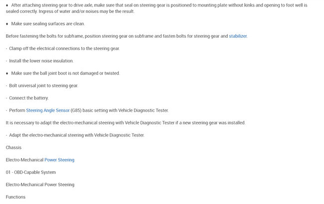

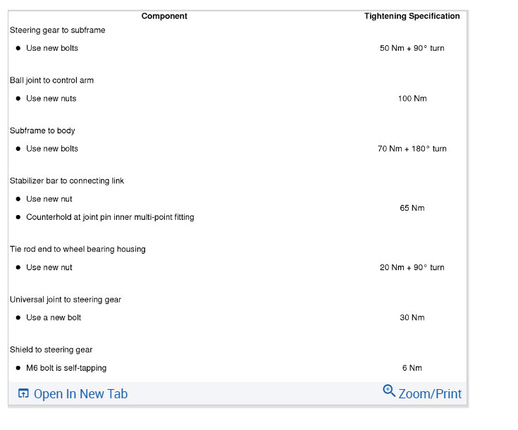

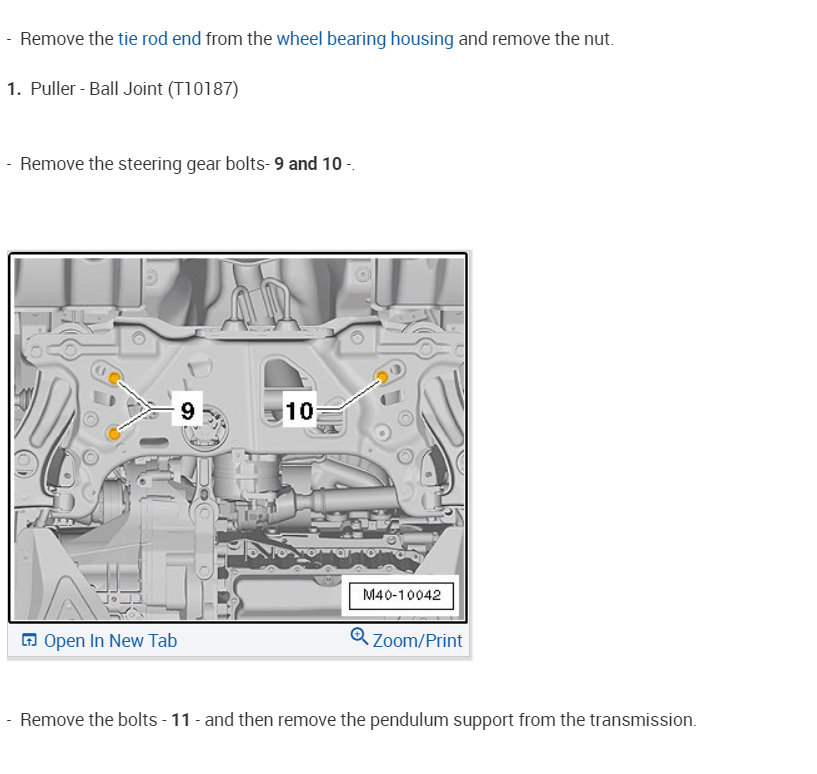

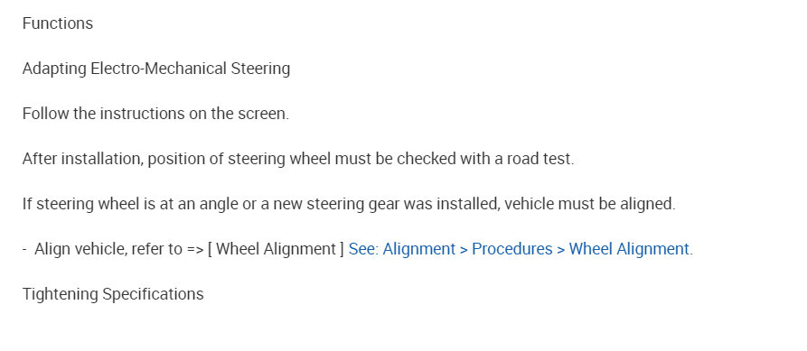

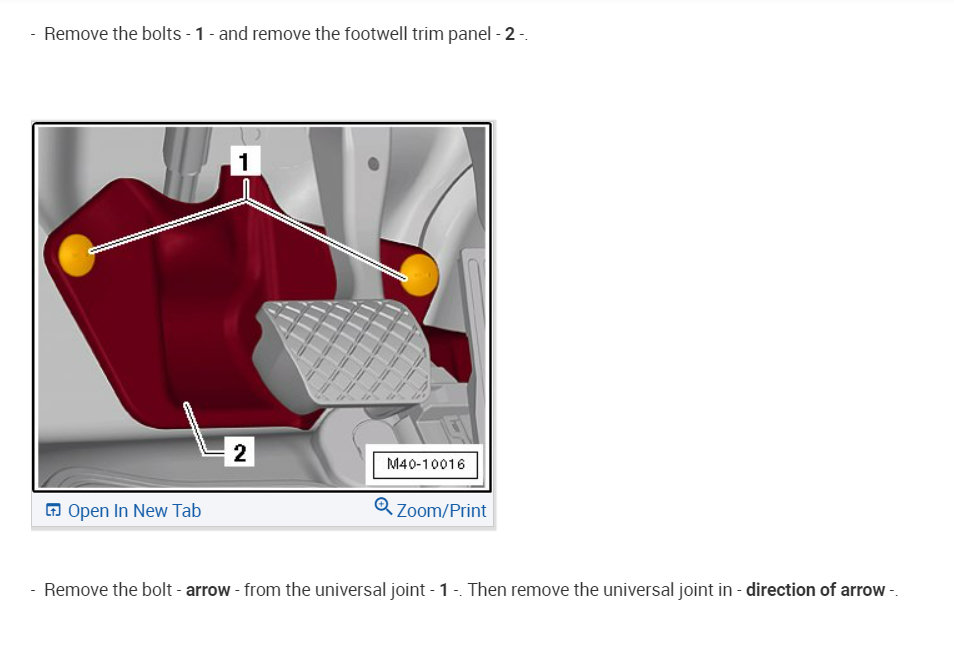

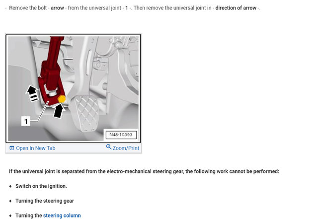

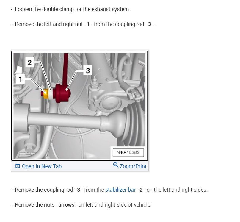

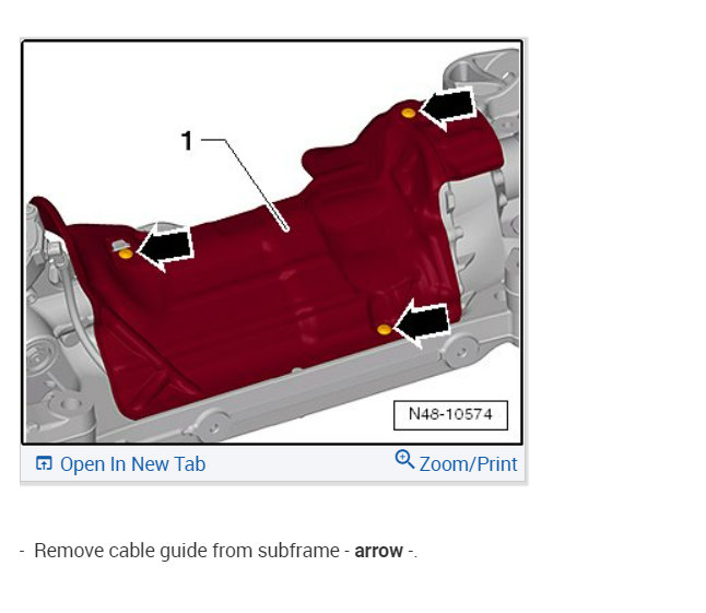

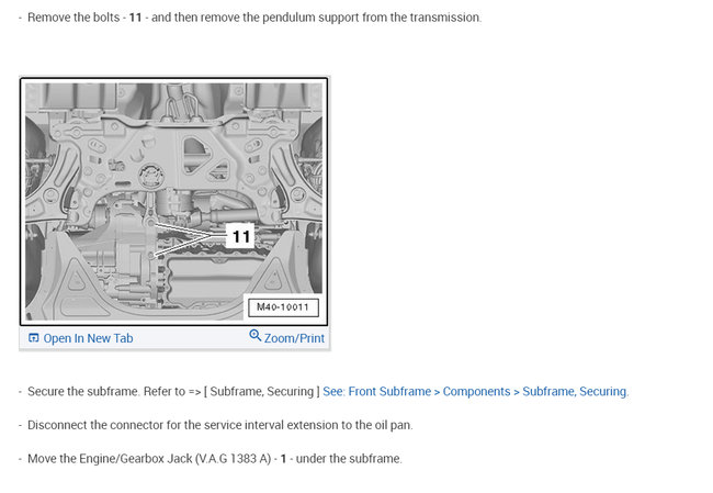

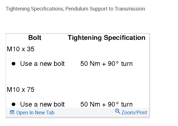

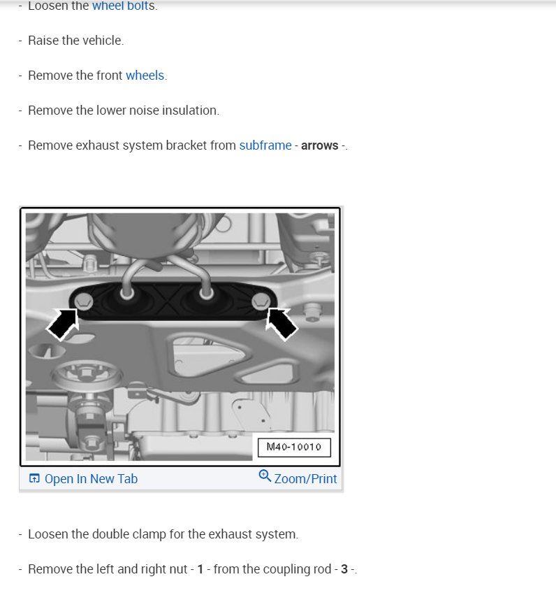

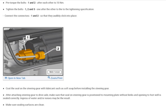

Here is how to replace the electronic rack in case you need it or what to see how the job is done. Check out the images (below). Let us know what happens and please upload pictures or videos of the problem.
