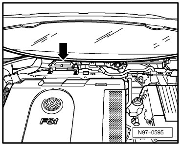

To be honest, you should scan the computer to see if there are any codes stored. Otherwise, it is going to be a guessing game. Since it isn't staying on, I have a feeling there may be a loose connection or damaged wire. The EPC (electronic power control) basically sends a signal to the ECM (engine control module) and the ECM is what triggers the light. With that in mind, I would suggest that you check and confirm there is no problem with the wiring at the EPC. It is located under the hood/top of firewall.
See the attached picture for location.
Let me know what you find.
