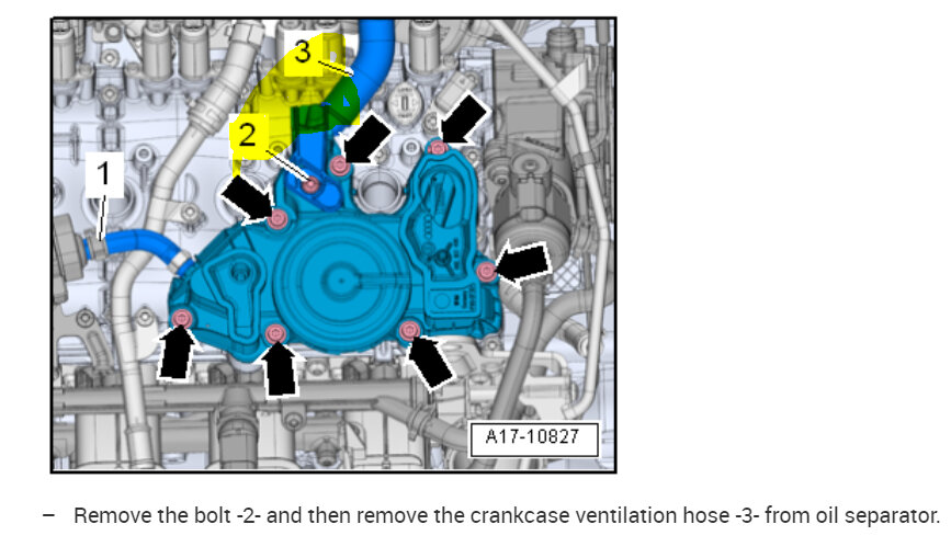

Have you noticed any blue smoke from the exhaust? If you open the air filter box, is there any oil in it? If there is, have you checked the crankcase oil separator which functions as a vent? (see pic below)
Let me know. Also, I looked up oil consumption. VW considers a half quart of oil used in 600 miles acceptable. Let me know if you are using more.
See pic below.

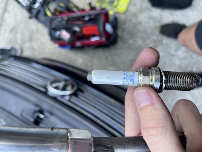

Thank you. I replaced the spark plugs. 1 and 4 were oil covered, but after replacement the EPC light has not gone on. I am concerned that there is a broken seal, forgive my ignorance, and worried that it would be very expensive to repair.

Could you take a couple of pics of the end of the spark plugs that were in the engine? I would like to see how much oil was on them.
I just did a little checking and found six technical service bulletins related to oil consumption testing. That leads me to think there have been a lot of concerns. Otherwise, it wouldn't show up with the bulletins. You may want to contact a VW dealer and ask if there are oil consumption related to your vehicle. It's a thought at this point.

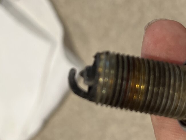

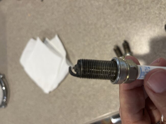

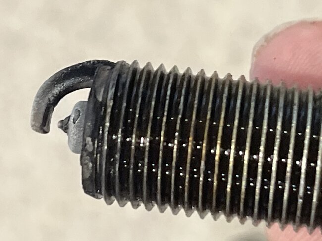

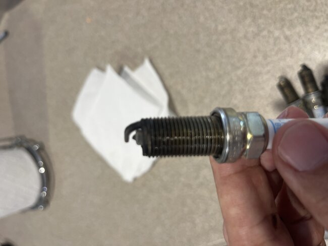

Here are picks. After 20 miles the EPC light went on again.

They do look oil fouled. How much oil does it use? Is it more than a half quart within 600 miles? If it is, contact a VW dealership and explain your concerns to see if there are any recalls or other notifications.
