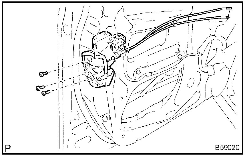

Cannot unlock door with key.
Tuesday, March 19th, 2019 AT 1:30 PM
  • 109,874 POSTS
Welcome to 2CarPros.

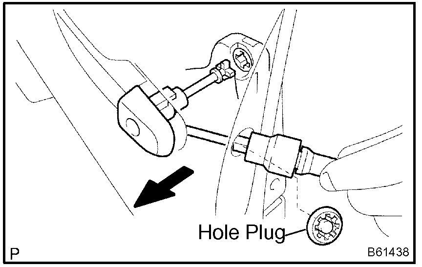

If the lock tumbler turns but the door won't unlock, chances are the linkage between the tumbler and lock assembly is disconnected or broken.
What I need you to do is remove the outside handle and lock assembly and inspect linkage to confirm nothing is wrong. I attached two pictures. First shows how to access the retaining bolt. The second shows how to remove the latch assembly if needed.
Here are the directions:
See Picture 1

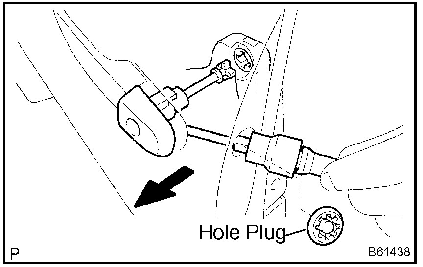

REMOVE FRONT DOOR OUTSIDE HANDLE COVER LH
a. Remove the hole plug.
B. Using a torx socket wrench (T30), loosen the screw and remove the cover with the door lock key cylinder installed.
C. Remove the cylinder from the cover.
______________________
Picture 2 shows how the latch assembly is removed.
