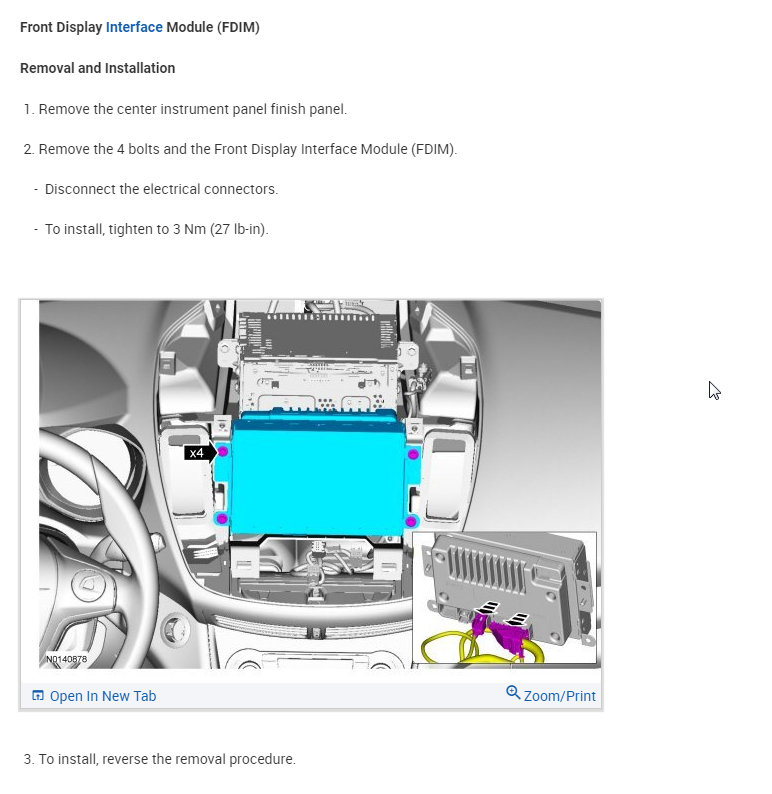

Just to clarify, the part number you gave me is for the display unit only (FDIM). I thought you said you put the radio unit in it as well.
Is this the only part that you have put in it? CJ5T-18B955-FC
If not, what is the part number for those parts as well? Thanks

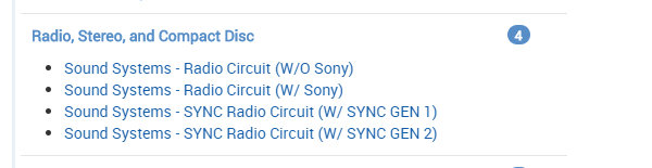

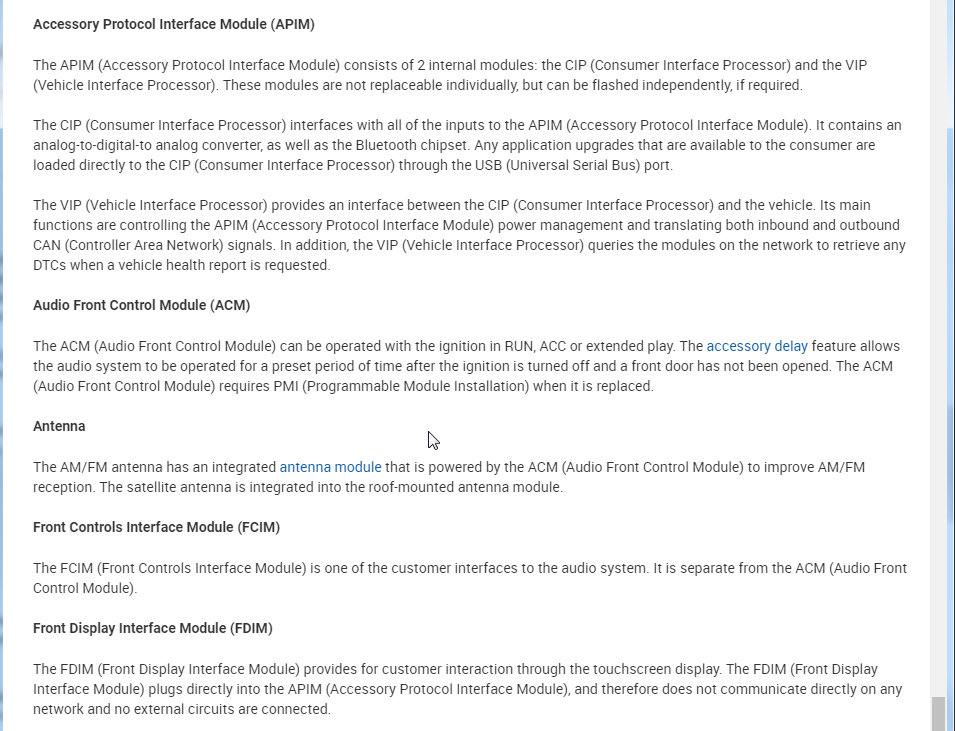

Yeah. The screen just displays what is sent to it. The fact that you don't have audio either points to the control side. Here is the problem, you have what is called the FCIM and the ACM. The ACM actually controls the audio portion of the radio however, the FCIM controls your interface with the audio system (ACM).
The only way to know which one of these is causing this issue is to hook a scan tool to it and see which module is on the communication network.
At this point we are guessing but simply due to the fact that you have no audio or touch screen, I suspect the FCIM is the issue.
Refer to the attachment in my prior post for the detail on these two modules.
