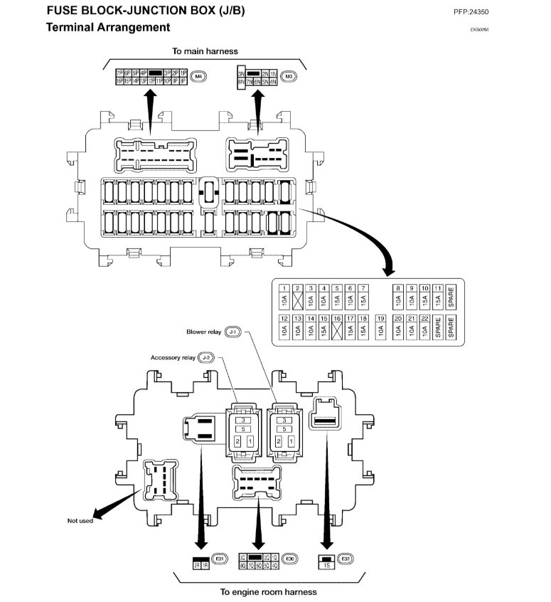

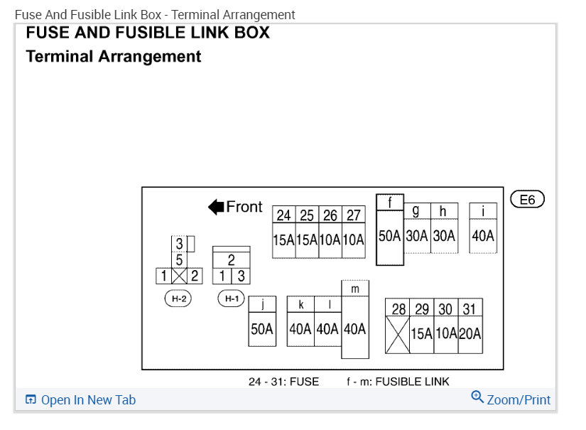

The first thing we should do is check the fuses. here is a guide and the fuse location in the diagrams below:
This guide can help as well.

Yes sir, we checked all the fuses they all seem to be in right shape. I called a locksmith who deals with this sort of is you he said he could not get in with his computer something about and taught the shut down. I was wondering if you think it's possible a brain box would be blue and if there's anything I can do cheaper than taking it into the shop? I'm barely making it as it is these days. thank you for your quick reply.

I just replaced the battery! I removed off my parts car the fuse box underneath the hood replaced every fuse still won't start.

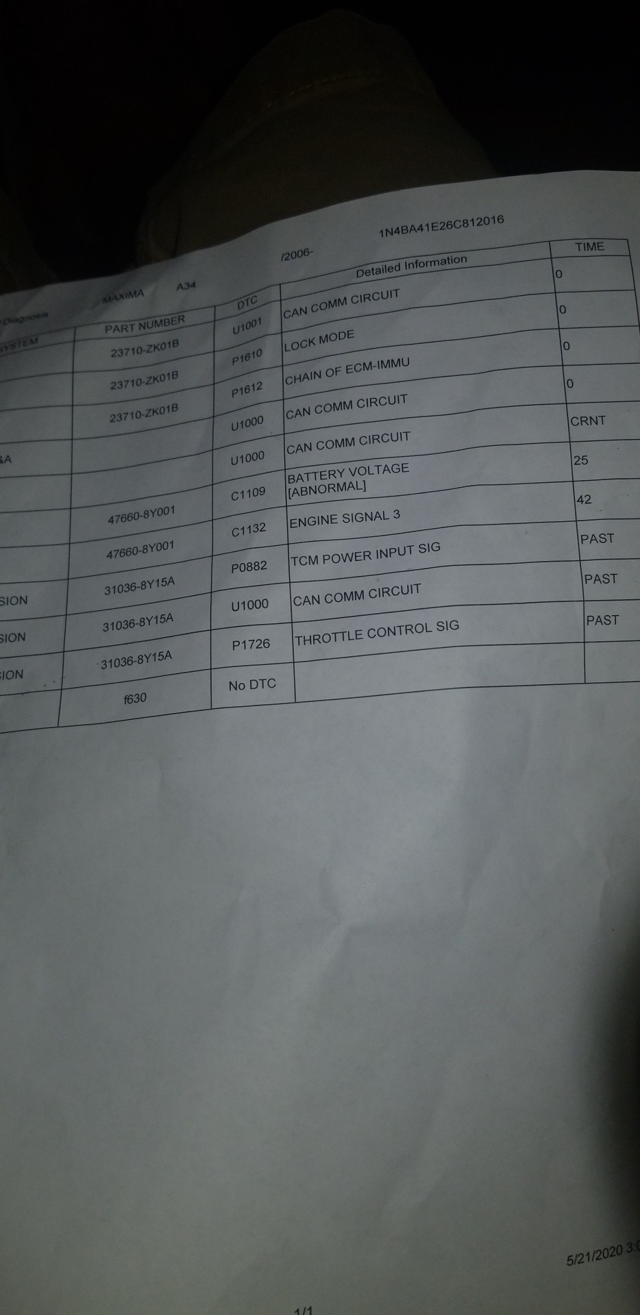

I had the Nissan dealership diagnosed my car this is what they gave me! I have a buddy who told me Nissan was just trying to pump me for as much money instead of telling me the easy way to fix it resetting the ECU computer system. what do you think?
May 23, 2020 at 9:11 AM
  • 55,423 POSTS
These can be caused by a timing belt being off one tooth. Can we do the compression test to confirm or remove the timing belt cover?
