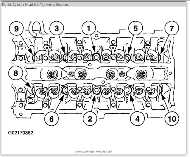

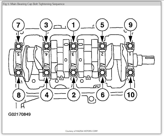

i am doing an engine so i am looking for engine torques.

Hey Fafatech500,
We don't have this car in the states but I think I found the specs that will work , please let me know.
Install the main bearing caps.
Tighten the bolts using the sequence shown in two stages.
Stage 1: Tighten the bolts to 25 Nm (18 lb-ft).
Stage 2: Tighten the bolts an additional 60 degrees.

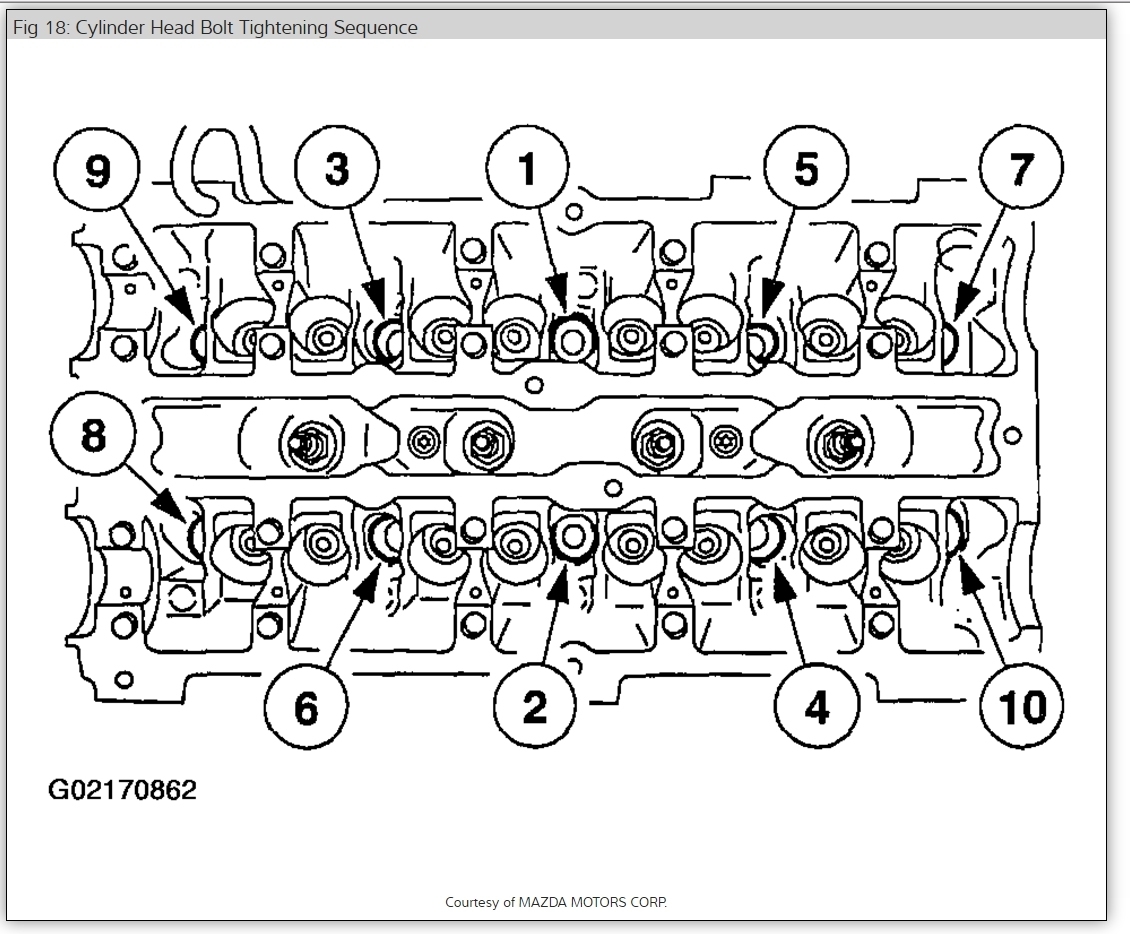

Install the cylinder head and tighten the bolts in three stages using the sequence shown.
Stage 1: Tighten the bolts to 20 Nm (15 lb-ft).
Stage 2: Tighten the bolts to 40 Nm (30 lb-ft).
Stage 3: Tighten the bolts an additional 90 degrees.
Best, Ken

Thank for the torque settings , they really worked well .
Best Regards,
Fafatech500
