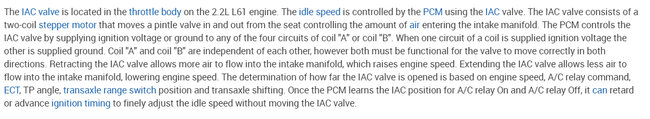

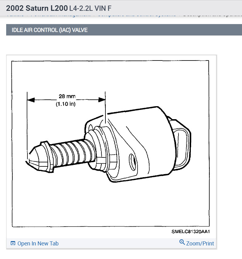

I have seen the IAC valve go out causing this issue. Here is a guide that may help as well:
https://www.2carpros.com/articles/engine-idles-too-high
I would service the throttle body and IAC valve.
