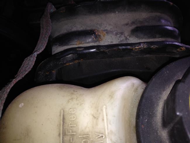

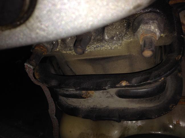

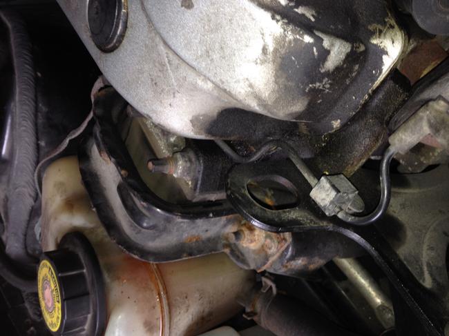

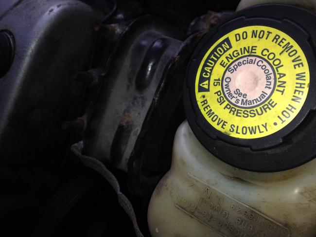

Dec 23, 2013 at 5:36 PM
SATURNTECH9
  • 30,869 POSTS
How did you check the mount ?Which style is it?the two styles each have a different way of ch3cling it.Post a pic of it.
Dec 23, 2013 at 8:06 PM
JONATHANBUSSEY
  • 14 POSTS
I posted 3 pics from each angle. Hopefully you can see them.
Thanks
Dec 25, 2013 at 7:26 PM
JONATHANBUSSEY
  • 14 POSTS
See attached.
Dec 25, 2013 at 7:33 PM
SATURNTECH9
  • 30,869 POSTS
The mount is shot its colapsed and torn replace it.
