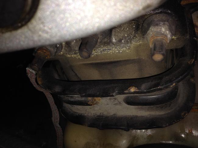

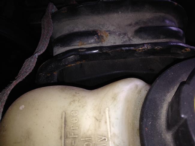

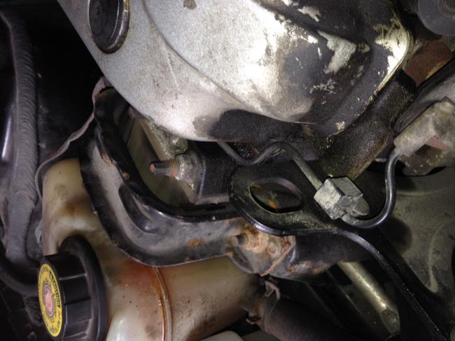

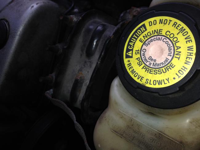

Dec 23, 2013 at 9:36 AM
SATURNTECH9
  • 30,869 POSTS
How did you check the mount ?Which style is it?the two styles each have a different way of ch3cling it.Post a pic of it.
Dec 23, 2013 at 12:06 PM
JONATHANBUSSEY
  • 14 POSTS
I posted 3 pics from each angle. Hopefully you can see them.
Thanks
Dec 25, 2013 at 11:26 AM
JONATHANBUSSEY
  • 14 POSTS
See attached.
Dec 25, 2013 at 11:33 AM
SATURNTECH9
  • 30,869 POSTS
The mount is shot its colapsed and torn replace it.
