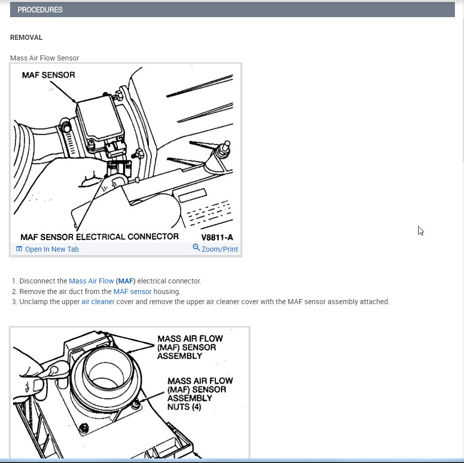

The vehicle was running fine until yesterday when I started it up and it was running rough. When I drive, it produces excessive exhaust and a fuel smell, and is weak on acceleration. I also smell fuel and/or burning smell, and see a little smoke under the hood after I open it after driving. I can't visually see any fuel leaks, and 2 weeks ago I replaced all spark plugs, plug wires, rotor cap, and fuel filter. Additionally there is no check engine light on. I'm not sure where to start checking for a solution.
Aug 11, 2019 at 12:26 AM

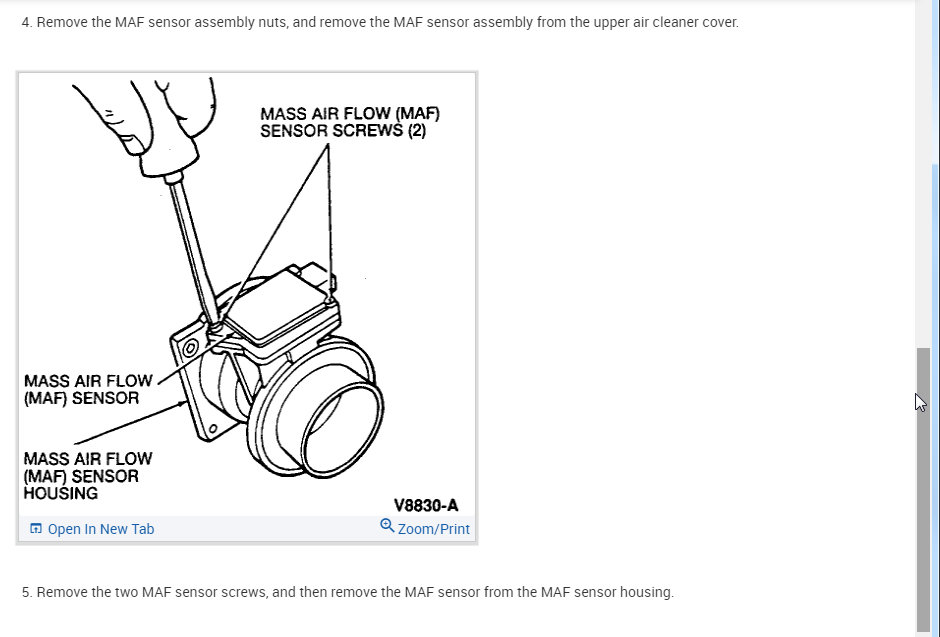

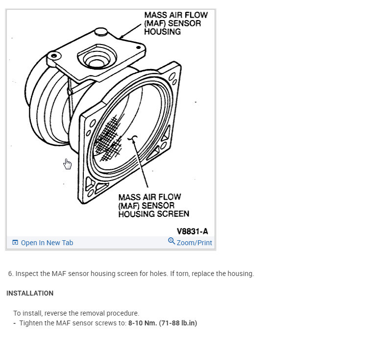

Assuming everything is okay with the spark plugs and wires (like one wire came off) then you have an issue possibly with the following issues.
Dirty or faulty Mass Air Flow (MAF) sensor.
Faulty oxygen sensor.
Leaky fuel injectors allowing too much fuel into the combustion cylinders.
Worn spark plugs.
Stuck fuel pressure regulator.
Faulty coolant temperature sensor.
Faulty coolant thermostat
https://www.2carpros.com/articles/how-to-replace-a-mass-air-flow-sensor-maf
https://www.2carpros.com/articles/how-to-test-an-oxygen-sensor-02-sensor
https://www.2carpros.com/articles/how-to-test-a-fuel-injector
The best way to figure this out is we need to monitor the short term fuel trim data with a scan tool. This will tell us that it is a rich condition which it seems obvious. Then you can look at the MAF voltage to see if it is reading properly. Also, o2 sensor data. Let me know if you have a scan tool that can read live data and I can walk you through what the numbers mean if you need me to. Thanks
