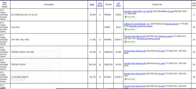

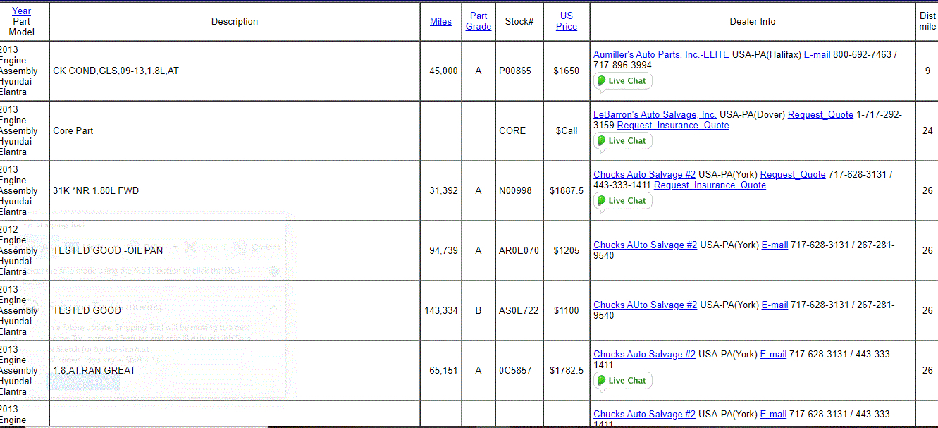

  • 52,797 POSTS
Good morning,
I found a lot of them for you.
Go to www. Car-part. Com. Enter your information and choose engine. You will need your production date off the door for the correct one.
I posted a page of them for you to view.

DANNY L
  • 5,648 POSTS
Hello again.
It looks like Roy found some for you that are close by. I'm in Southern California so most of my auto contacts are in the Los Angeles area. It would probably cost more to ship than it's worth. Hope this helps and thanks again for using 2CarPros.
