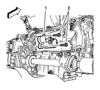

I drove the car normally to work. When I went back to go home, the car lights came on and dash lit up as normal and there was a single click noise and nothing else. I didn’t try to get it jumped due to the strength of the lighting. I attempted a few more times over the next day to start the car with no luck. Today the lights were very dim and the display said it was running on alternate battery. I tried to have it jumped with no luck. The dash showed 9.4 volts on the battery. I’m kind of stuck at this point. Any advice that doesn’t involve taking it to a shop? Budget is quite tight.

If the battery is fully charged, we have one of two issues. Since you hear the click, that tells me the starter is getting power. If that is the case, either the engine is locked up or the starter is bad.
Have you charged the battery? If you have, what I am going to suggest is to either remove the starter and have it bench tested at a parts store (they will do it for free) or take a breaker bar and socket and place it on the crankshaft pulley bolt and see if you can turn the engine.
If you decide to have the starter tested, here are the directions for removing and replacing it. The attached pics correlate with the directions. Make sure to disconnect the battery before starting this procedure.

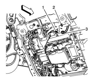

2015 Malibu 2.5L
Starter Replacement
Removal Procedure
Disconnect the battery negative cable
Raise and support the vehicle
Disconnect the engine harness connector number 3 from the starter solenoid
Pic 1
Remove the battery positive caable fastener (number 2) and remove the battery positive cable terminal (number 1) from the starter motor solenoid.
Remove the mounting fasteners and remove the starter.
pic 2

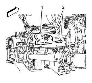

Install
Caution: Refer to the Fastener Caution
Install the starter and torque the top fastener to 16 Ft Lbs and then the bottom fasteners to the same torque.
pic 3
