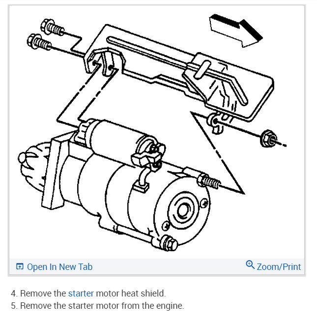

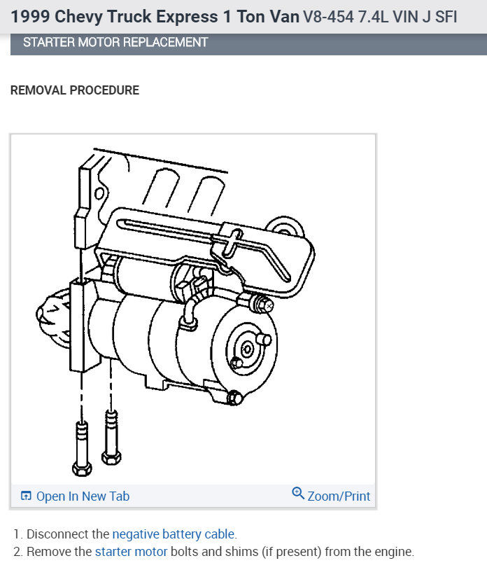

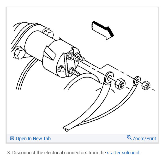

If the starter is bad this guide will walk you through the repair with diagrams below to show you on your car:
