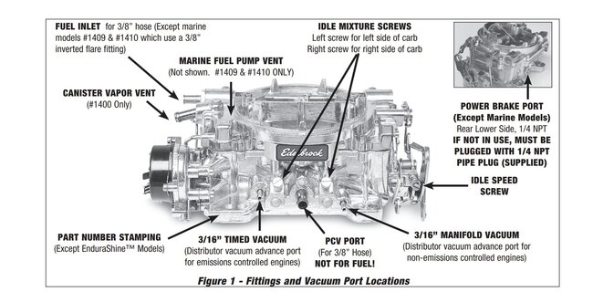

Engine is not original to truck. Block shows it could be anything from a truck to a Chevelle from 72-74. Ring rebuilt it and put on new Carb (Edelbrock 1405) and new Distributor (Accel 59130). Compression stands at 120. Adjusted floats and there was fuel in the bowls. Pins moved fine and like I said, spark plugs will get wet. If I turn it enough it will start to hydro lock with fuel. Spark plugs are firing (tested with spark plug tester). Before putting on a new distributor, had a point system and got it running poorly and very, very rich. Reading after the fact makes me think I should've gone with 500 cfm instead of 600.

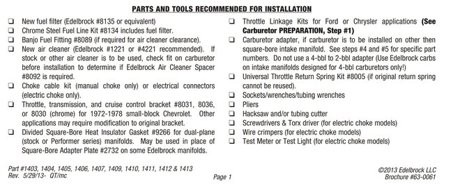

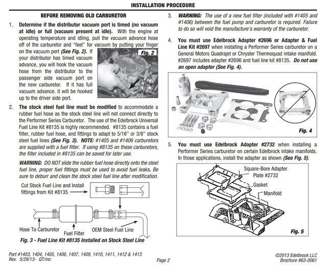

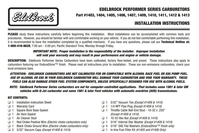

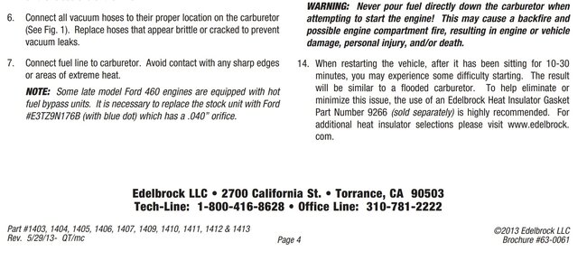

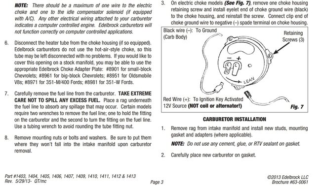

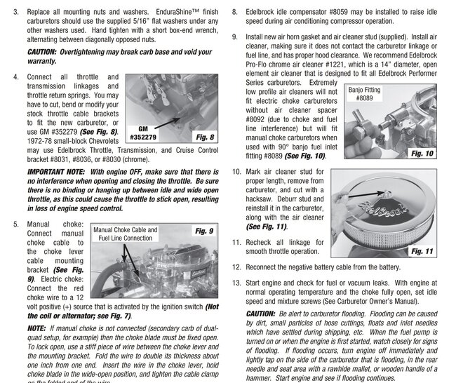

I am sending images of the instructions for the carburetor. Hopefully it will help. I would start over personally to make sure everything is where it needs to be.

Also, the directions from Edelbrock aren't very informative either.

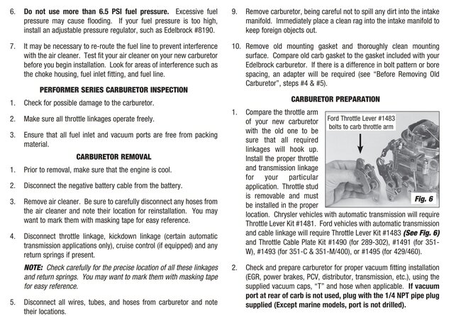

I did find this in the Edelbrock documentation, they are saying to try to keep fuel pressure to below 6. The stock fuel pump is between 6 and 8 PSI, isn't it?

My tech info doesn't give me info on that, and I don't want to pull something offline and give you the wrong information. I would take the fuel line off at the carburetor and put a T-fitting on and thread on a gauge and reconnect it and see what you're at. Does it have an old school manual fuel pump on the passenger side of the motor?
If so, you will have to crank it but if there is an electric one you can just prime it and see where it is at.
