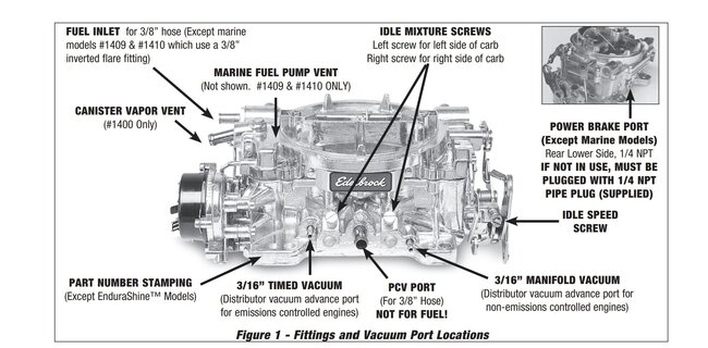

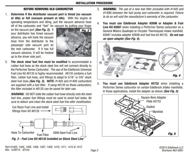

I am sending images of the instructions for the carburetor. Hopefully it will help. I would start over personally to make sure everything is where it needs to be.
I would check all vacuum lines and make sure you have caps on any unused port. I know this is obvious, but I just want to give you the best information possible.

The instructions are kind of broken up and I apologize. I have to upload snippets because PDF versions aren't aloud.
