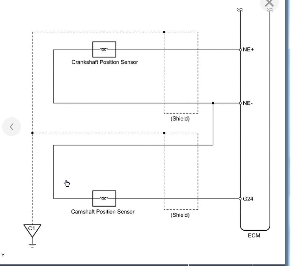

So if you found the relay was shorted against the ignition system and now we have a no start, I am going to assume we have an ignition system issue.
Lets confirm this by pulling a spark plug and connecting it back to the ignition system then hold it against the block and crank the engine. If there is no spark then we need check the ignition relay.

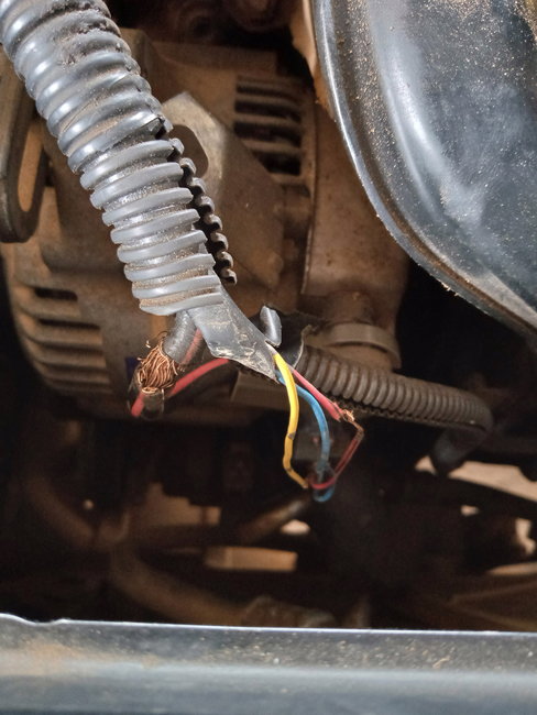

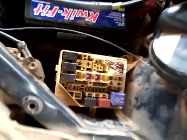

I checked fuse box in the engine compartment all looks good, the small fuse box connected to the positive terminal of the battery is also good .
Yes, there is damage on one of the spark wires that distribute to spark plugs, where the relay and fan were connected the white cable looks brown now. I will add pictures in the morning.
Apr 2, 2020 at 5:30 AM

This was the condition when the short circuit happened.
Apr 2, 2020 at 8:22 PM
VABBIED
  • 15 POSTS

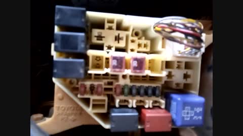

After checking and cleaning the blown fuses the dash came up, this is now.
Apr 2, 2020 at 8:32 PM

Please clarify something for me. I did watch the video and at one point you are holding a heavy gauge wire. It appears to be attached (exposed connection) to a much smaller red wire. Is that correct?
Apr 3, 2020 at 10:39 AM
VABBIED
  • 15 POSTS
Yes, that the black/red stripe cable attached to the alternator and the other small 3 cables connect to the sensor near the alternator. heavy gauge wire. It appears to be attached (exposed connection) to a much smaller red wire. Thus where the radiator fan and relay was connected and caused a short circuit, and from the relay another cable was attached to the cylinder heard.

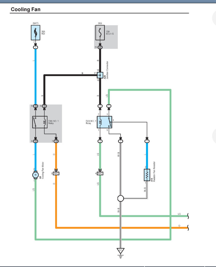

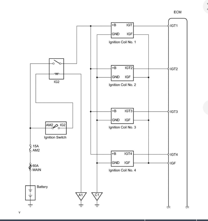

Okay. Just to jump back in, that is not the proper way that is to be wired. I am not sure you are saying this but if the fan is wired to the large gauge wire from the alternator, then that is why the relay is failing. That is far too much current for the fans.
I attached the diagram for a 2006 Yaris (as we don't have a diagram for your year) of the cooling fans. You should not have any other splices or even exposed wiring.
Any that you have needs to be repaired and remove any splices that are not supposed to be there.
