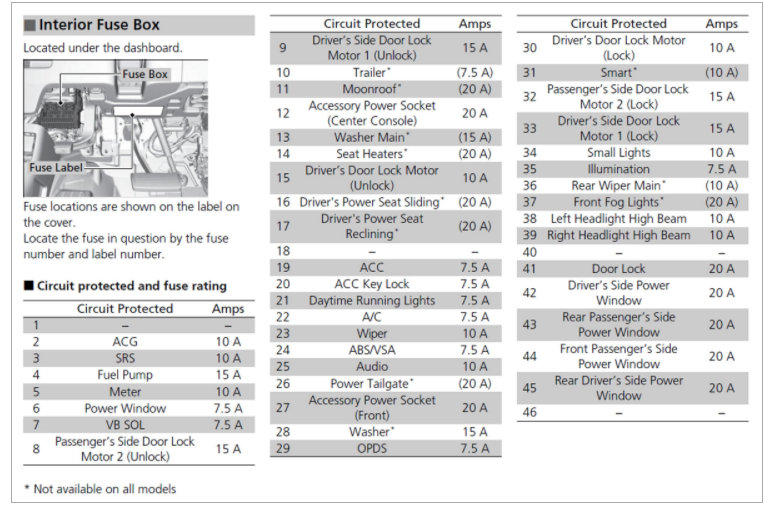

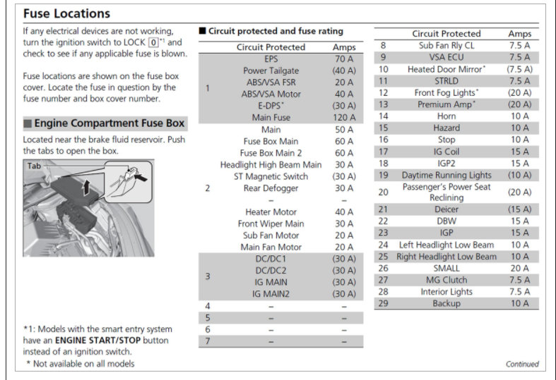

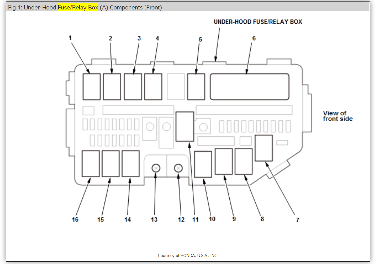

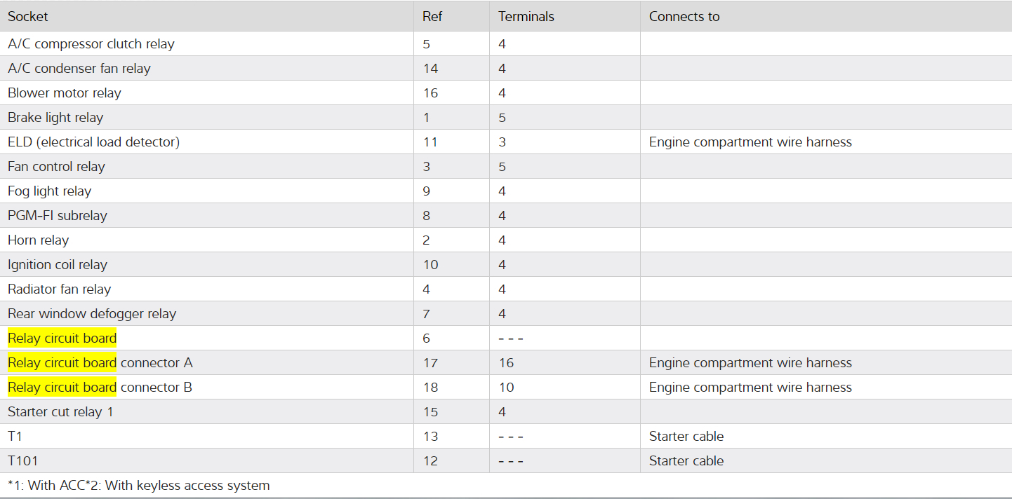

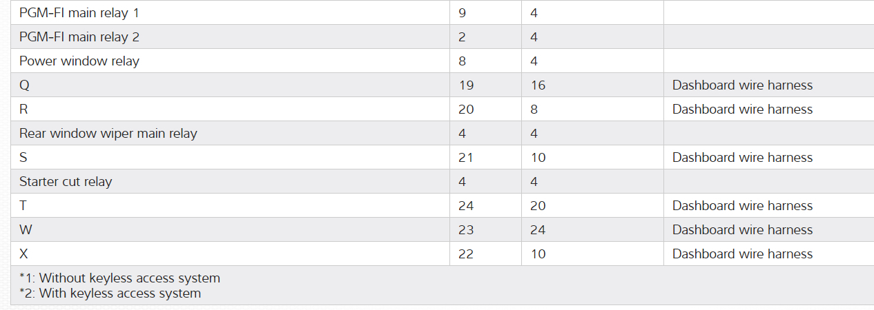

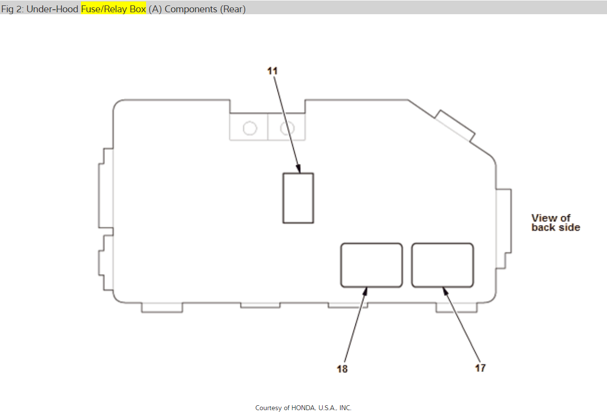

When you say the fuse is good did you check to see if the fuse has power? Here is a guide to help us find out. Did you check the 7.5 amp #24?
Here is the fuse location as well.

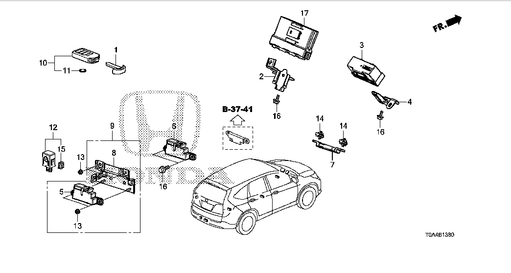

Thanks Ken. About an hour after posting this question I began verifying all fuses had good connectivity using a multi-meter (both in engine compartment and under drivers side dash). I then visually inspected all visible wires under dash on drivers side and moved to passengers side under dash and found a wire going into the power assembly unit that appears to have been improperly had a 8 ga. wire spliced into the 20 ga. using a heat wrap that had separated. I spent $0.30 for some 20 ga. wire and connected it up and resolved the problem. Thanks again for your time.

Good to hear, please use 2CarPros anytime we are here to help. Which power assembly was it?
Apr 9, 2018 at 9:01 AM
JSUTFIN
Sorry mistyped. 38329-T0A-A11.
Apr 10, 2018 at 3:36 AM
  • 55,433 POSTS

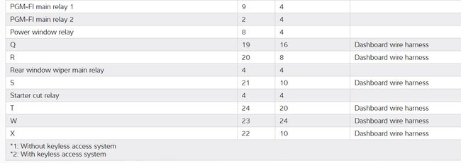

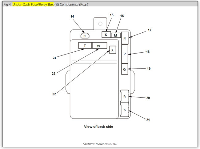

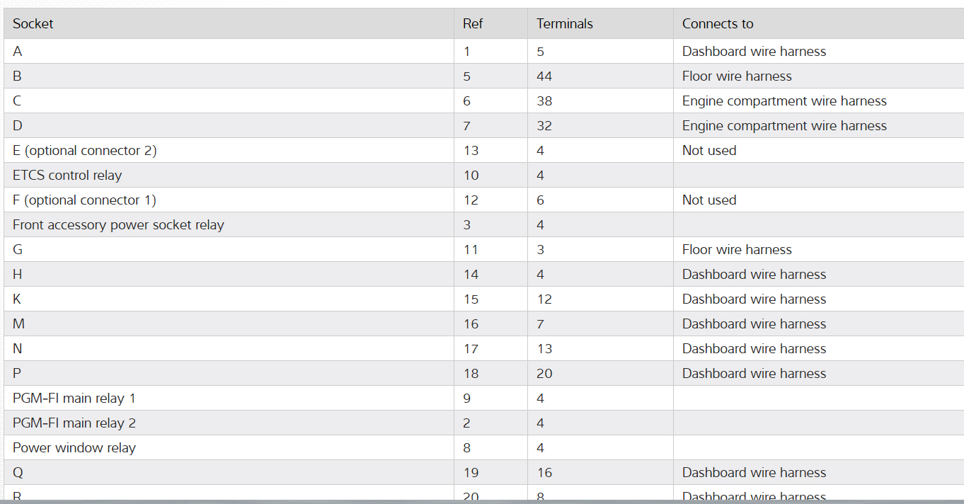

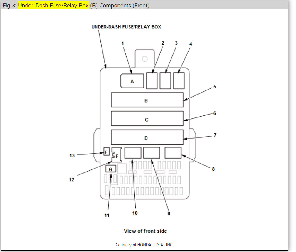

Okay thanks. Here is what they come up with can you tell us which part? It will really help the next guy.
Apr 10, 2018 at 10:44 AM
JSUTFIN
Yeah, it was a thin red wire going into #17 on that picture.
