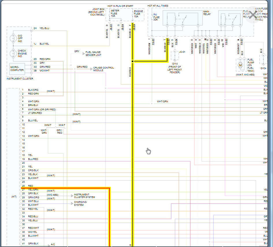

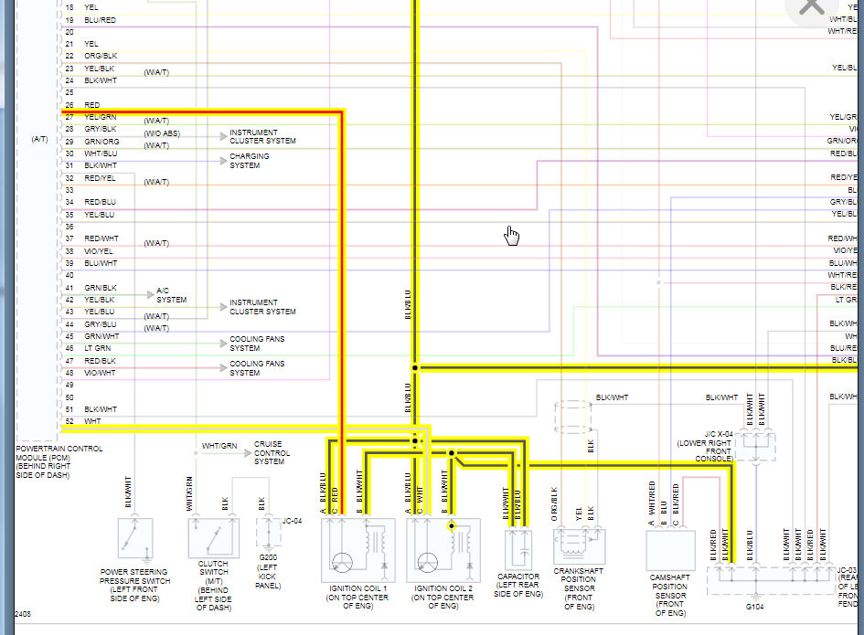

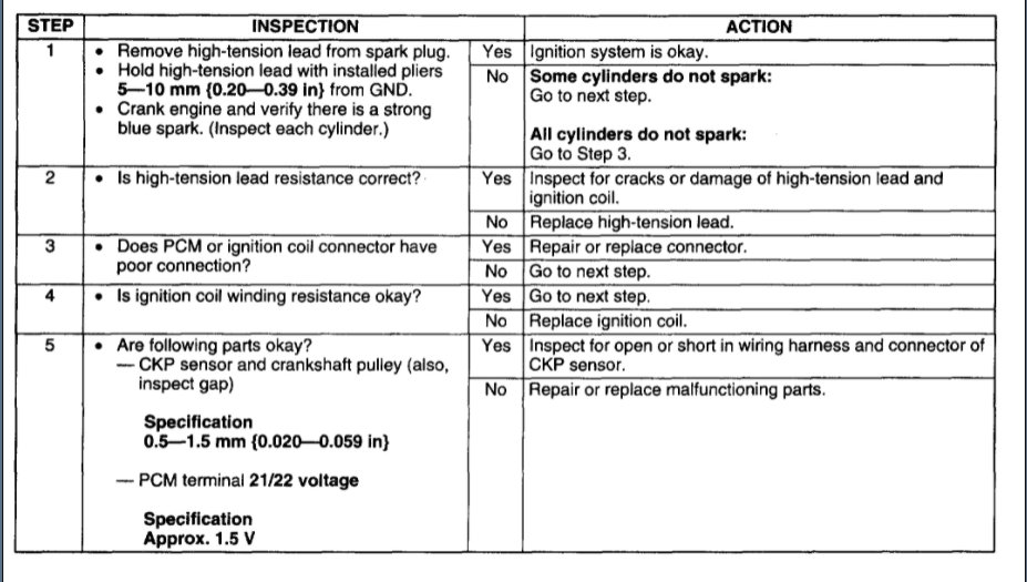

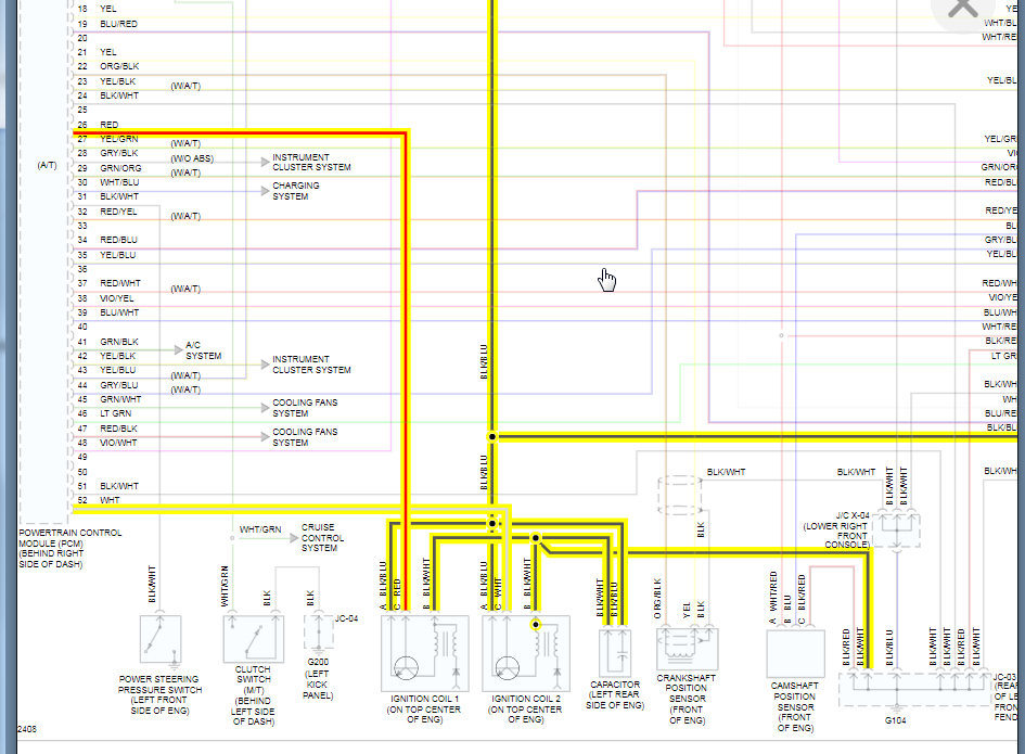

What can cause no spark at the spark plugs? The cam and sensors are new.
Thursday, April 29th, 2021 AT 4:44 AM
MECHANIC
18,907 POSTS
There are a number of things but we need to run through this testing and wiring diagram. Basically we need to find out if the coils are getting power.
Please run through this below and let us know what you find and we can go from there. Thanks
