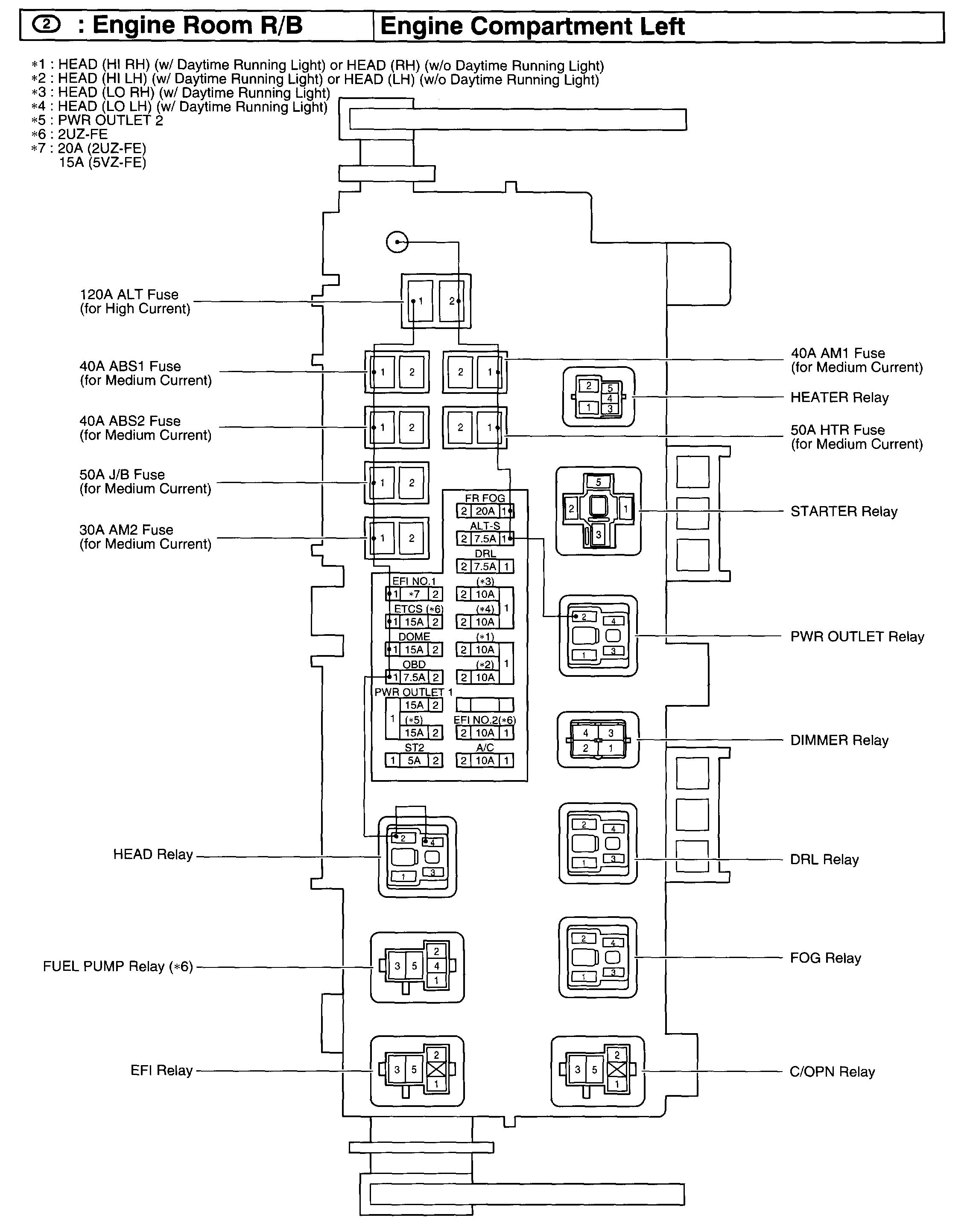

Engine turns over will not start. Suspect fuel pump relay or fuel pump. Where is relay located?

It is in the engine compartment relay box. See picture.
Image (Click to make bigger)
