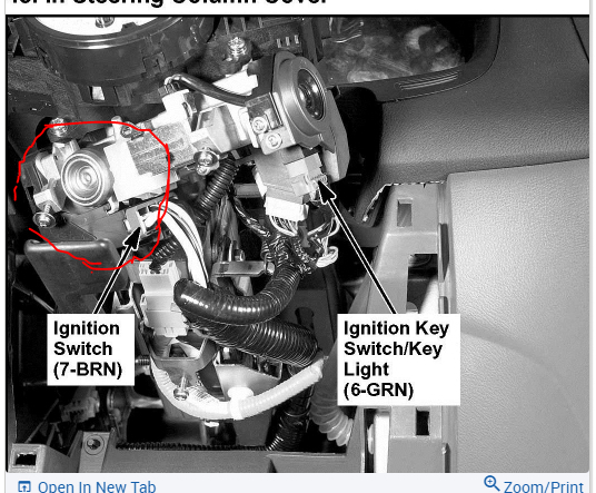

I've replaced the ignition switch because it was causing the starter relay to quickly open and shut repeatedly giving a rapid clicking noise that sounded more like a grind (came from the lower left footwell next to the relay itself). There's no clicking coming from the starter. The car just remains completely silent. Accessories turn on, engine doesn't crank, no clicking, no grinding, it's just completely silent. The starter doesn't even attempt to engage.
Update: I got up this morning to try and start it, it did crank but only after 15 seconds of holding it in the crank position. My car specifically and probably other models too, have a part labeled Ignition Switch, which doesn't actually come into contact with the key, it's on the other side of the steering wheel and was causing the buzzing. Could it be the actual lock cylinder?

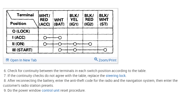

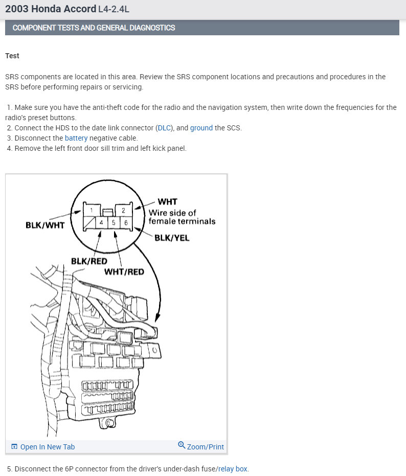

Are you talking about the component circled in red?
That is the actual electrical component of the ignition switch.
Can you tell if that part gets hot to the touch?
If it is buzzing while you are unable to start it and it is getting hot. Which can mean an internal failure and causing this to have too much internal resistance.

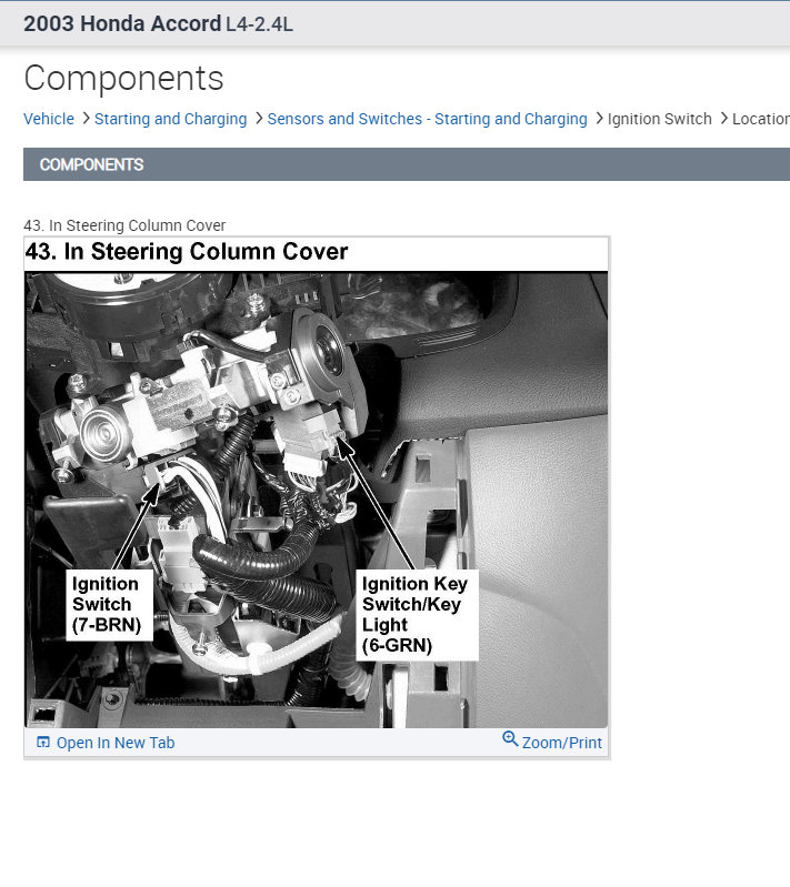

No, i had replaced that part. It was replaced by Honda as it had been recalled and was causing the starter relay in the footwell to spam open and shut causing a loud and unpleasant buzzing, usually leading to the car not starting, but occasionally it would also not make a buzz and still not start. I assumed they were the same problem and found the ignition switch was the culprit so i replaced it. It fixed the buzzing, but it did not fix the problem of just staying completely silent.
I'm talking about the entire lock cylinder assembly, the portion where the key goes into.
I'm trying to figure out whether it is something in the starter or starter solenoid, or if the cold is causing some wires or plates or whatever the lock cylinder shorts to send power to the starter that shrinks slightly in the cold and cannot come into contact with the part it's supposed to be shorting.

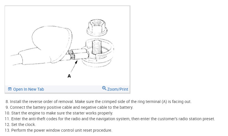

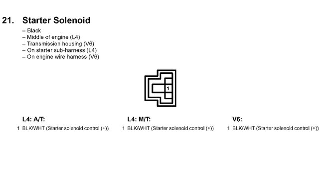

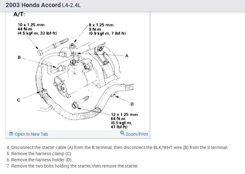

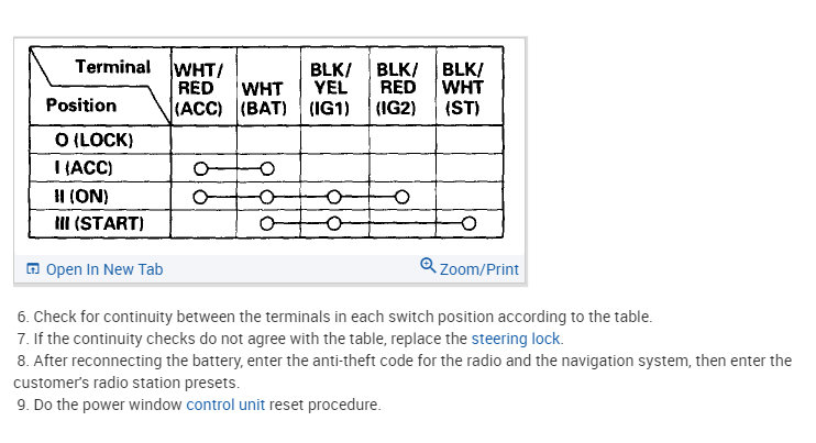

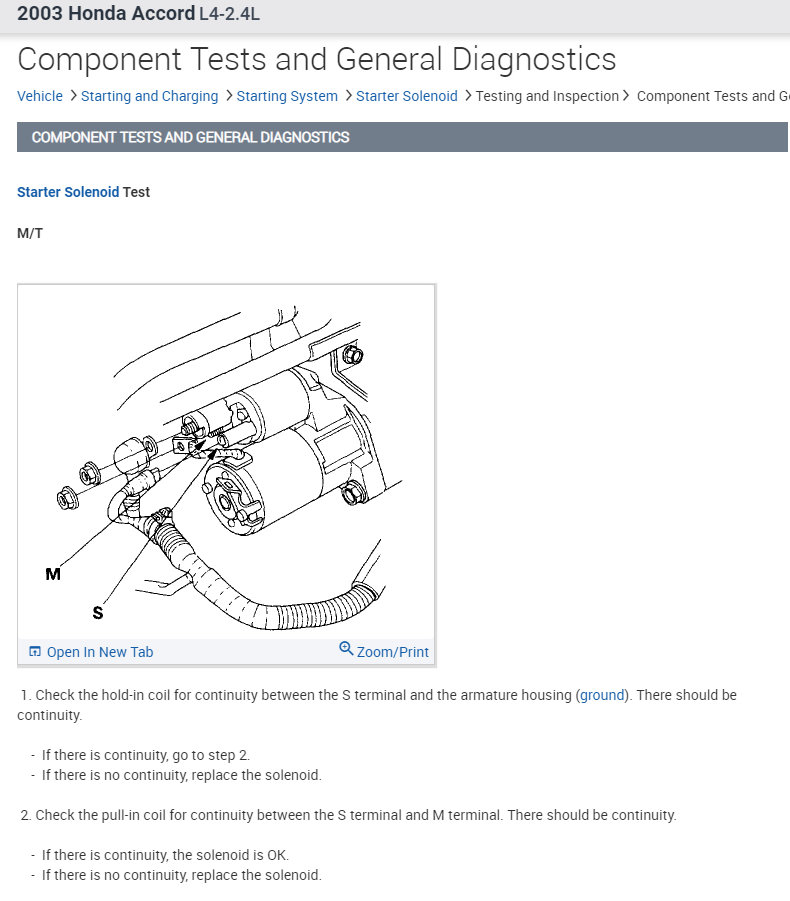

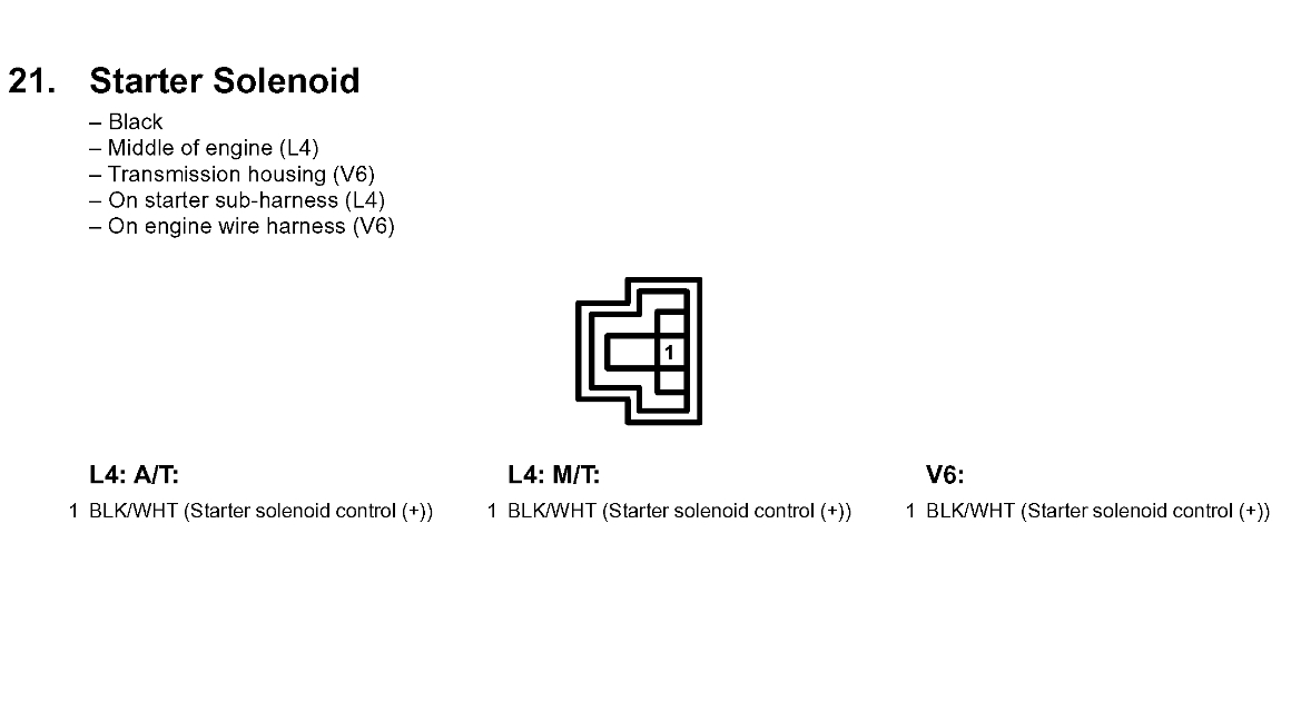

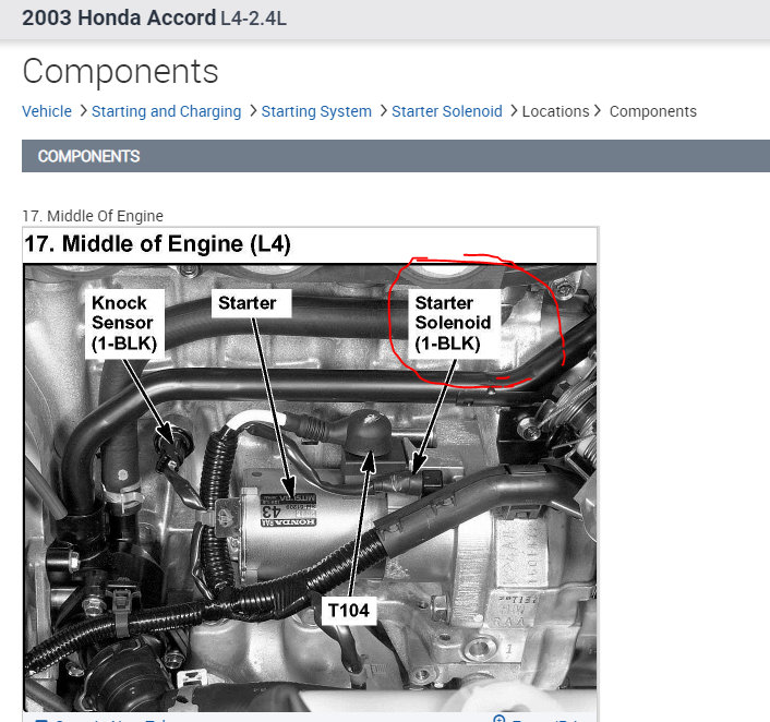

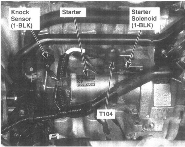

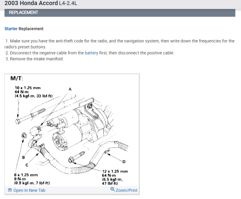

One thing you can try is check the starter solenoid. I wonder if that is acting out when the temperature is low.
I have attached the diagrams and test process for the solenoid below.
