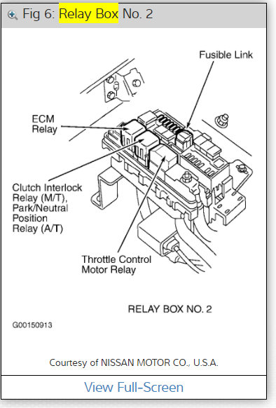

Engine will not crank
166,000 MILES • 3.5L • V6 • 4WD • AUTOMATIC
SPLITWINDOW
Location of starter relay.
Mar 5, 2018 at 8:40 PM
  • 55,710 POSTS

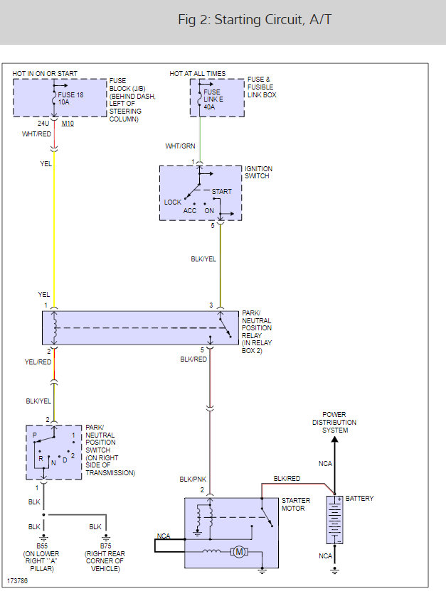

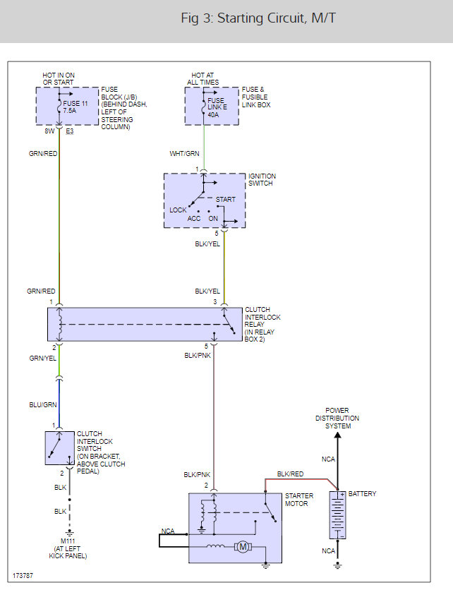

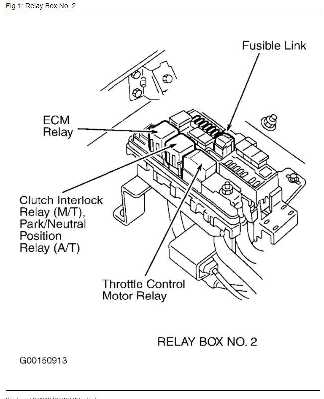

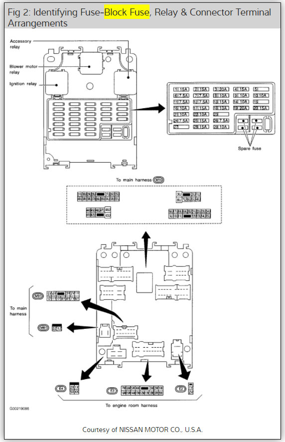

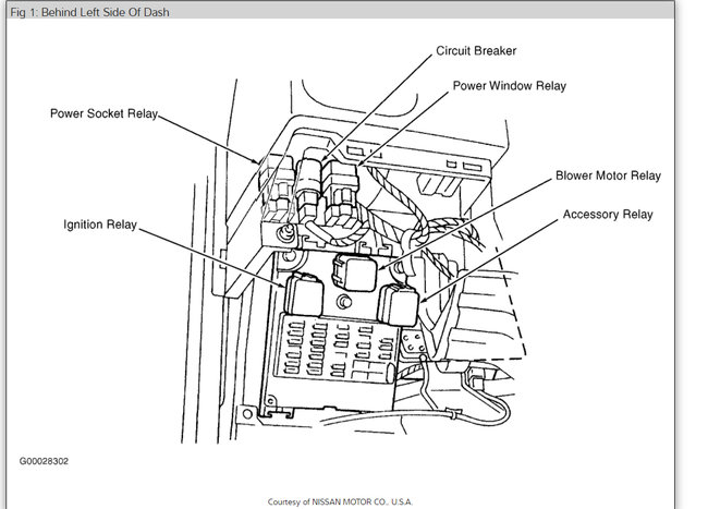

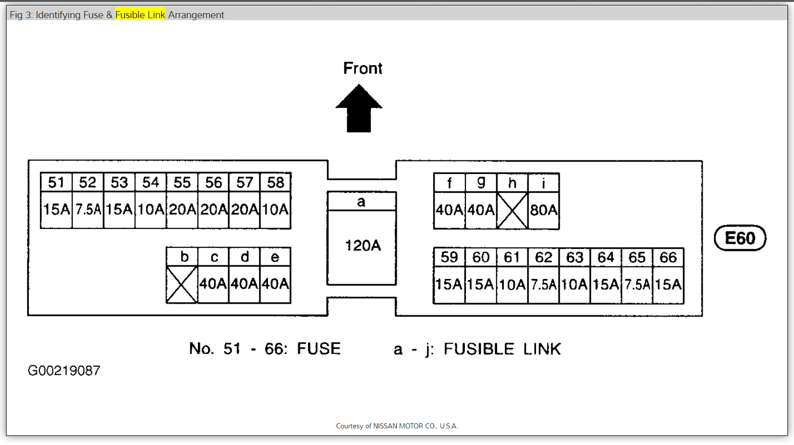

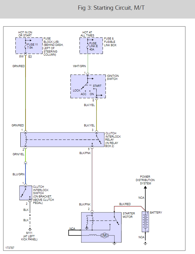

The starter relay is called a park neutral position relay. Here is a guide to help you test the relay once you find it:

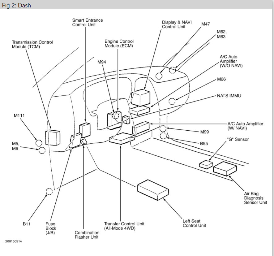

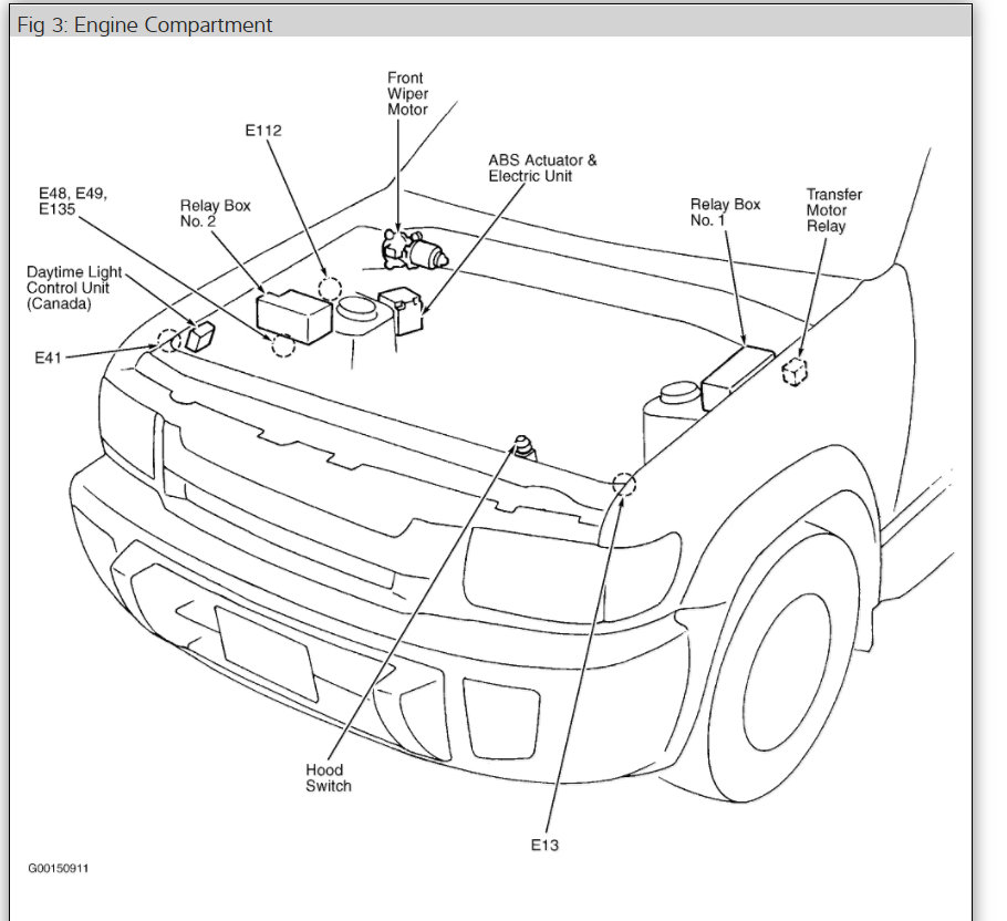

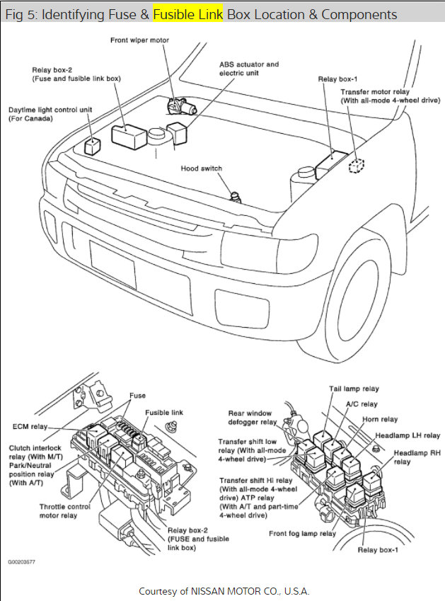

Below are the fuse panel and relay locations for the entire truck keep this page in your favorites for future reference. I includes the wiring for the starter as well.
Mar 7, 2018 at 5:55 AM
PATENTED_REPAIR_PRO
  • 1,853 POSTS
In relay box 2.
