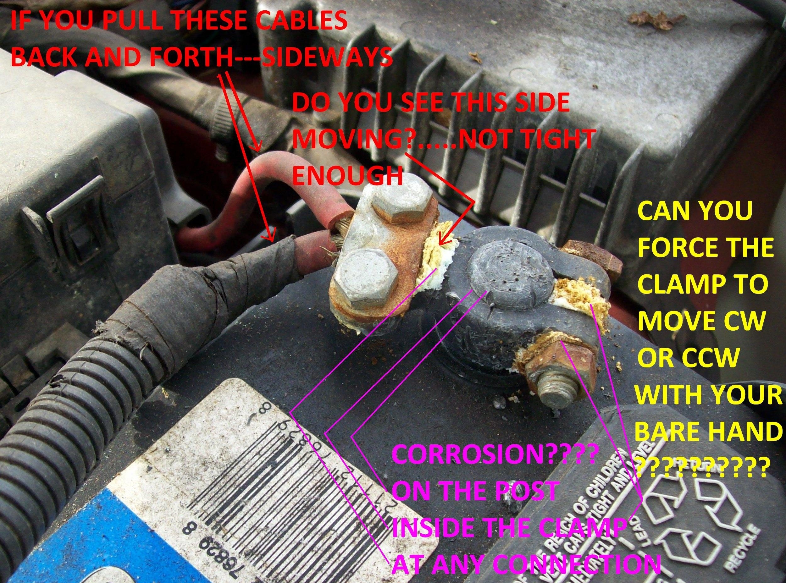

I recently replaced the batteries and terminals on my truck and now it will not crank or turn over.

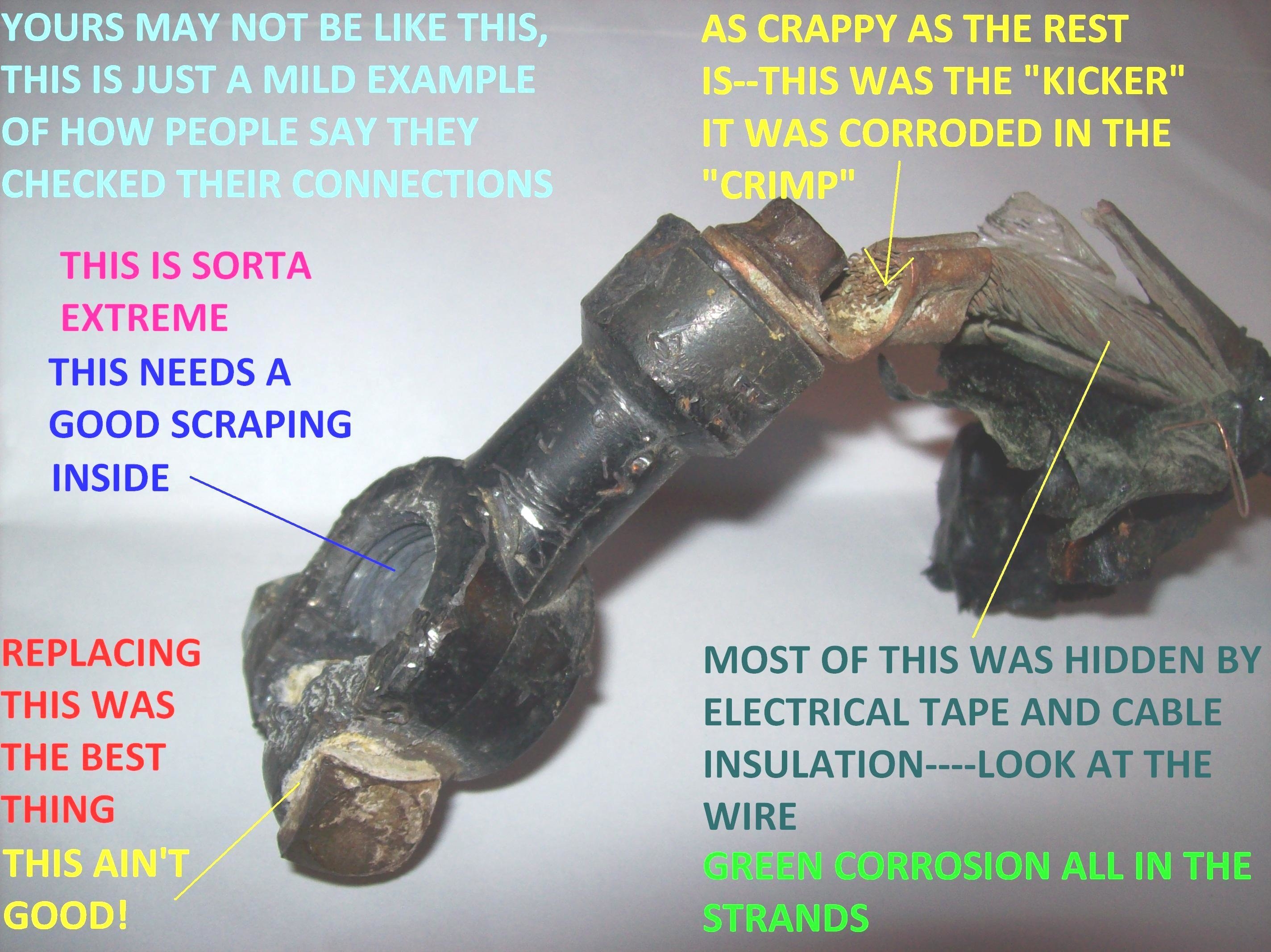

Okay, lets do the basics first before we throw blame elsewhere.
Grab your battery clamps on the battery posts, can you forcibly twist, pull, make it move the clamp on of the battery using your hand?

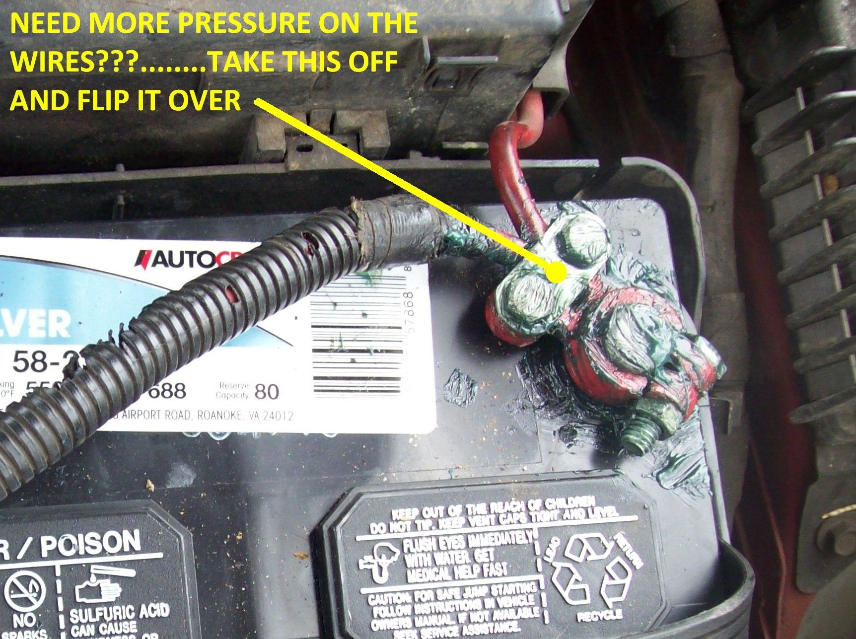

If you have aftermarket (regular ole) clamps whereas a two hole strap holds the cable to the clamp. Let's "left and right" the cable forcibly. Does the copper on the other side of the strap move? (it should not!)
Your starter solenoid (now days called a starter relay) body should be bolted on to a good clean ground (fender).
Now for the good part, I always try to shorten this but get the message through.
Clean the battery posts and inside of the battery clamps. Tap them way down on the battery posts. Tighten well (your clamp should still have a gap when you are done, not the clamp ends touching and the bolt will go no further). (This depends on the type clamp you have). Again, you should not be able to bare-handed-ly move a battery clamp on a battery terminal!
Now follow the positive and negative cables from the battery and the cable from the starter. When you find their destinations, check the tightness there.
Clean (or at least loosen and scooch the ends around) the cable ends and the posts they connect to. (both sides of the solenoid, the starter connection (these all being the hot cables) and check the ground from the negative battery cable. Tighten everything well.
Many folks halfheartedly do these things, they will touch the items with their hands but never actually get in there and wrench on them!
Here is a link from our site (repair guides-top right of our pages):
Here are some pictures I made.
Keep us posted on progress,
The Medic
