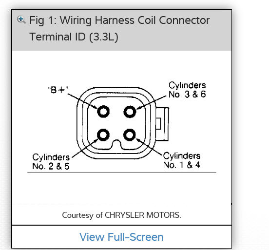

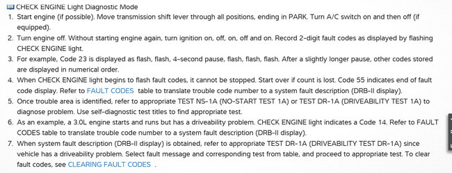

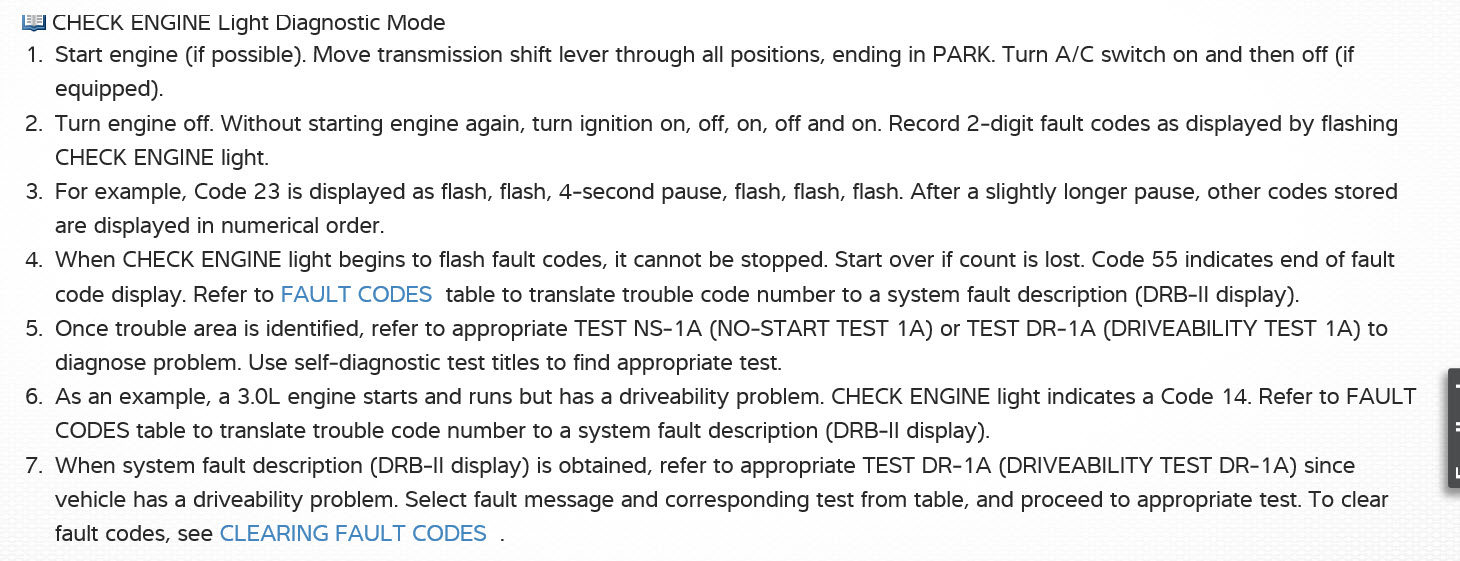

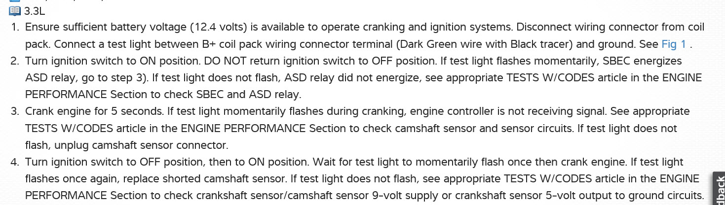

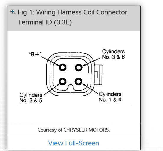

I'm troubleshooting a 92' voyager with a V6. It cranks, but will not start. No spark so checked the coil and no power to the coil or injectors. Wiring harness looks fine and the crank sensor has been replaced. All the grounds and battery connections have been cleaned. Would like some advice on what to check next. Thanks in advance for your help!

check asd relay first under hood then run a diagnostic check this is for a 3.3V6
