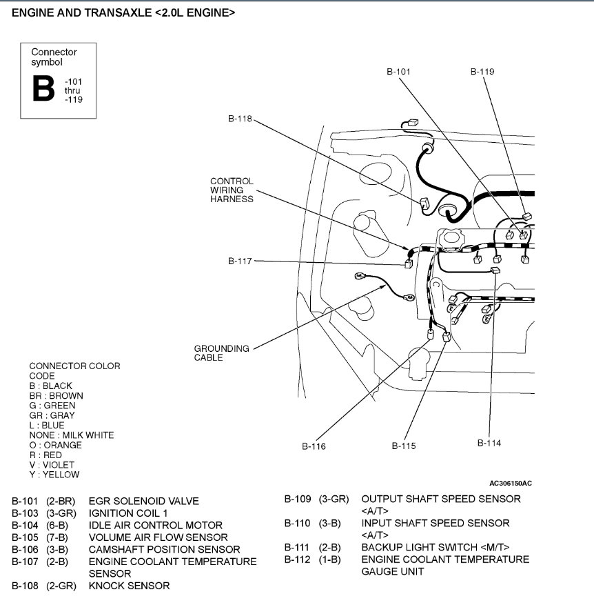

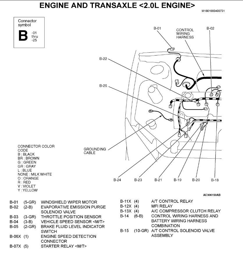

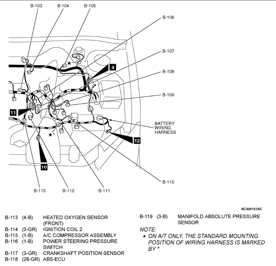

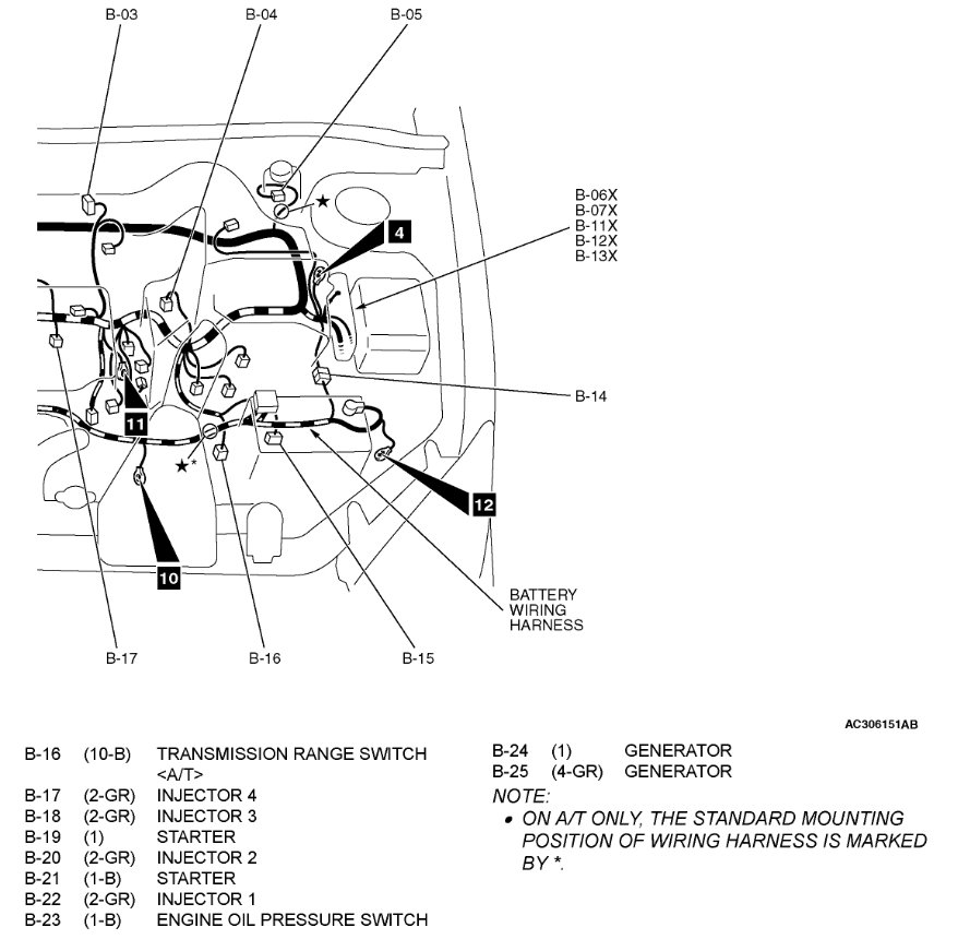

My friend was recently given the car and a buddy installed a used motor in it and they left some plugs unplugged and we can't find where they put into can anybody help with a pic or schematic of the engine harness? please

I have attached the diagrams showing the location of each engine wire harness connectors.
Please let me know if you have
any questions.

Thank you very much this is very helpful.
