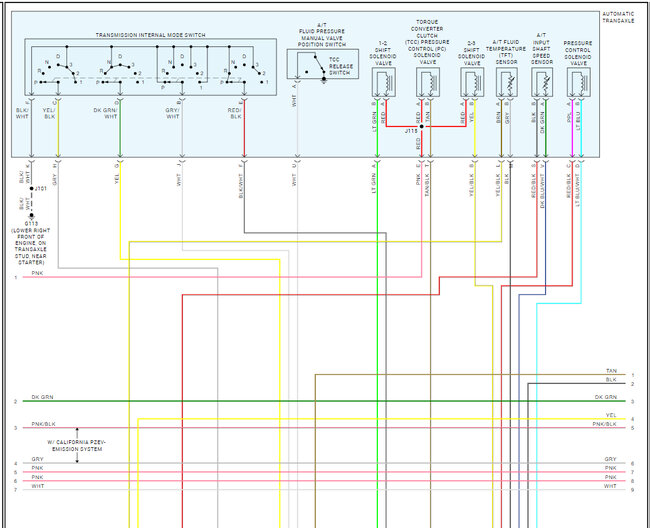

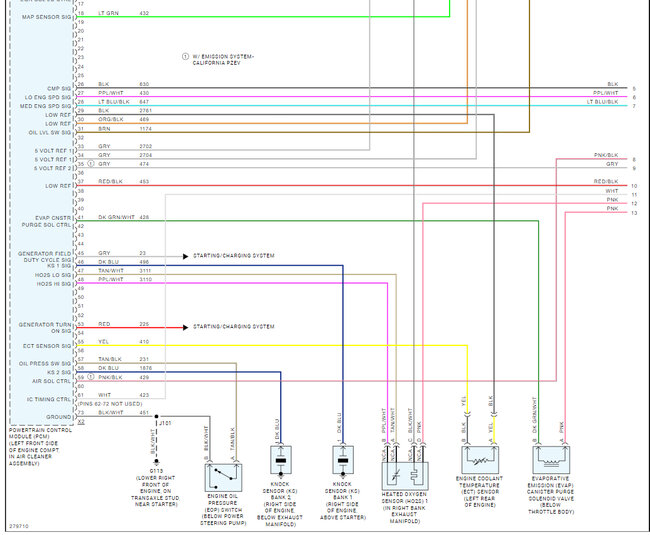

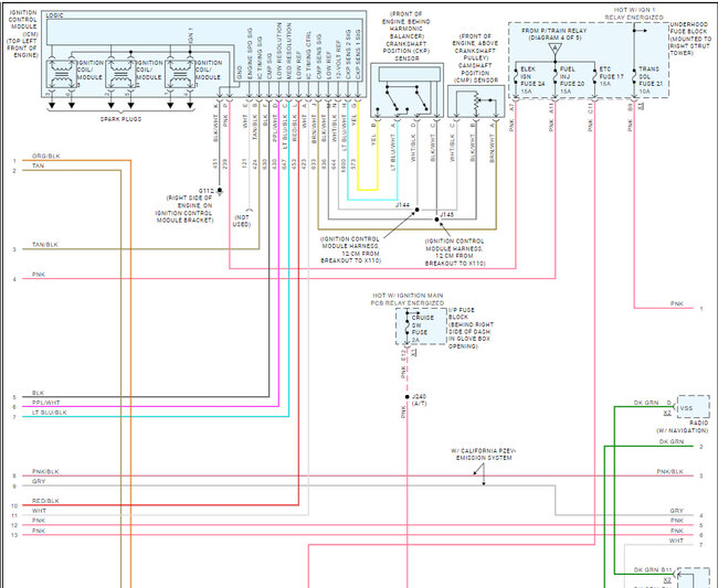

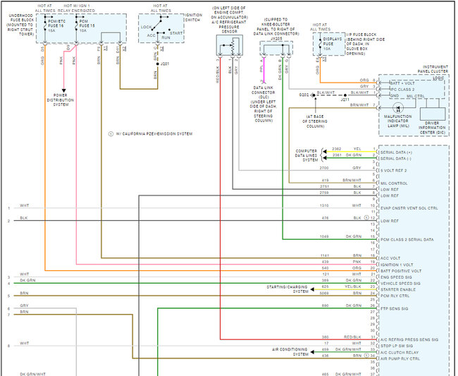

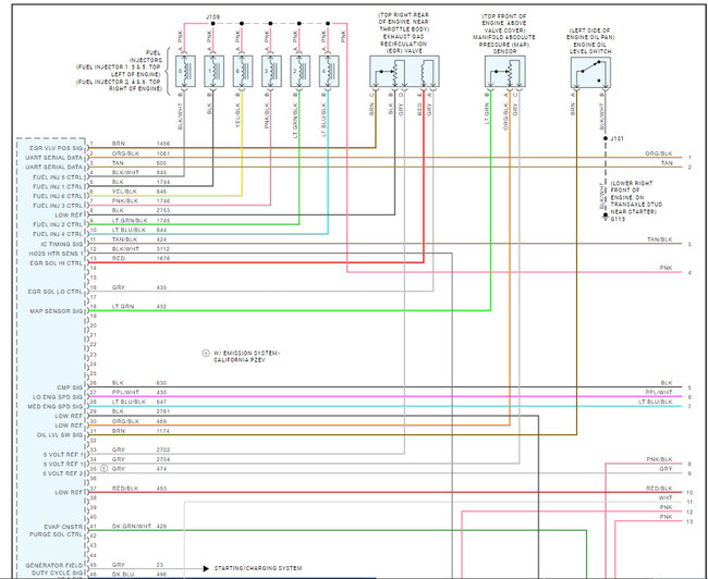

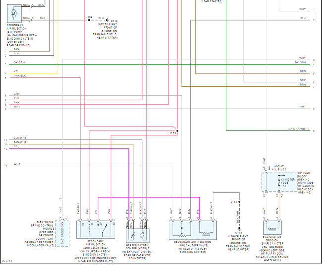

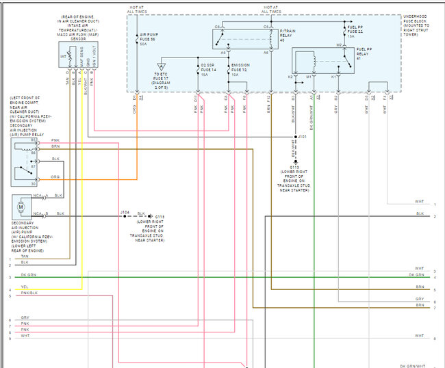

Engine wiring harness a mouse chewed through it, can I get the powertrain management wiring diagram?
160,000 MILES • 3.8L • V6 • 2WD • AUTOMATIC
GARRISONRMARK
A mouse chewed through the harness, so I have to rebuild the one I have but can't find the powertrain management wiring schematic anywhere... Any help would be greatly appreciated!
Sep 12, 2024 at 10:37 PM
  • 55,694 POSTS

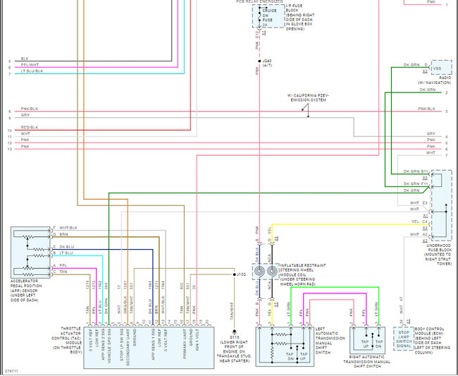

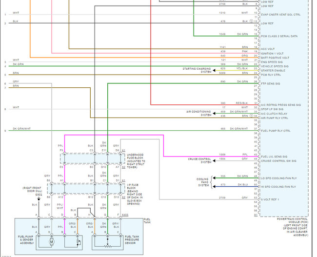

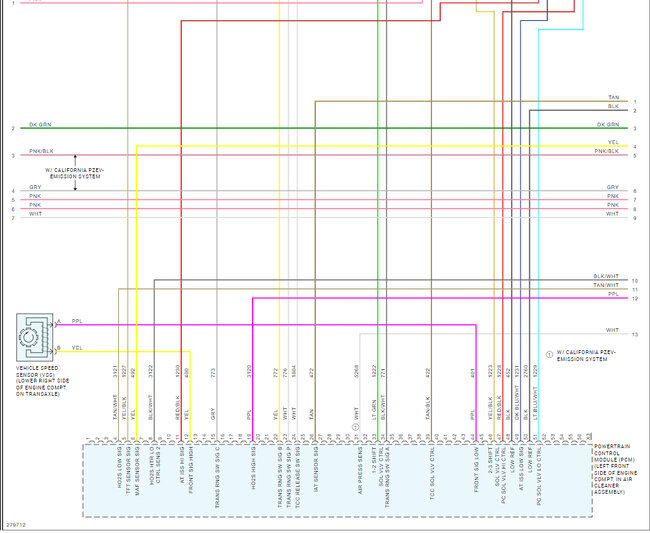

lol those critters! Here is a guide to help you with the testing for the connections and I have included the engine wiring diagrams in the images below.
Check out the images (below). Let us know if you need anything else.
