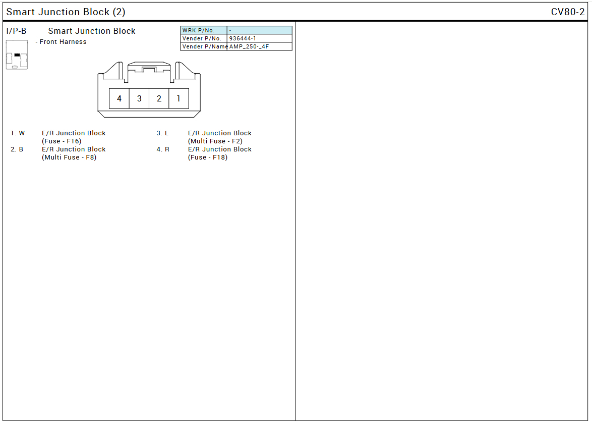

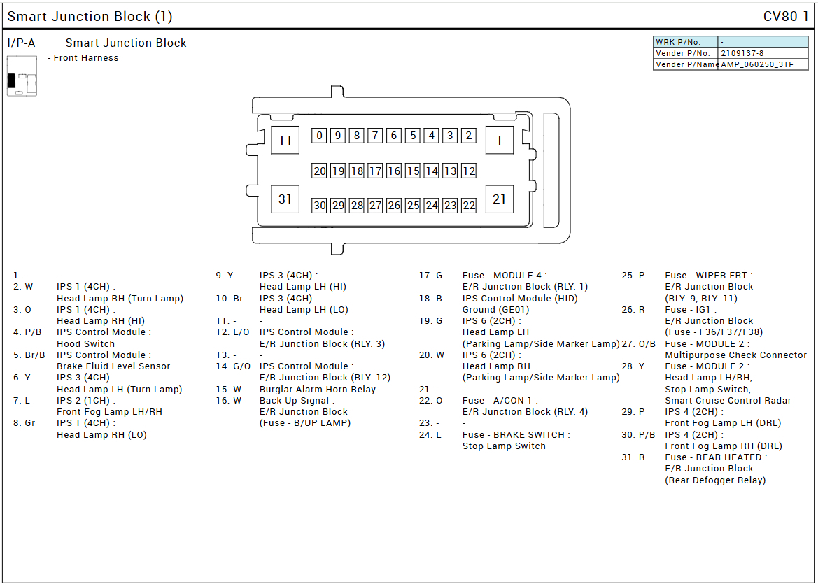

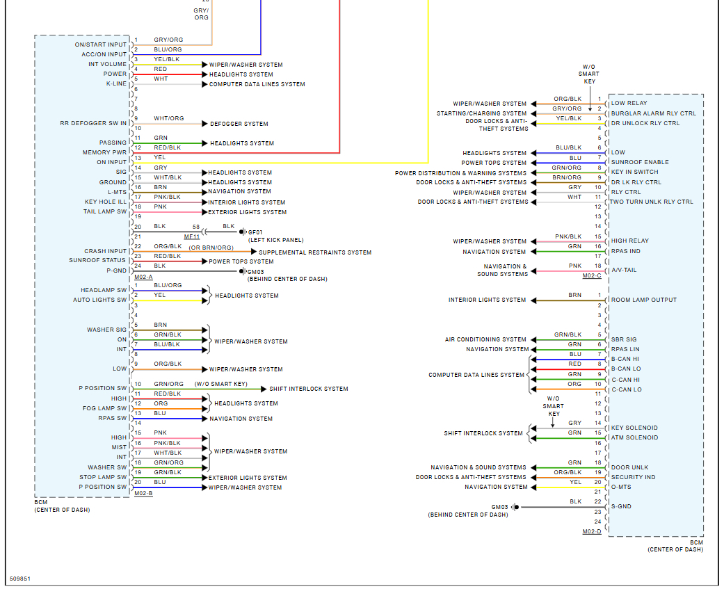

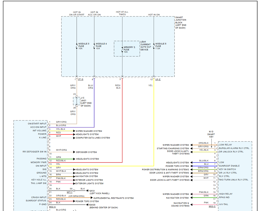

Car caught fire, so I bought a complete wiring from a junk yard, and it was badly cut, so if I can have this diagrams it will guide me to restore.
I appreciate all efforts by 2Carpros
SANTA FE SPORT / 2017/HYUN
5XYZTDLB4HG391081
Jun 24, 2025 at 10:11 AM
  • 54,837 POSTS
Sure, here is a guide to help with the testing and the CAN bus wiring system which shows the grounds.
Check out the images (below). Let us know if you need anything else.

May I also have the fuse box diagram and the ECU pin out diagrams.
Jun 26, 2025 at 3:34 AM
ANDRIN ATEM
  • 406 POSTS

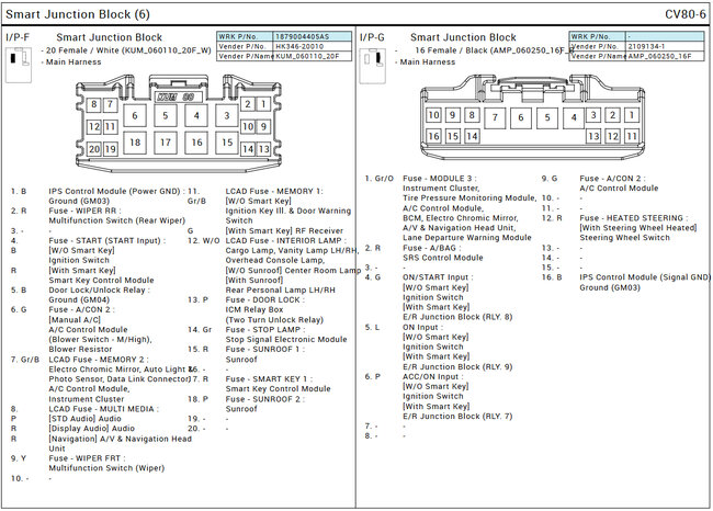

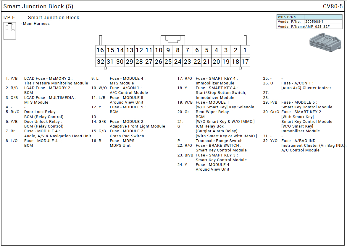

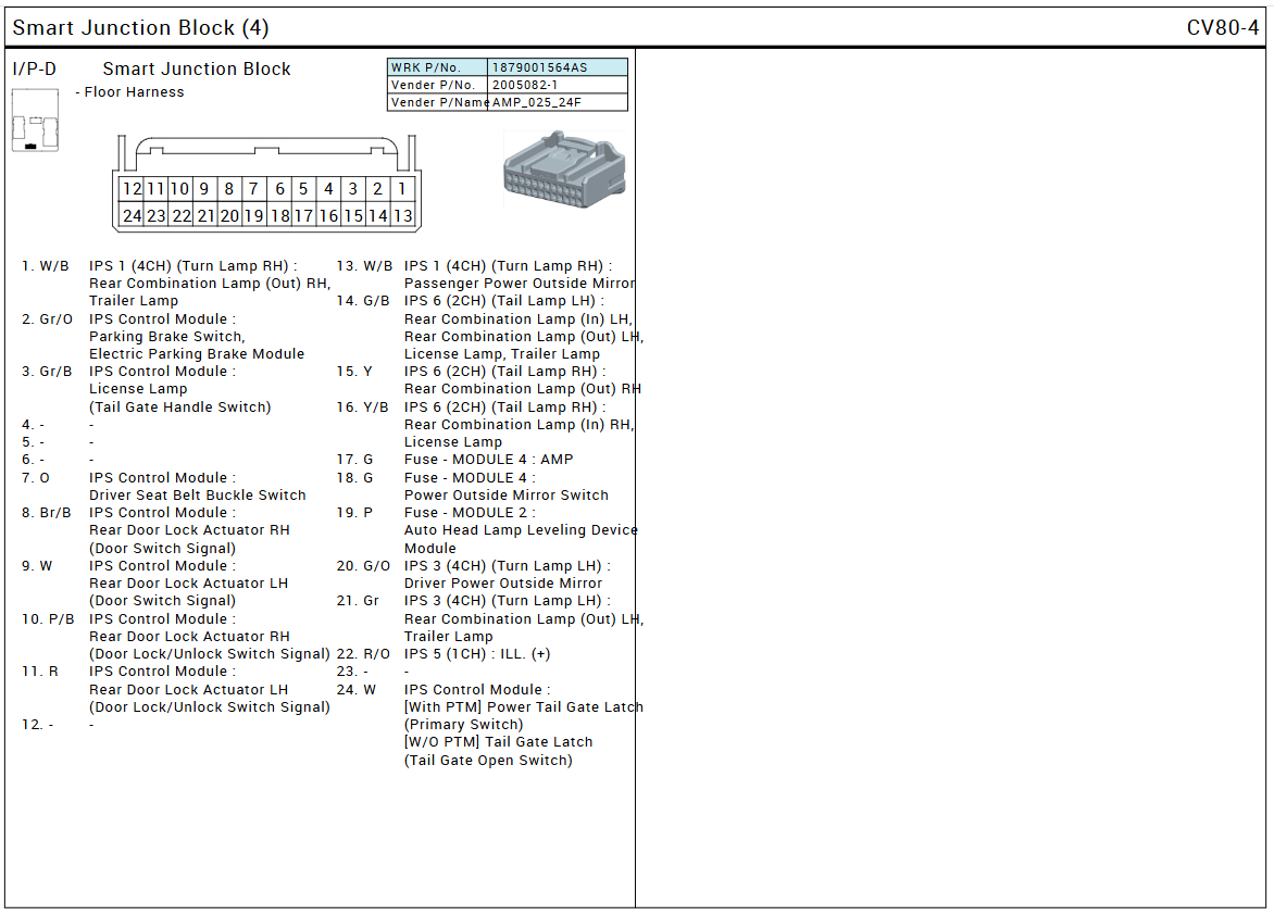

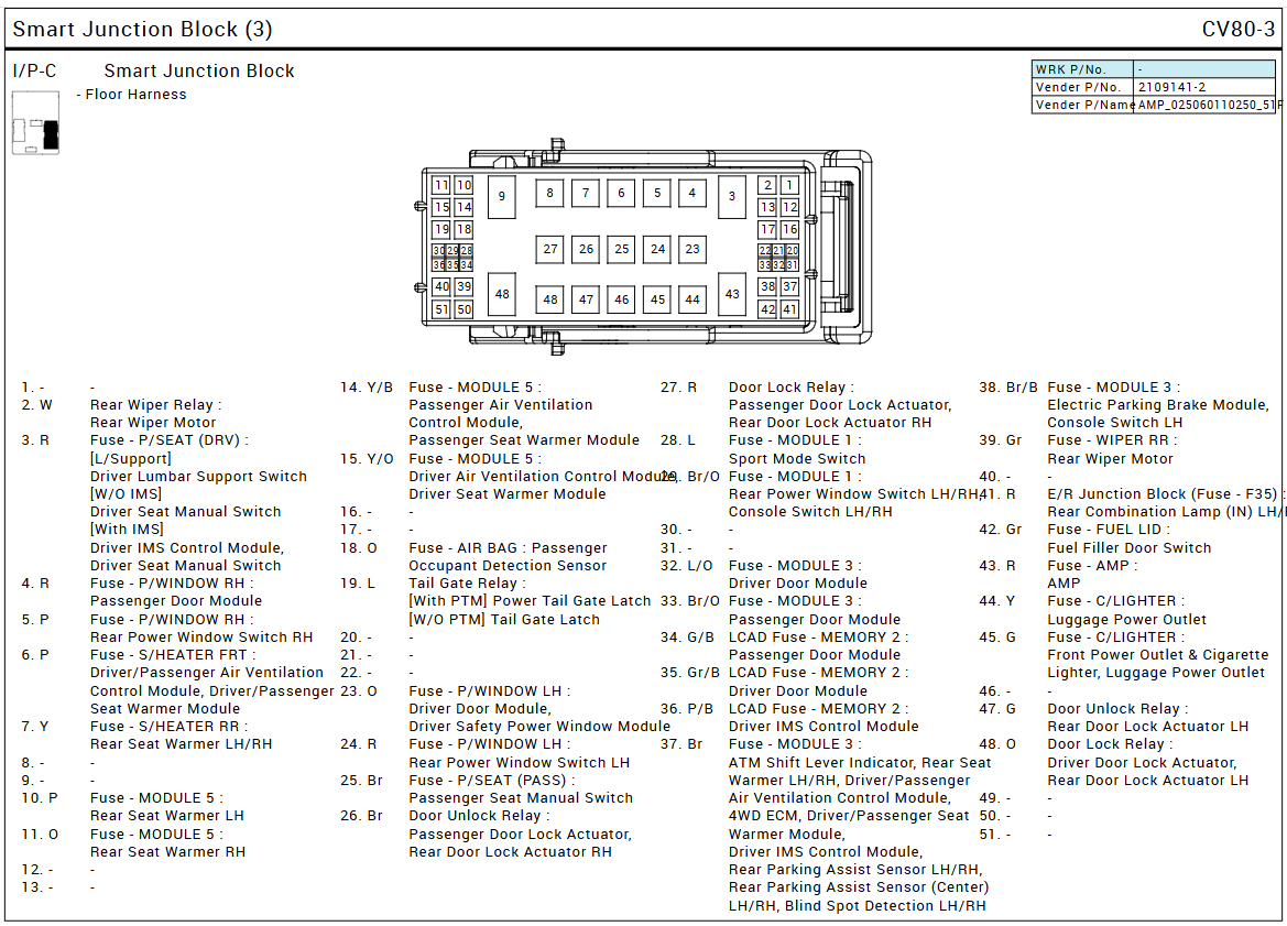

Hi Ken, what I got from a junk yard is a 2017, sorry to I did not mention, but the car Santa Fe that had fire, is a 2013.
So, I need the ecu pin out for this 2017.

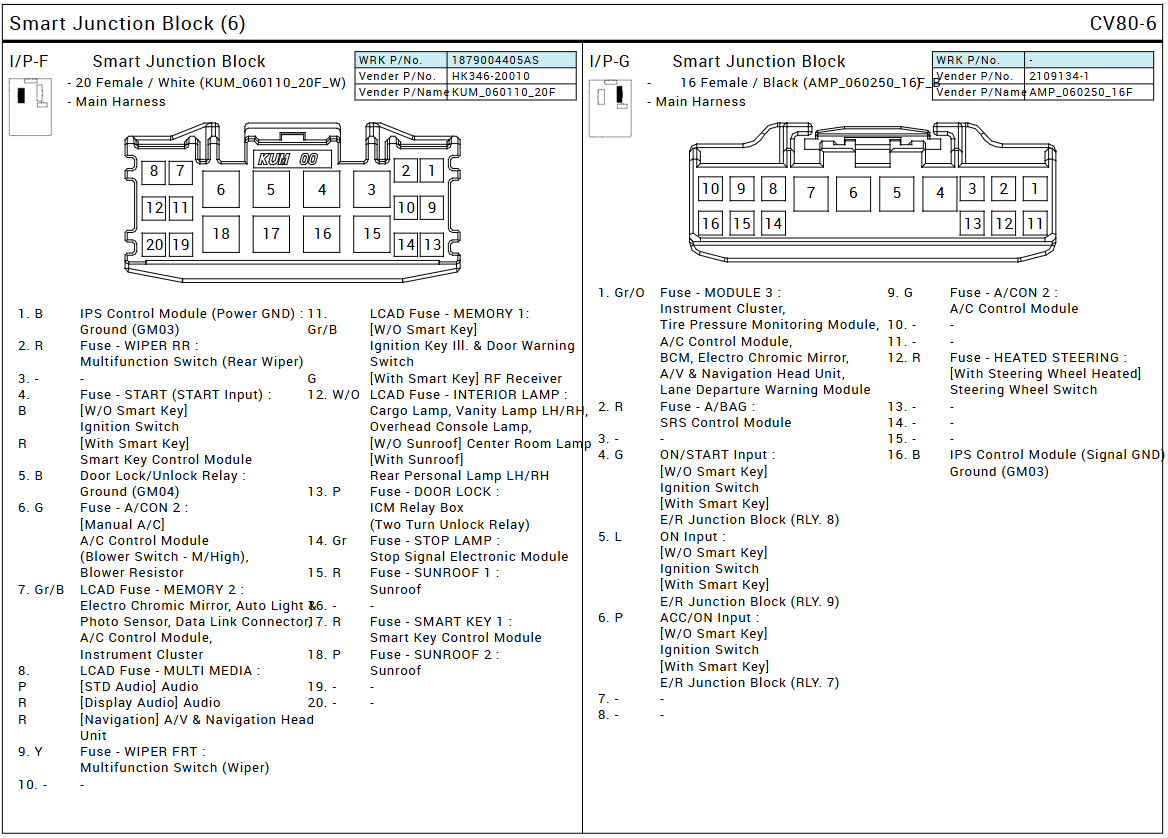

Engine fuse box diagram pinout
Thanks!
Jun 28, 2025 at 12:43 AM
  • 54,837 POSTS

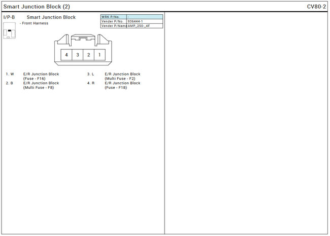

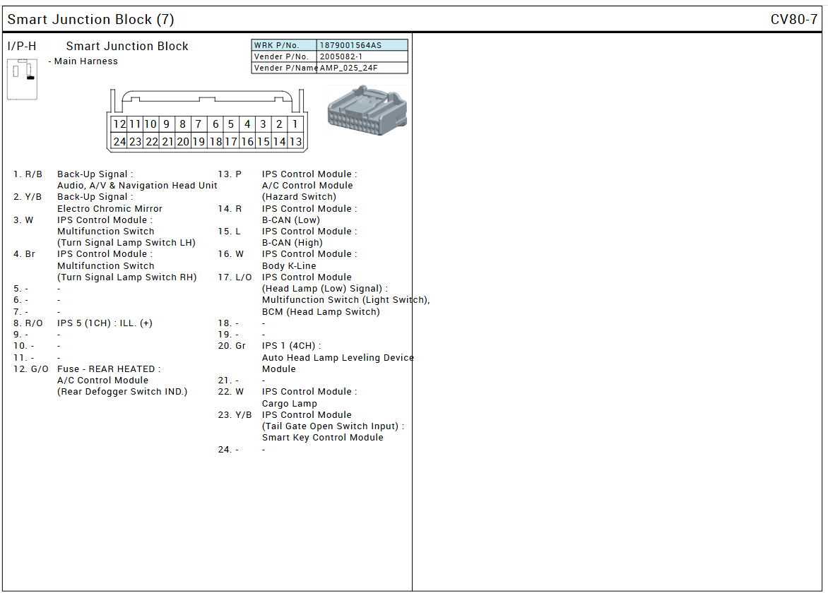

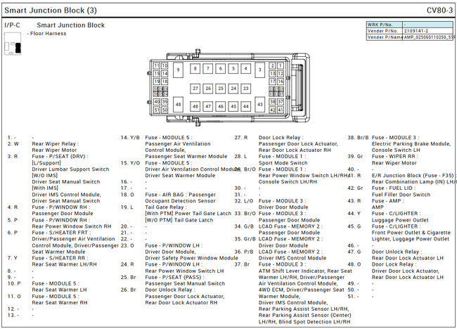

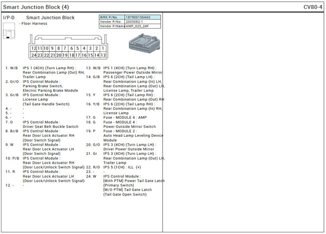

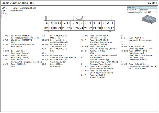

I am sorry to hear that, fires are hard to repair. Here are the pin outs for the smart junction box, (fuse panel). Check out the images (below). Let us know how it goes.
