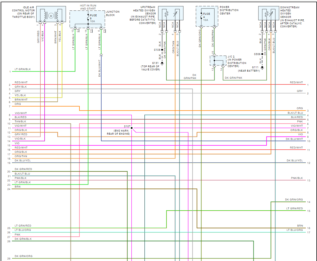

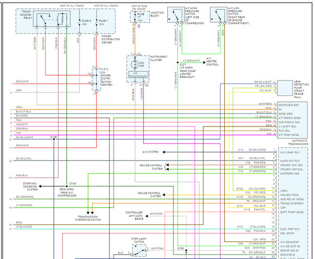

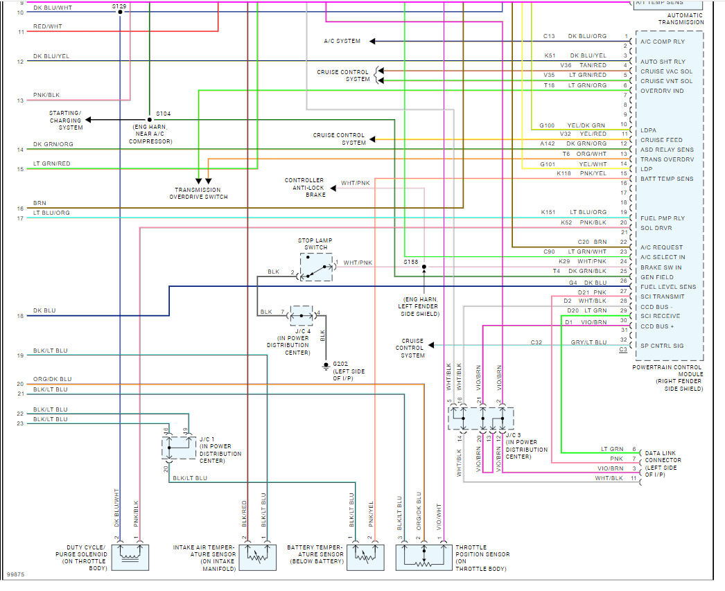

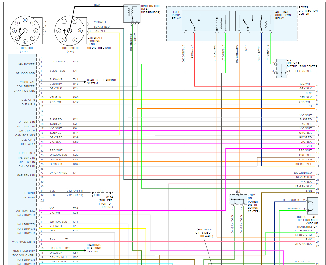

Hello, I am looking for the engine wiring diagram for the PCM for the 5-volt power supply. The engine runs and then periodically shuts off losing 5-volt supply.
Jan 26, 2024 at 10:57 PM
  • 55,421 POSTS

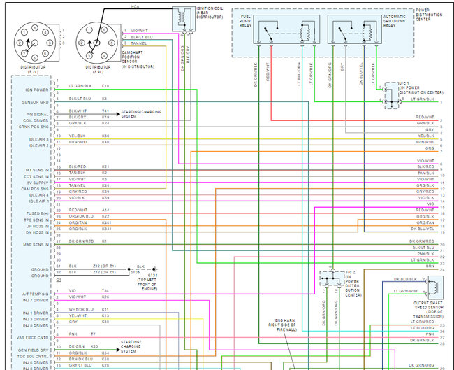

Sounds good, here is a guide to help check the wiring and the engine wiring diagrams as you have requested:
The five-volt reference can be disrupted by a shorted sensor, when you lose the reference, I would start unplugging sensors to see if it comes back. Check out the images (below). Let us know if you need anything else.
Jan 27, 2024 at 4:04 AM
DARIN EMMETT
  • 10 POSTS

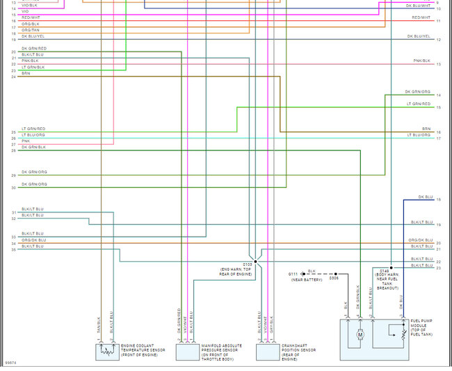

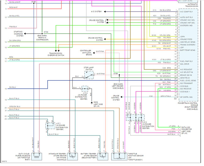

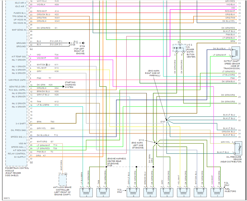

Thank you for the schematics. Still having the same issue. Engine dies, no 5-volt ref and no buss message on odometer. If the connectors to the PCM are wiggled power comes back. PCM has been replaced with a rebuilt. I'm thinking the new PCM is bad as well? Unplugging sensors has no effect. All pins and connections at the connectors look good as well.

I have seen an instrument cluster cause this issue as well. Can you try unplugging it to see if the 5 volts comes back? Also, it does sound slie the new PCM is bad as well, did it have the same problem with the old PCM?
