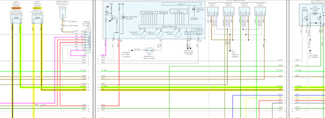

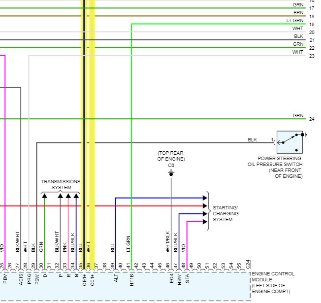

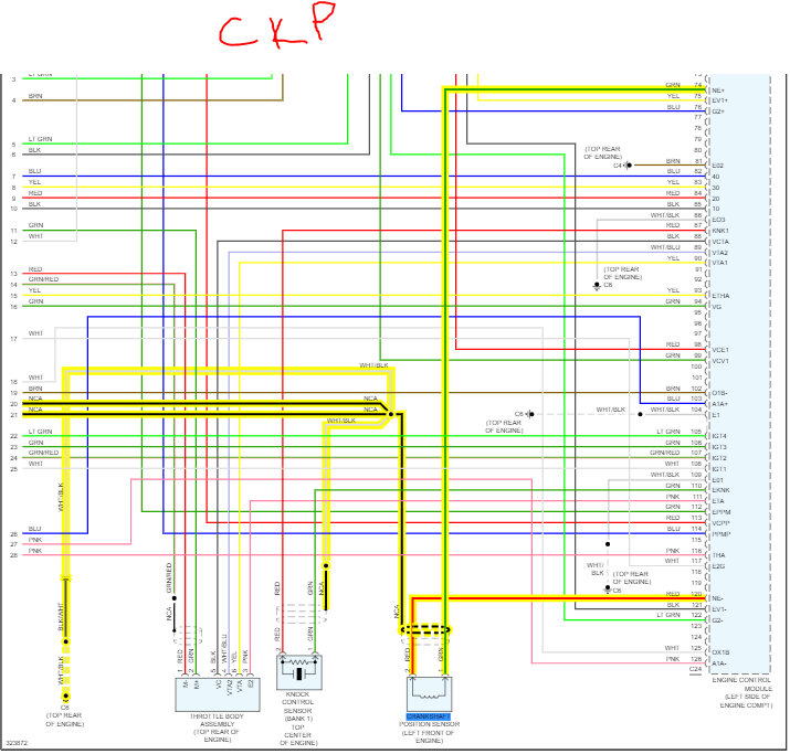

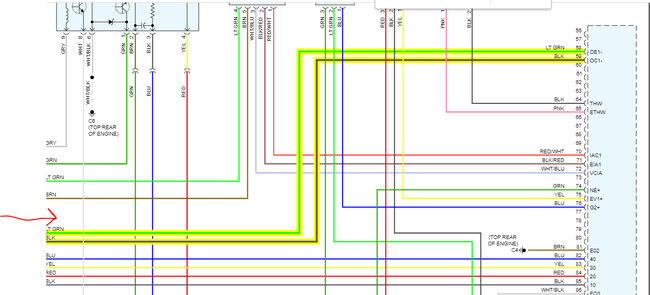

Please, I need the correct wiring to my crankshaft sensor and camshaft sensor. The socket is broken, and the technician is unable to harness the correct color codes for the socket.
Jul 8, 2023 at 11:07 PM
  • 110,240 POSTS
I attached pics below of the crankshaft position and camshaft position sensor wiring. Pic 1 is the crankshaft sensor. The remaining pics are for the camshaft position sensors.
Let me know if this is what you needed.
