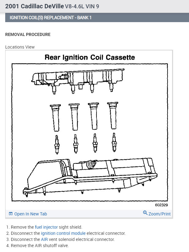

What kind of wires or coil do I need for a tune up?

This vehicle has two coil packs and not wires.
A typical tune will only need to replace the spark plugs. Of course, if the coil pack is failing you will have to replace that as well, but it is not a maintenance item.
https://www.2carpros.com/articles/how-to-tune-up-a-car-engine
I have attached a diagram below for your reference.
