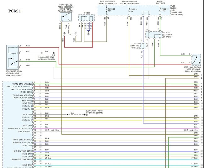

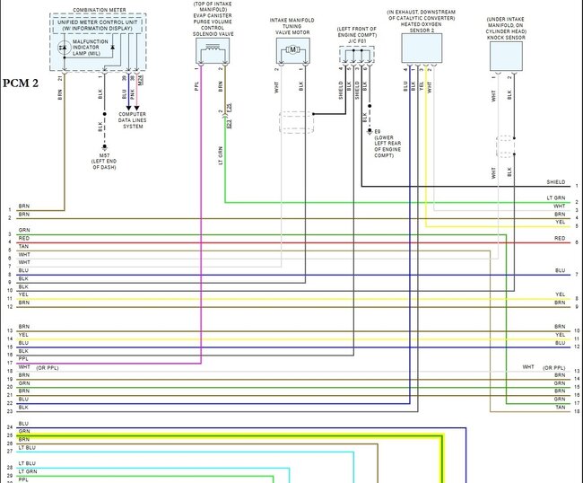

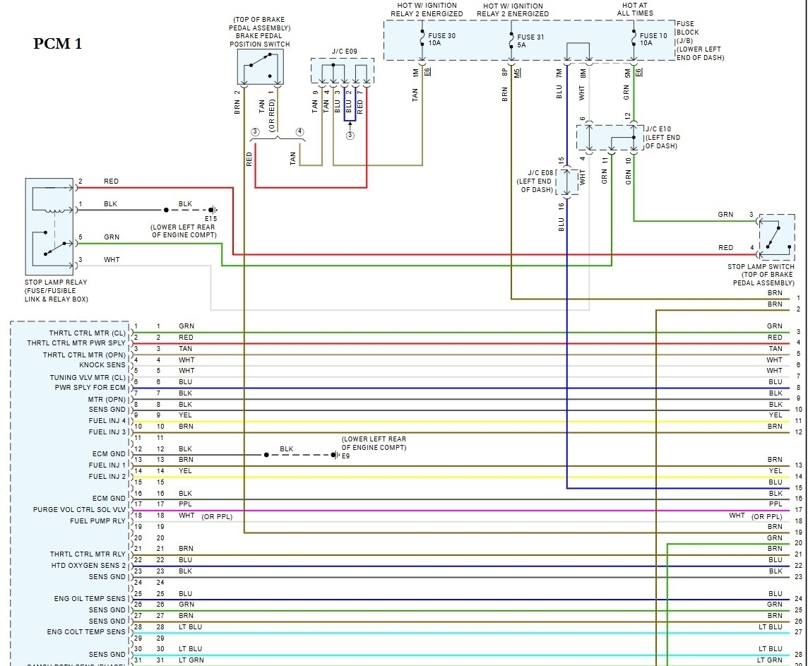

I need to replace the engine wire harness in my car listed above SV. Having a hard time finding a diagram for inserting the new harness.? Harness is part #20411-9HS3A

Hello, are you looking for the PCM and sensor section of the wiring harness? It looks like the PCM is located next to the battery.
Sep 14, 2024 at 10:18 AM
AL514
  • 5,656 POSTS

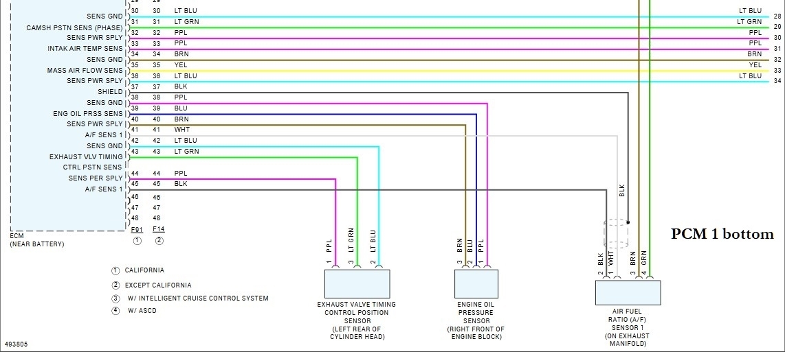

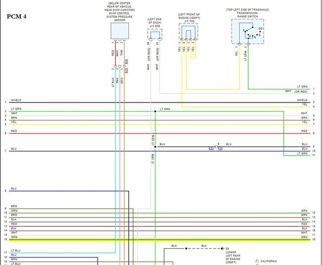

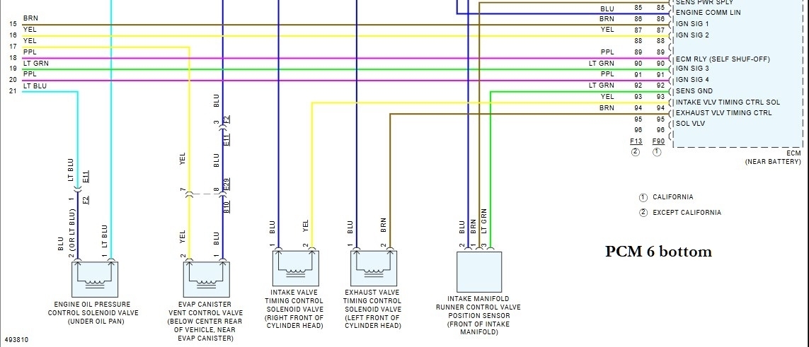

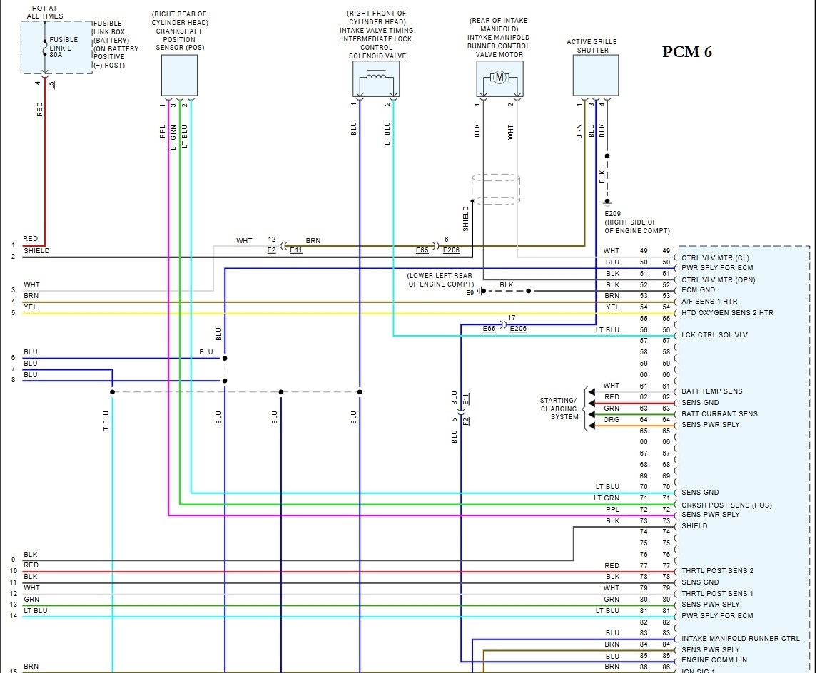

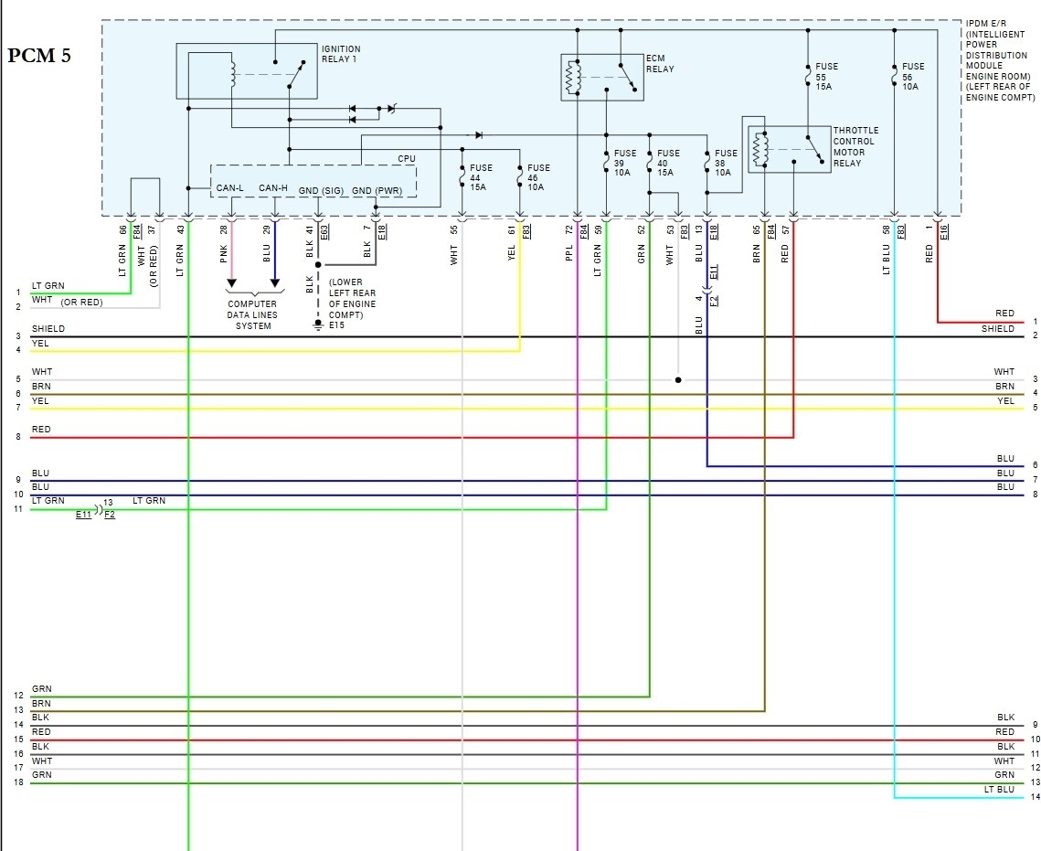

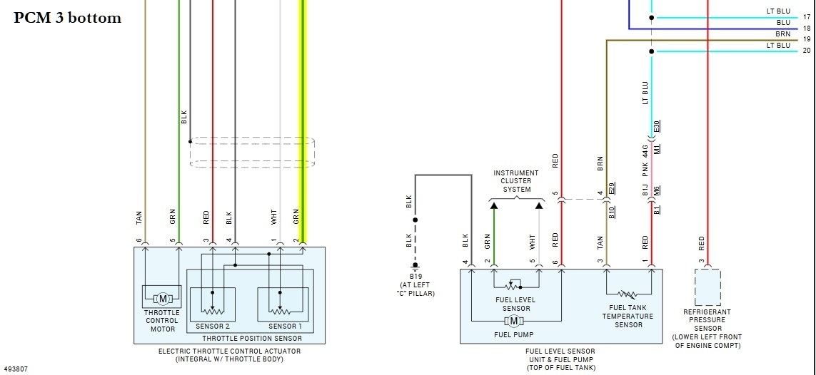

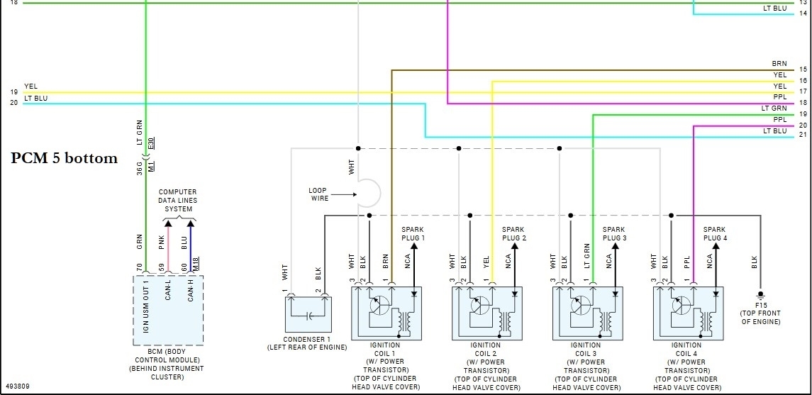

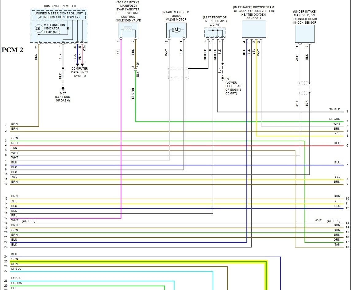

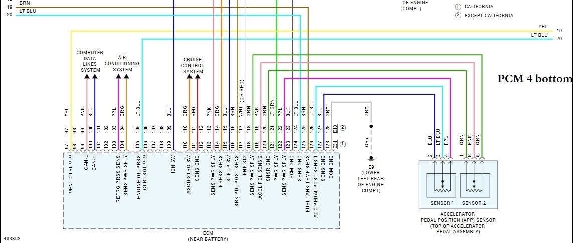

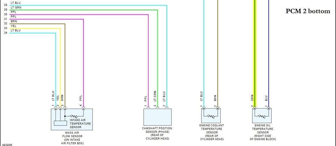

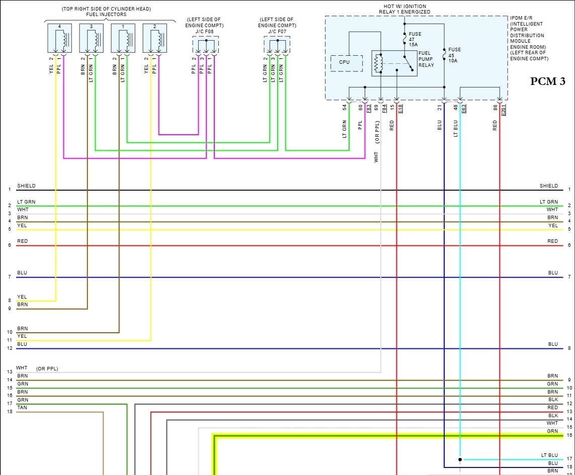

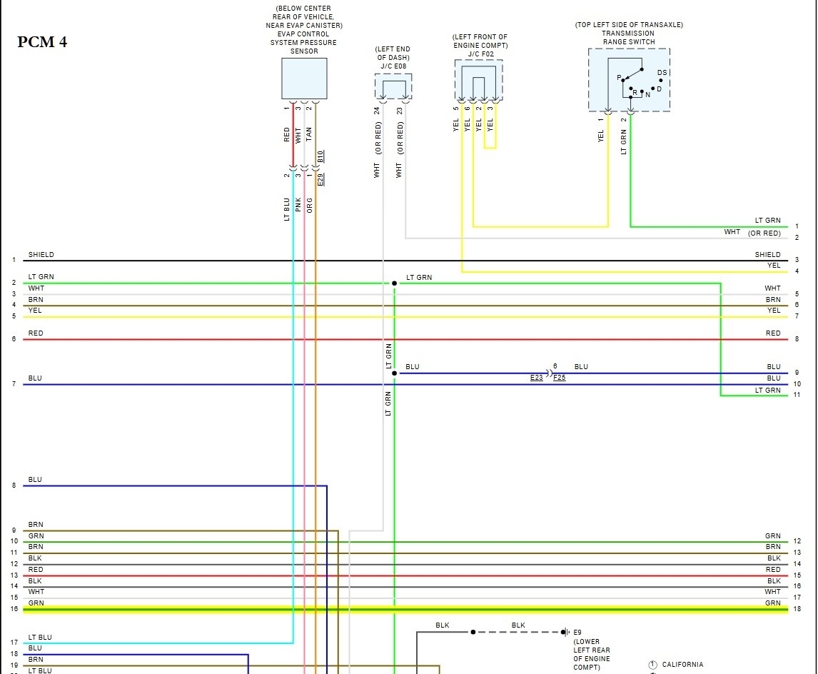

These are the PCM/ECM wire diagrams 1,2 top and bottom, etc. So they are zoomed in enough to see the wire labels. if you need other diagrams as well, just let us know.
