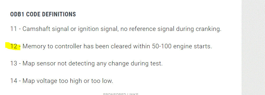

As far as code 12, it indicated the controller has lost memory. It's likely from disconnecting the battery. (See pic 1) As far as codes 1 and 2, they don't exist. It should end with a 55 which indicates the test is complete.
Let me know what you find, and I'll watch for the pics.
See pic below.
