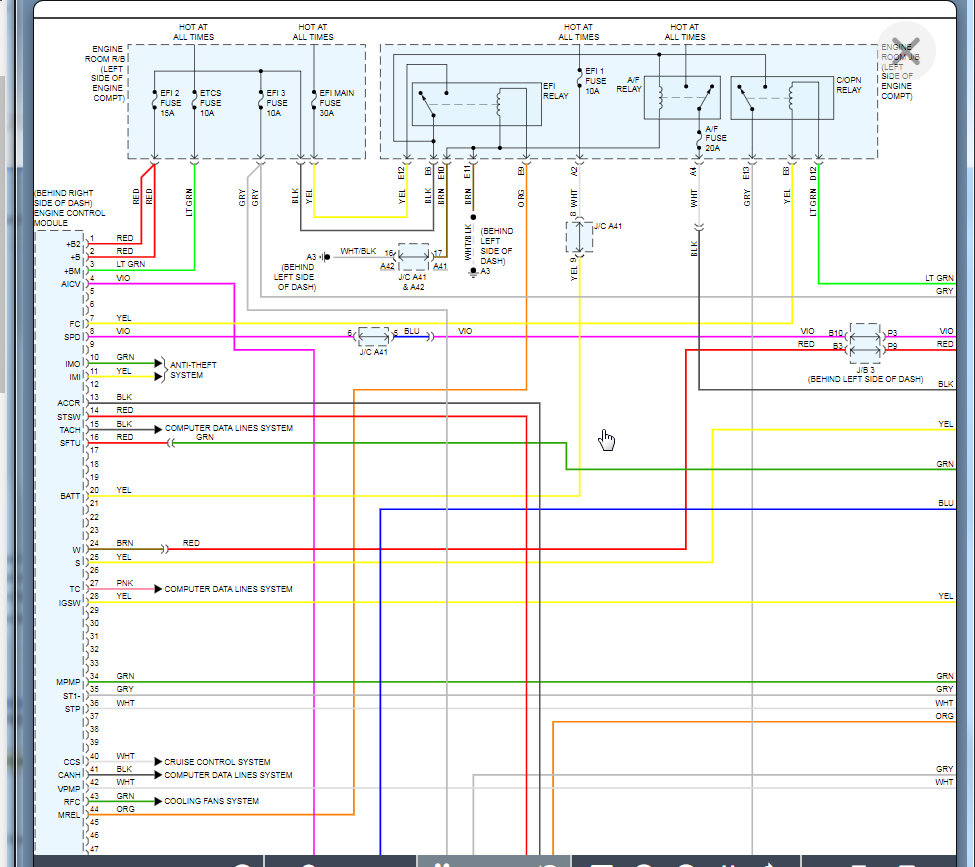

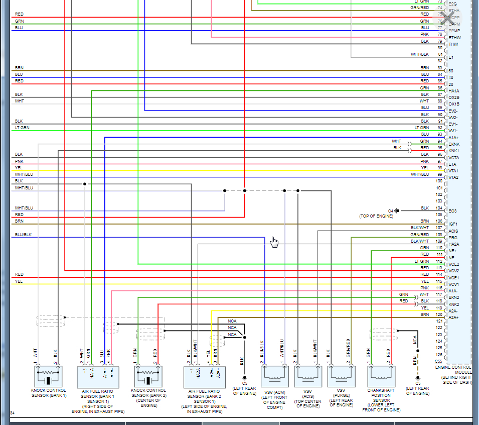

I want to a chat, or video or file on how to identify engine wire base on the color, knowing the location and function.
May 21, 2021 at 6:47 AM

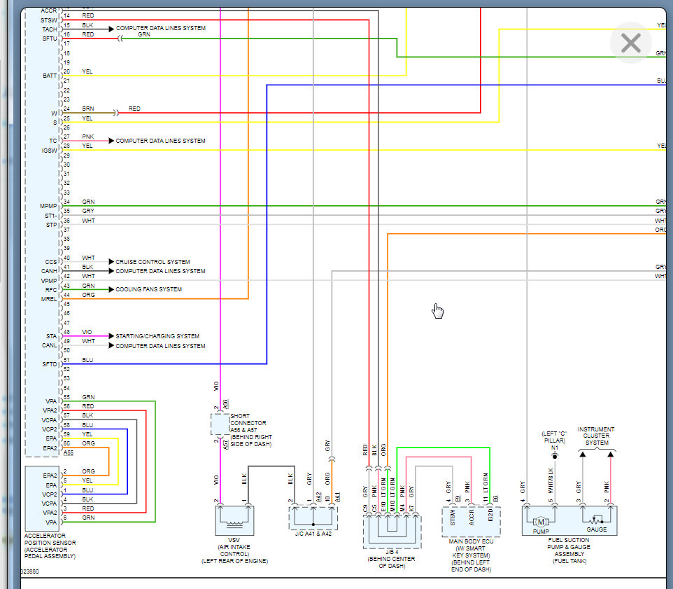

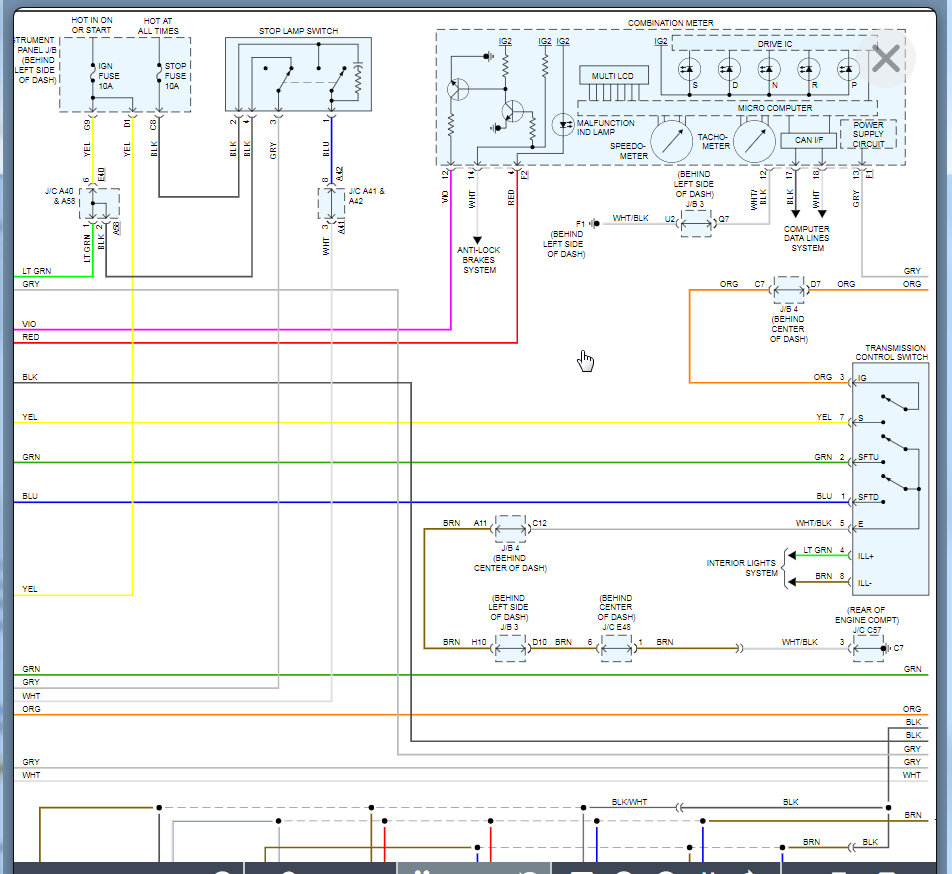

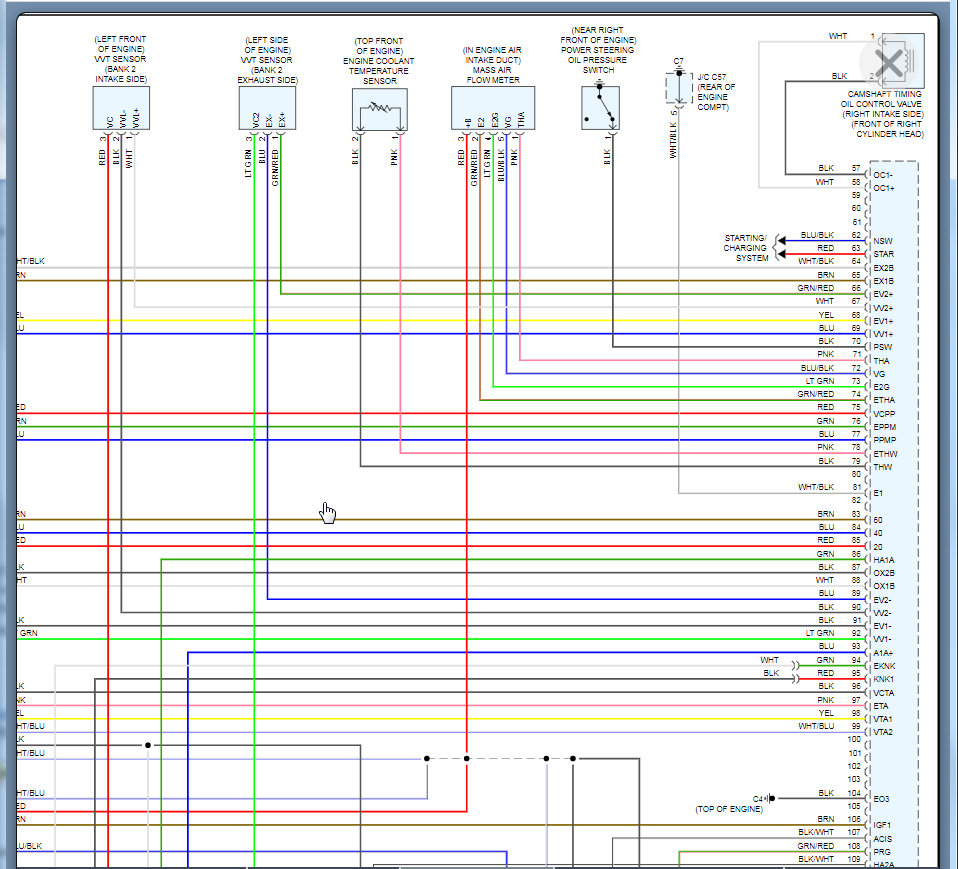

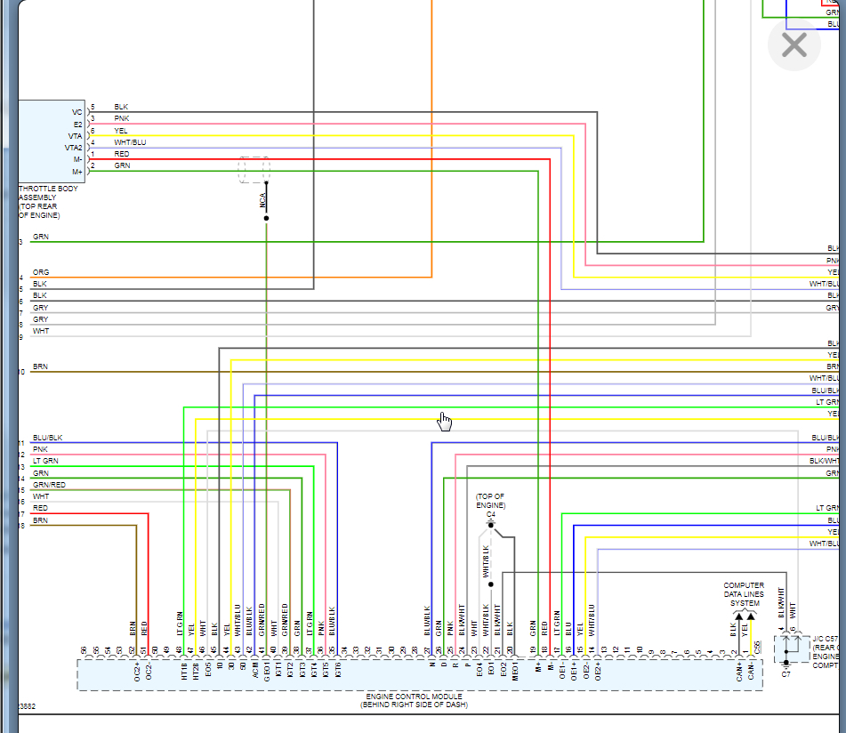

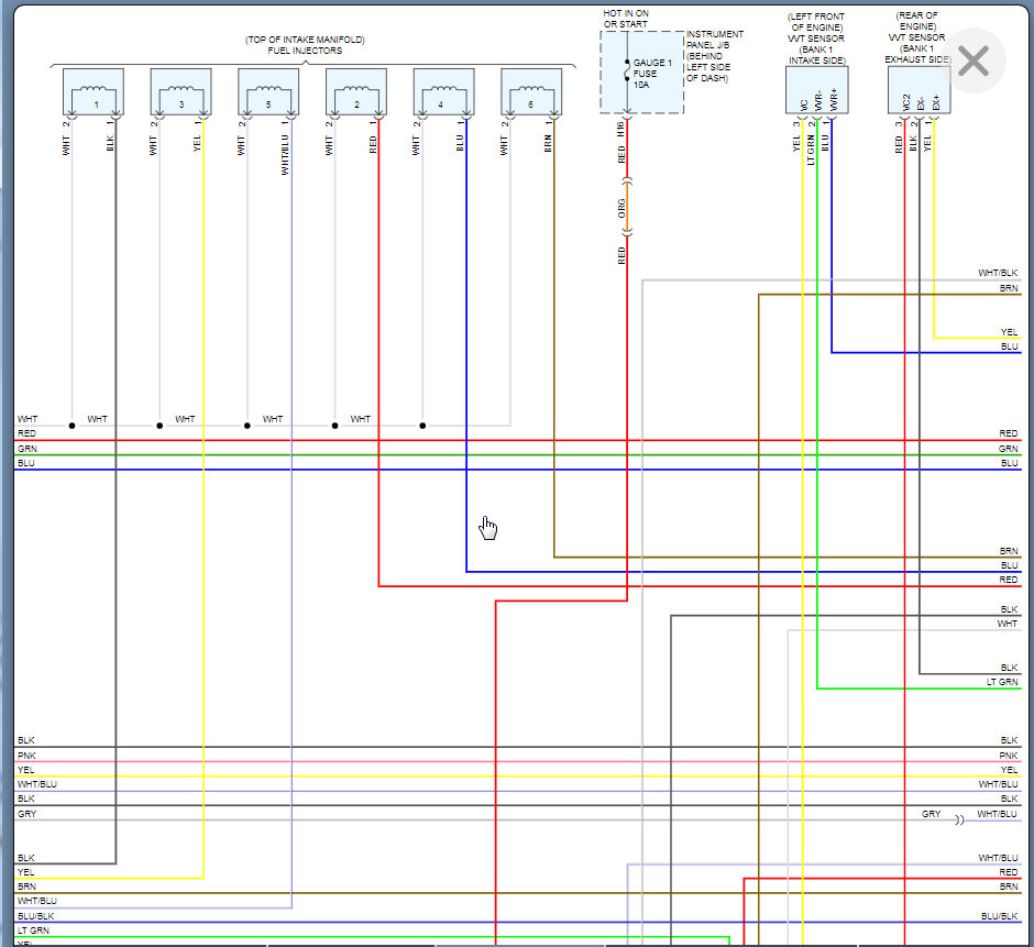

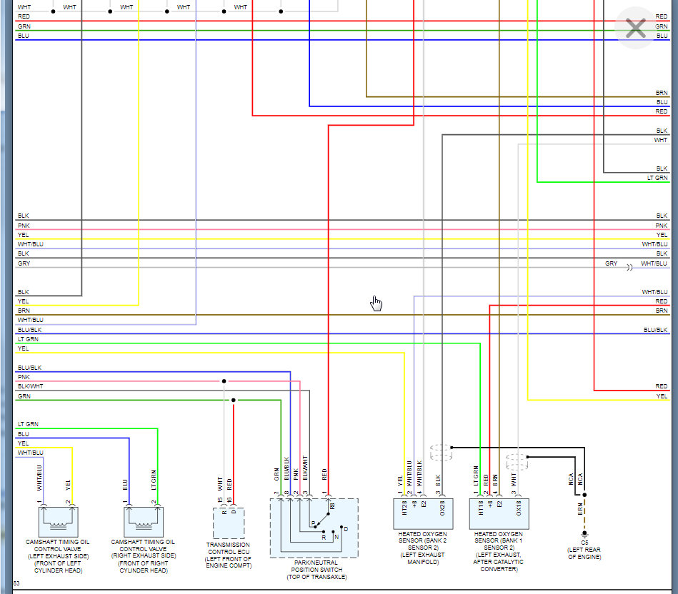

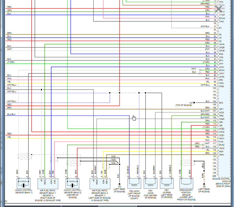

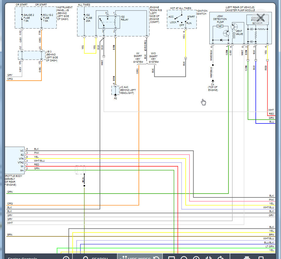

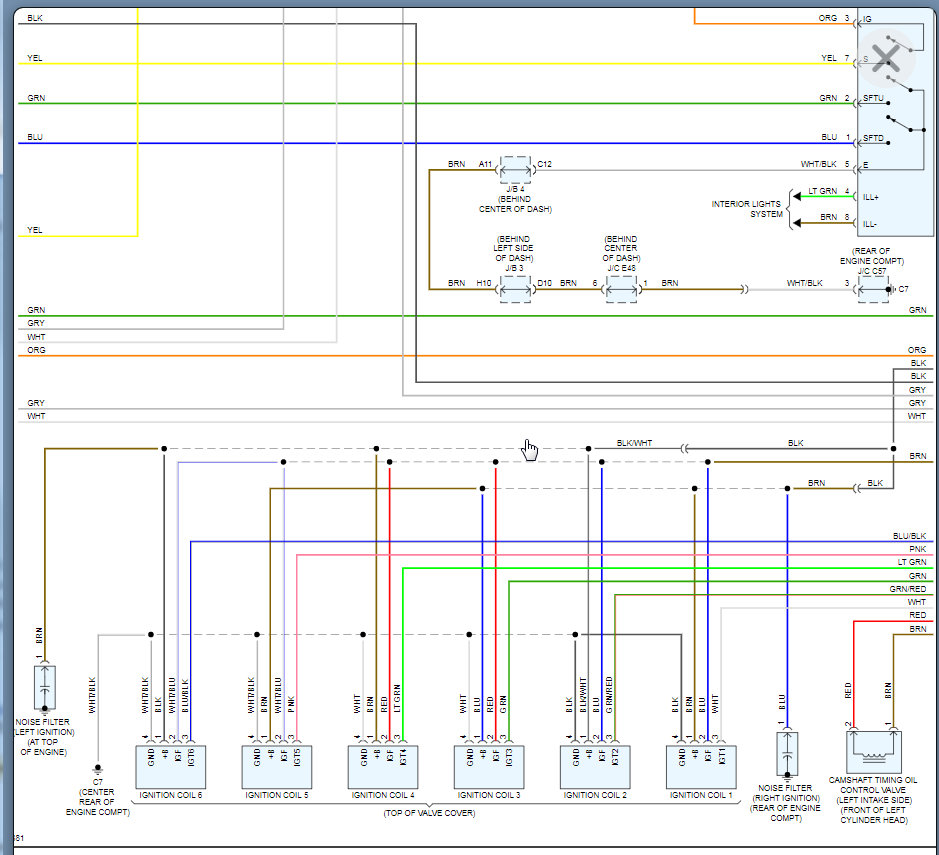

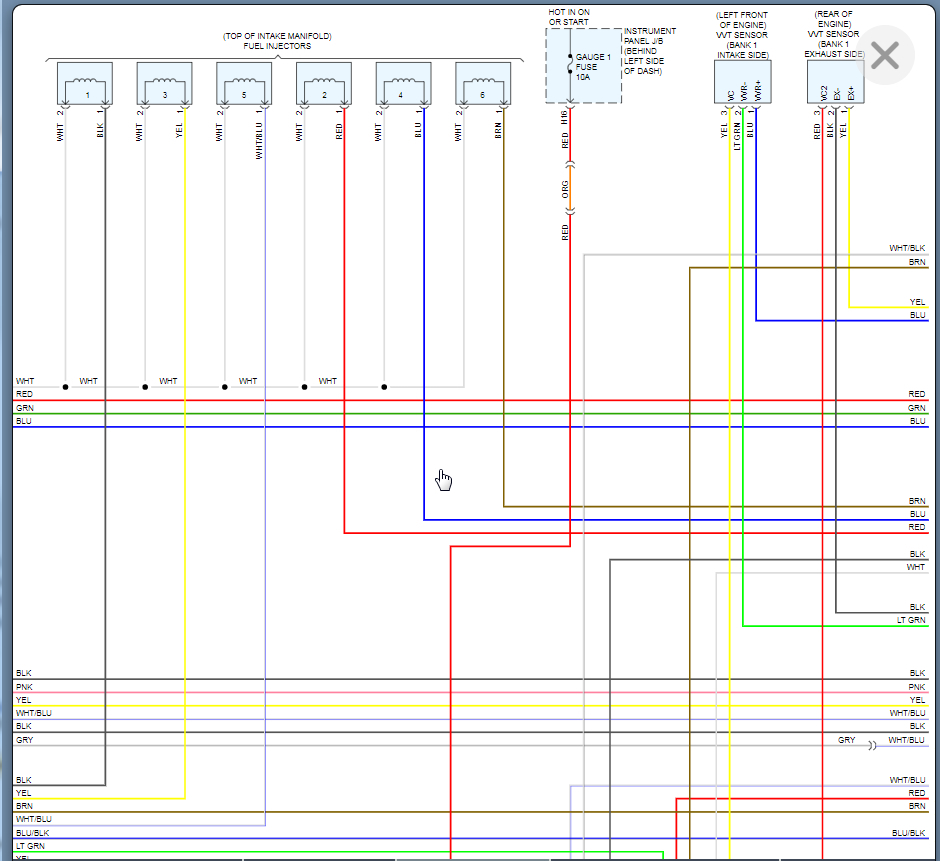

I am providing the complete powertrain wiring diagram. However, I suspect this is not the correct one for your engine due to what you noted on the heading.
We do not have an option for 4WD/AWD Camry in the USA nor do we have a turbo option. So if this is accurate that you have 4WD and a turbo engine then this is not going to be correct for your engine.
Unfortunately we only have manuals for the vehicles that are offered in the USA so if this is not in the USA then unfortunately we don't have this diagram.
Please see below for the diagram that we do have. Please let us know if we can help in other ways. Thanks
