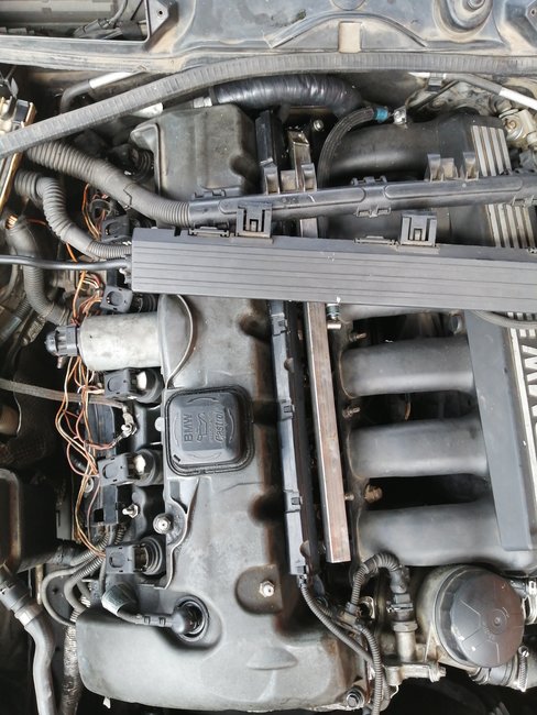

My problem started when my car backfire and the engine off. Ever since then it had been a start and shut off immediately. If I start the car and press the gas pedal it will run rough and for like seconds and die. It got it to idle once by it run very rough and after like 5 minutes it shut off. Trouble code am getting are p1553, p1554, p0369, p0102, p0140, and p0015.

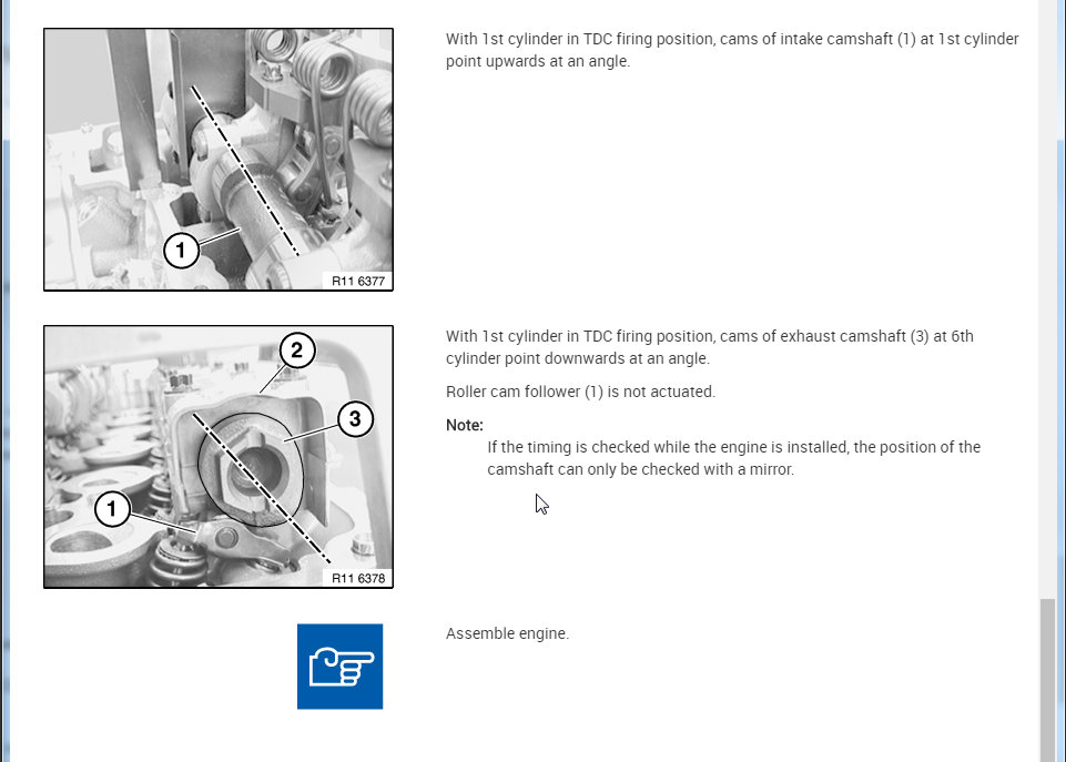

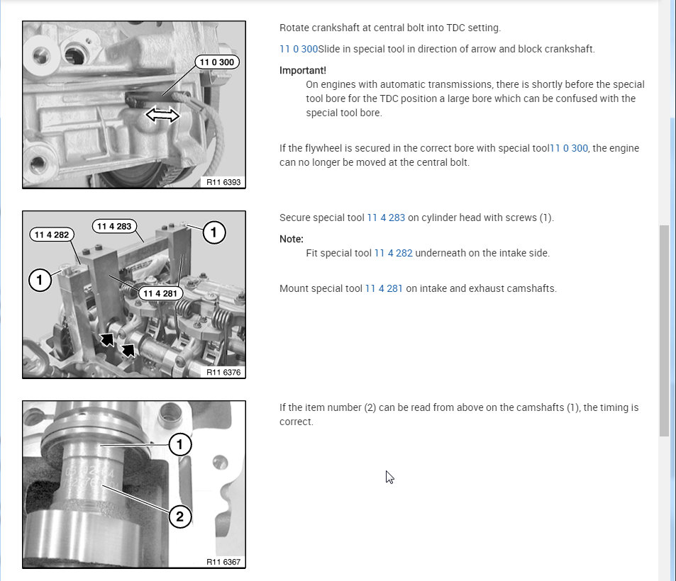

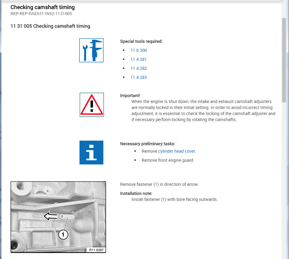

Based on all these and what you are experiencing, it appears the engine is out of time. The backfire was probably when the engine jumped timing and shut off. Unfortunately we are going to need to pull down the engine and check the timing.
I attached the process on how to check the timing. Please let me know if you have questions and we can from there. Thanks

Thanks, can I have a video to show me the process of checking engine timing?
Mar 27, 2020 at 4:41 AM
Unfortunately we don't have a video on this engine. The best I can do are the instructions I provided. I looked online for a video but could not find one on your engine assuming you have the M54 engine. Is this accurate or do you have a different engine?

Thanks, I have set the timing and the car started and run but rough later shut off the same way. Check again it has jump timing. What can the cause of it jumping timing?
Mar 28, 2020 at 2:18 AM
The most common cause of an engine to jump timing is a loose chain/belt. This could be due to it being stretched or more likely the tensioner is not keeping the proper tension. The other common cause is the chain/belt and sprockets are worn and when tension is put to them, they can't hold it and they jump a tooth or two.

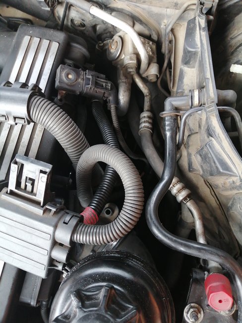

If the timing is correct then we need to inspect the sensor itself for the P0012. The MAF is most likely different then the cam sensor code but if it were me, I would start with this one and if it is gone and the intake cam code is still there then you can address it.
More than like the MAF sensor is failed and needs replaced. However, here is a process on how to clean it. I would start with this and see what codes come back.

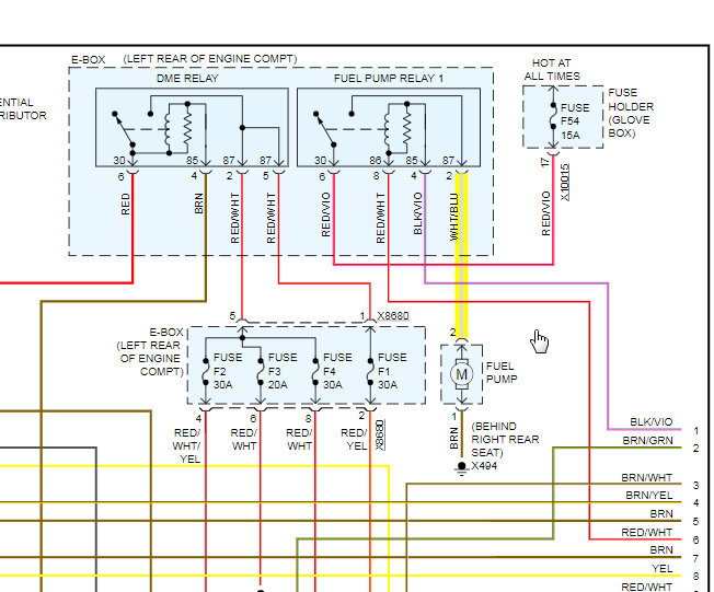

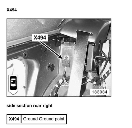

I just noticed that the voltage the fuel pump is 7.5v and not up to 12v.
My question is, what could be the course of this problem and where can start from in diagnosing this issue?
Code I still get are p1124, p0205 and p0102.
Apr 10, 2020 at 8:59 PM
Okay. The P1124 is a throttle position sensor out of range.
P0205 - Is an injector circuit out of range.
The fuel pump only having 7.5 volts is normally caused by resistance in the circuit or a faulty ground. The ground is X494 which is behind the right rear seat. I would suggest taking the fuel pump relay out and unplug the fuel pump, then measure resistance from Pin 87 from the relay to the fuel pump connector. You should have less then a half ohm of resistance.
Then check the ground and make sure it is clean and tight.

I started are fresh and got 6 new plugs and change the coils. The car started, idled for a bit then shut off. I restarted it and press the gas pedal but the could not pass 3 rpm and later loss power then shut off. Try starting it again but no start.

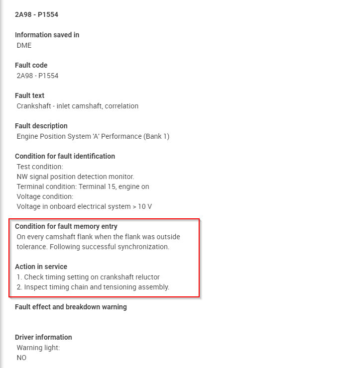

Okay. So replacing plugs and coils that all failed on the secondary side got the engine to start. Now it is not starting again. I would test the coils again and see if the secondary side is failed again. These codes all point to an open circuit issue so I am thinking we have a possible driver issue with the ECM. Remind me if you replaced the ECM already or not?
Let me know if the coils are okay and we can go from there. Thanks

And also as I pulled out the plugs I noticed only cylinder 4 to 6 fire. Cylinder 1 to 3 did not fire.
May 22, 2020 at 8:51 PM
I doubt this is a compression issue but here is a guide if you want to check it:
Just reviewing these codes and the history on this thread, I hate to say it but it appears it jumped timing again. I see that this basically happened the same way as it did prior and you found that the timing had jumped.
If it did, then we either have a chain issue or a possible tensioner/guide issue. Basically there is too much slack in the chain and once there is tension put to it, it jumps timing and the engine cuts off.

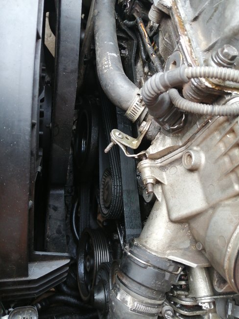

Okay. Sounds great. Before you mess with the bolt, just push on the chain and see if there is much slack. There should be very little. It should feel pretty tight. At least that will give us some idea that we are on the right path. Thanks
May 24, 2020 at 12:55 PM
UZOMAKIY OKPALA
  • 41 POSTS
I have done it and the chain looks pretty tight, because I was touching it while a turn the engine manually. Set timing and start the car and it runs poorly only if I press the pedal and it never revved pass 3 rpm and later shut off the same way. After 3 attempts with the same thing car won't start and gives car codes p0015, p0102, p0205, p0203 and p1124.

Great update using that video. Two things. First the metal shavings that you felt is not a good sign. Most likely that is bearing material and could cause some issues but I don't think it is causing this one. I suspect that tensioner is your issue.
I can't say I have ever checked the tension on an N52 engine but most tensioners that I have felt, I could not compress.
Here is a video of someone changing the tensioner and he squeezes the old one and it does not compress at all. Now this may still have the oil in it but even still when he is installing the new one, it appears to have a lot more tension when he is screwing it in. I may have missed it but was that a replacement tensioner or the existing one? Either way, I would get another and compare it. Even if you took that one down to the parts store and just took the new one out of the box and compared the spring tension.

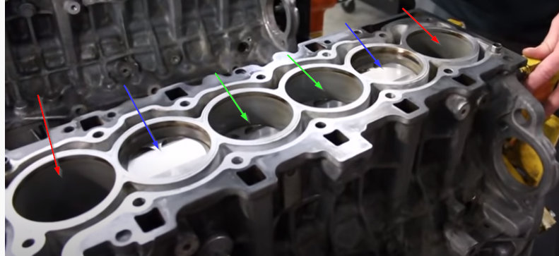

Another thing, I just noticed is that when cylinder 1 is at top dead center cylinder 2 is also at TDC. Is that a good sign or what?
May 29, 2020 at 1:45 AM
That engine sounds like it is knocking or rattling quite a bit. Have you drained the oil and cut apart the filter to see how much metal is in it? Drain the oil into a pan and then pour it through a coffee filter to see how much metal is there.
As for the pistons, that does not sound correct. Take a look at the picture of your block with no head. 1 and 6, 2 and 5, 3 and 4 are synced together and the piston will be in the same position but on opposite strokes. So when 1 is coming up on the compression stroke, number 6 will be coming up on the exhaust stroke.
If you have number 1 and 2 at TDC, they will be on different strokes but that is not correct.
