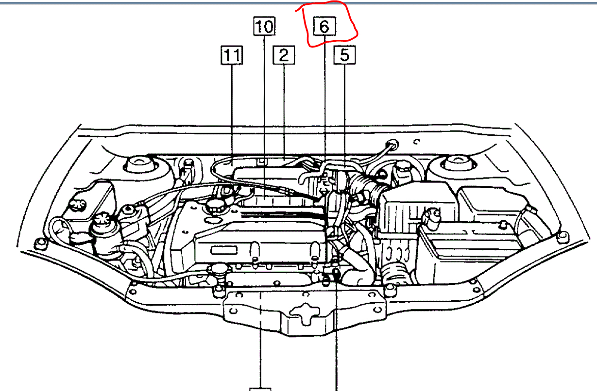

Engine will rev up and down up and down
2001 HYUNDAI SANTA FE
110,000 MILES • 2.4L • 4 CYL • 2WD • AUTOMATIC
RHG1224
A constant up and down rev no matter hot or cold engine.

The most common cause of this type of issue is a bad idle air control valve (IAC). The IAC is what is responsible for maintaining the idle speed. Here are a couple links for you to look through. The first explains how in general to service it and the second is replacement.
https://www.2carpros.com/articles/idle-air-control-valve-service
https://www.2carpros.com/articles/how-to-replace-an-idle-speed-control-motor-iac
This type of issue can also be related to an engine vacuum leak. However, based on your description, I feel it is the IAC.
Here is a link explaining how to check for a vacuum leak:
The IAC is located on the throttle body. See picture 1
