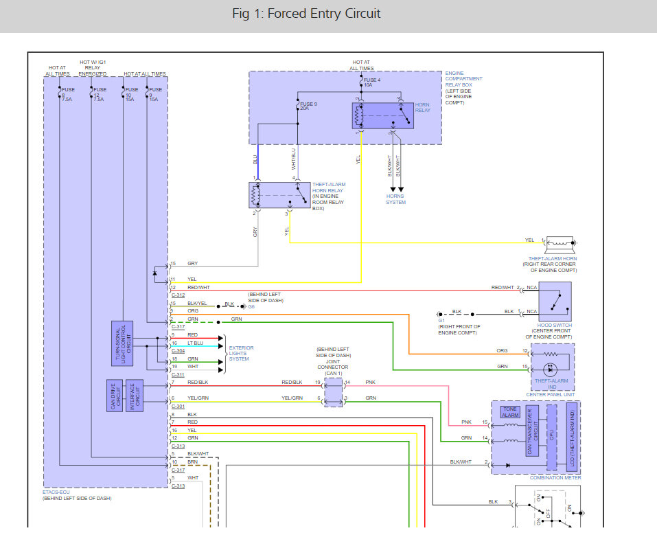

I need wiring diagram for a white rectangular plug-in harness that assembles on the end of the stabilizer control module on one end near steering column on right side. r FCC # ID OUCG8D-648M, Vin#JA4MT31W49ZOO7615.

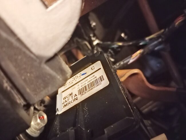

This is photo of black box for the vehicle listed above needing wiring diagram for a 12-pin rectangular white box assembling on upper end, right side of steering column.

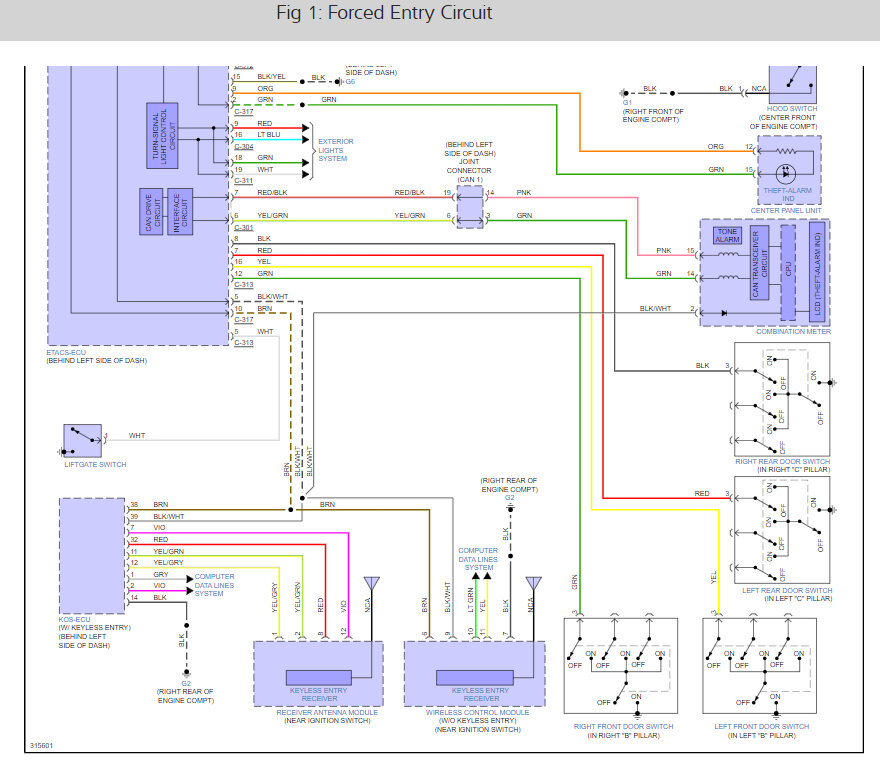

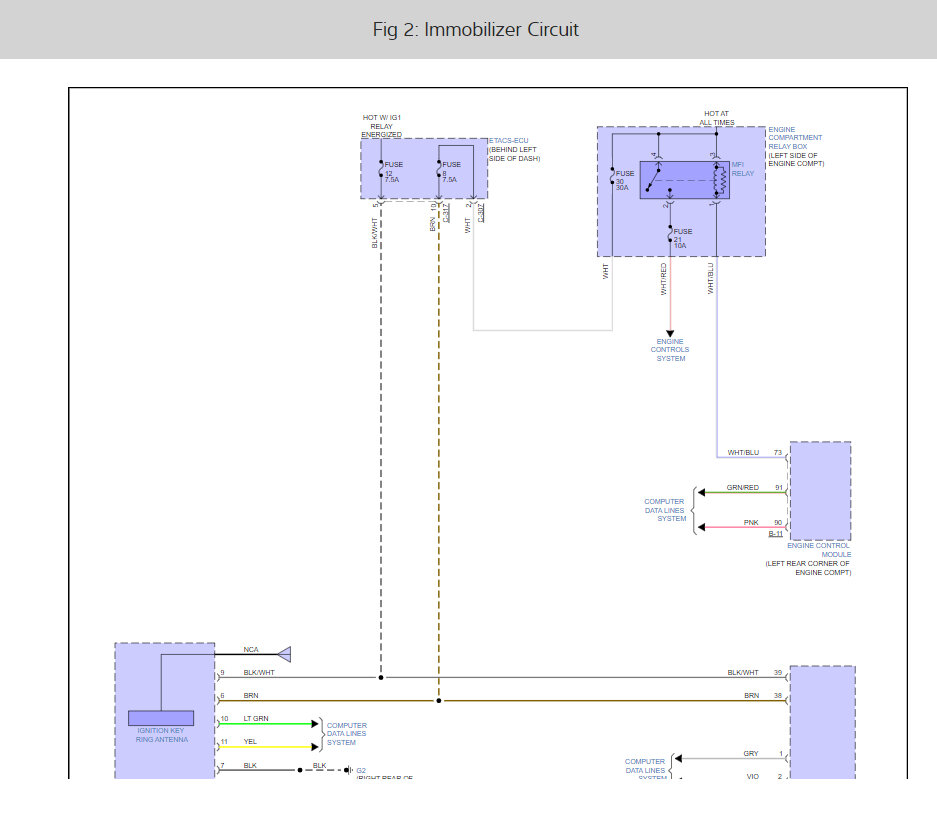

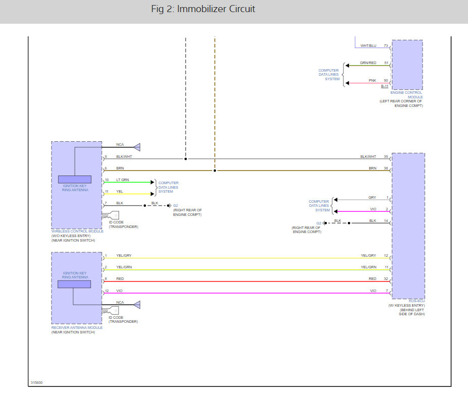

Here is the Immobilizer and forced enter control unit wiring diagrams and a guide to help you test the confections in case you need it.
Check out the images (below). Please let us know if you need anything else to get the problem fixed.

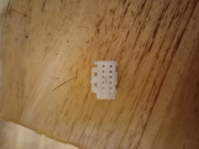

There is a 12-pin white plug-in harness that I need wiring diagram with color coding that plugs into one end and upper right side assembling to immobilizer forced enter control module with photo sent earlier. The dealership has already informed me this white plug is obsolete and discontinued! I'm sending a photo of the 12 pin wiring but need wiring diagram for white box.

This is photo of the white plug-in harness that assembles into anti-theft stabilizer control module, black box photo that I sent earlier. It's a 12 wire pin unit needing wiring diagram for.

Can you check the wiring diagrams above to see if those will work for you? Also out of the 12 pins how many have wires in them?

11 wires.

Yep, it must be the ETACS-ECU but you may not have all of the options. It shows R FCC # ID OUCG8D-648M as the key entry system.

I'm sorry and just a misunderstanding. I have dashboard lights power and key turning ignition lock cylinder, Locksmith is telling me that the immobilizer receiver ring that contains copper wiring around steering column is not functioning to receive radio signal. He says once this happened, he can obtain info for programming the key cutting for the transponder key. Why was this Walker Brothers Mitsubishi dealership so wrong with missing the knowledge that with claims of being a dealership obviously must be a weak one that I'd grade low ass nonsupport with no business in repairs in foreign car repair market as your 2CarPros blows their triple garage bay doors off. They're truly lost.
