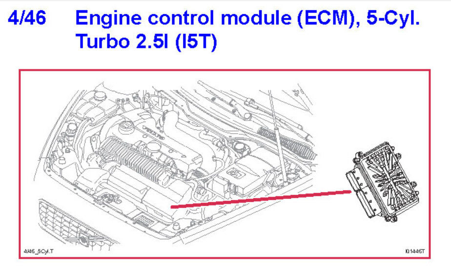

If you are sending power to the starter to engage it and you only get a click, that sounds like the starter itself is bad.
At the starter, you will have a heavy gauge red wire directly from the battery positive terminal. There is also a blue wire that is smaller. That is the trigger wire. There should not be power to the blue wire until the ignition is in the start position.
Have a helper try starting it while you check the blue wire for power. If there is power, replace the starter. If there is no power, let me know and we'll have to go through and check relays and power supplies. Also, take a look through this link and let me know if it helps:
See pic below.

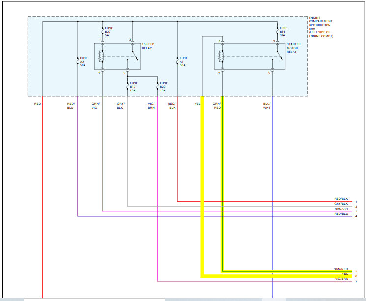

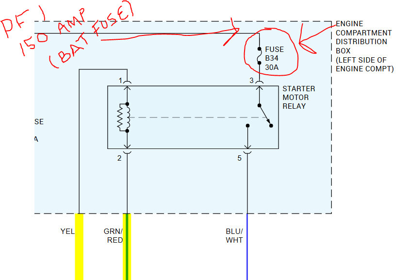

Okay, here is what I need to be tested. Remove the relay and locate pins 85 and 86. I need confirmation that you have both power and ground to them. Both are signaled by the ECM. If that checks good, I want you to use a jumper wire to jump pins 30 and 87. When you jump them, the starter will engage. If it doesn't let me know.
Also, I attached a pic of the power to the relay. Please confirm power is present at fuse B34 In the under-hood fuse box. If there is no power, check PF1 at the battery. That is the power supply to B34.
Let me know what you find.
See pic below.

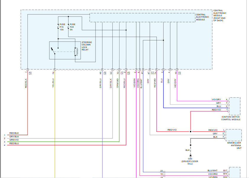

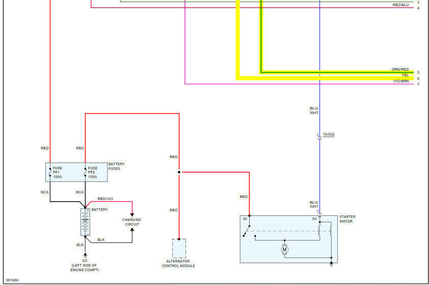

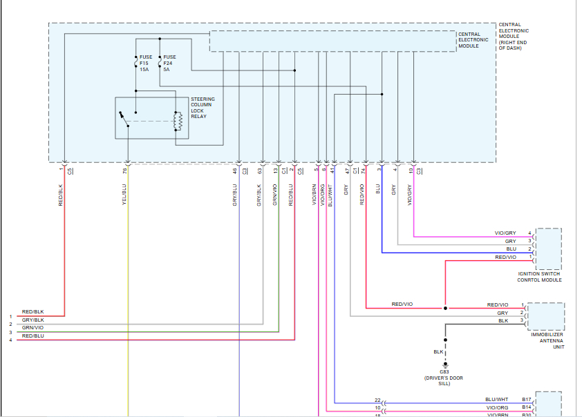

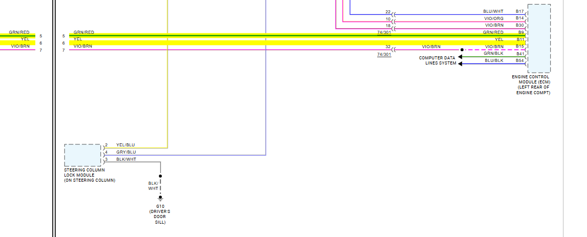

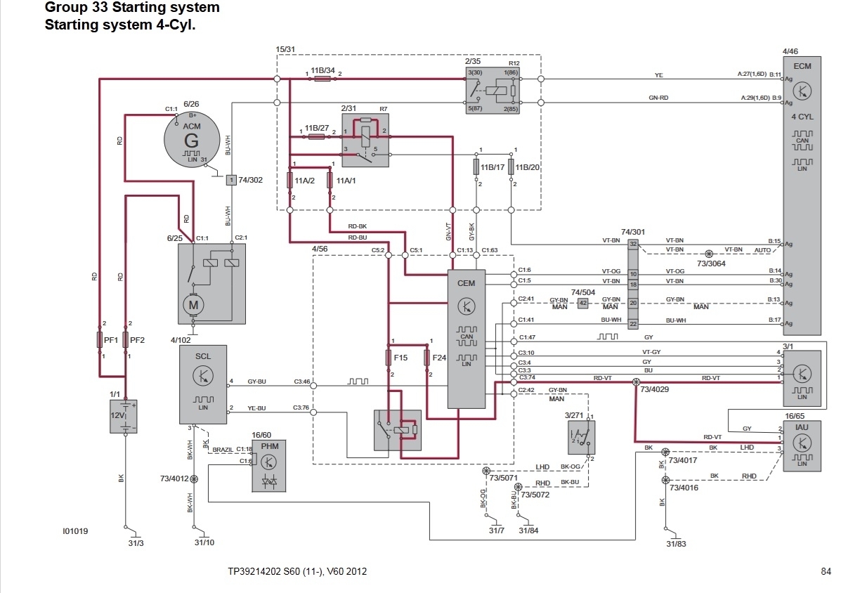

The primary side of the relay isn't getting ground. That takes us to the ECM. I attached the entire starting system circuit below so you can review it.
The next step is to check for power and ground at the ECM. If you look below, you'll see a yellow wire and a green wire with a red tracer that go from the primary to the ECM. They are pins B9 and (connector B).
I can not find a pin-out of the connector, so you will need to locate the color wires I mentioned and then determine which pins they go to.
Let me know. If there is no ground path at the ECM, there is an internal fault with it.
See pics below. Note: The schematic was two pages. I had to cut each page in half to make them readable. I did overlap each section and highlight the wires you need to locate.

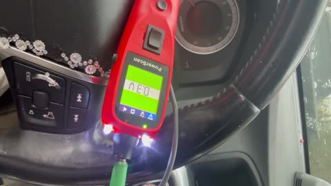

Here's a video of what's happening. I connected a tester to the starter signal wire, and it reads low voltage until I press brake pedal. When I press the start/stop button it's reading a constant voltage until I press the start/stop switch again.
Feb 14, 2025 at 10:33 PM
  • 110,241 POSTS

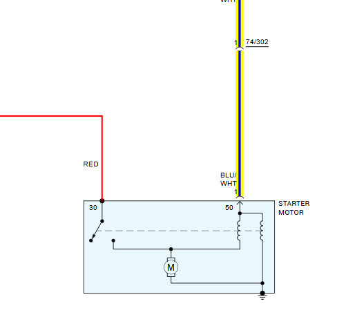

At the starter, there should be a blue wire with a white tracer. It will be a smaller gauge than the red wire. The Blue/white wire should only have power when you press the start button. Are you getting power to that wire under those conditions? If you are, chances are it is the starter.
