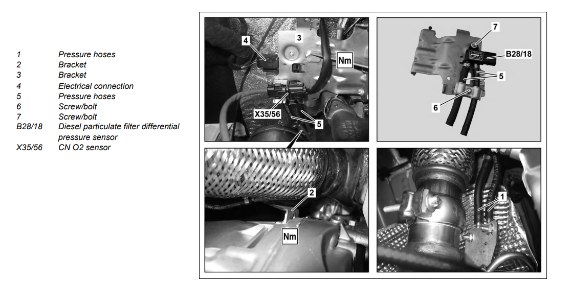

Code P2463 - Diesel Particulate Filter - Soot Accumulation: This code is related to diesel particulate filter (DPF) issues. The ECM (Engine Control Module) uses the data from the differential pressure sensor to determine the level of obstruction/soot in the DPF.
A possible faulty sensor or blocked/broken pipes between the sensor and the DPF could cause a false reading.

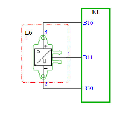

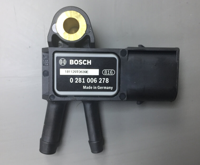

The differential pressure sensor is located in the engine compartment, near the exhaust on the left. It has 2 hoses going to the DPF, see image 1 below
Suggest to locate and check the pipes from the sensor back to the DPF

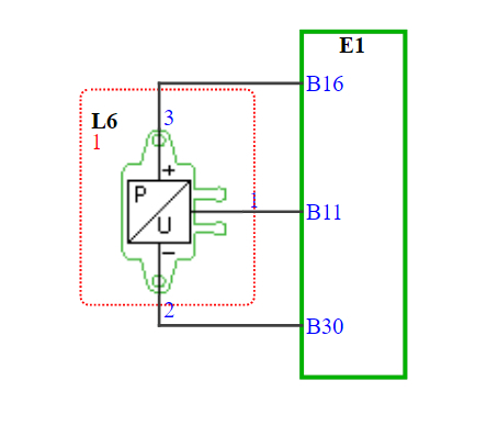

At the sensor there is a 3 pin connector, image 2+3
Pin 1, black wire back to ECM pin B16 signal
Pin 2, violet/brown wire to ECM pin B30 ground
Pin 3, pink/violet wire to ECM pin B16 5V supply
You can check voltage supply, ground and wiring back to the ECM using a voltmeter
