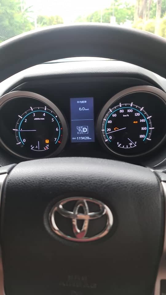

Code P0420, engine warning 4LO blinking and Slip Warning
ANDY MU
  • 2010 TOYOTA LAND CRUISER PRADO
  • 122,000 MILES
When I scan the warning code is P0420 which is to be exhaust catalytic converter 1. I change the sensor, but after 1 or 2 hours, the warning appears again. Please help me.

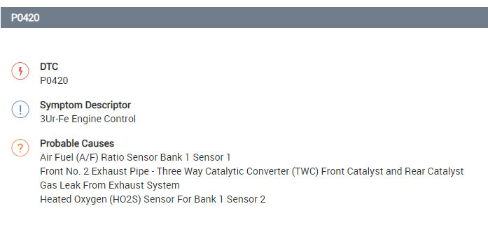

Since you have changed the sensor with no change to the outcome, it is a possibility that the catalytic converter might not be performing efficiently.
As the Prado is not sold in the US I don't have the exact diagnostics, however it should be similar to the Landcruiser that sold in the US.
Here are the probable cause for that code:
DTC
P0420
Probable Causes
Air Fuel (A/F) Ratio Sensor Bank 1 Sensor 1
Front No. 2 Exhaust Pipe - Three Way Catalytic Converter (TWC) Front Catalyst and Rear Catalyst
Gas Leak From Exhaust System
Heated Oxygen (HO2S) Sensor For Bank 1 Sensor 2
I have include a diagnostics procedure for catalytic converter for your reference:
