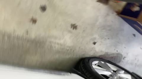

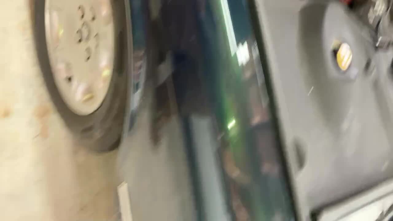

Here’s the video.

Thanks for the video. which is a nice car, sorry about your troubles, it does seem like the engine is hurt, like a head gasket is blown between two cylinders, which is common when overheated. To confirm the problem, we need to do a compression test. This guide can help and show you which side the gasket is blown on, if so, I would do both gaskets since the engine will be apart.
If you would like to do the job yourself let us know and I will give you instructions. Please let me know how the test comes out.
