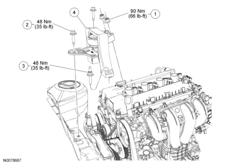

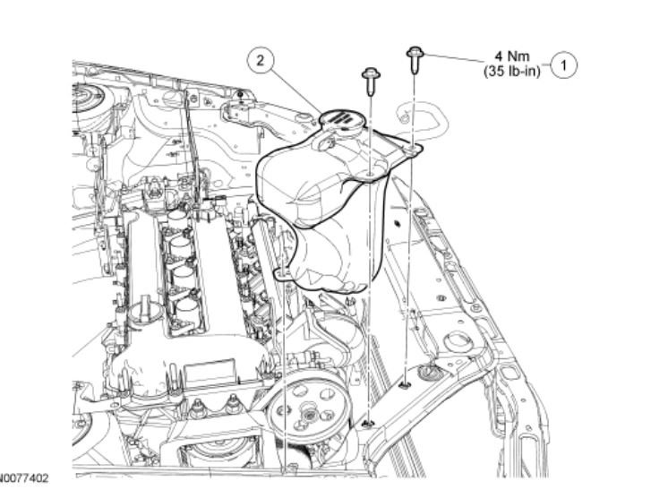

Engine vibrates at idle symptoms.
Jan 23, 2021 at 6:52 PM
Good morning,
This sounds like motor mounts that are worn out.

Removal and Installation

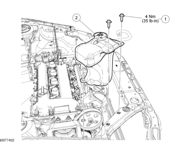

Remove the 2 expansion tank bolts.
To install, tighten to 4 Nm (35 lb-in).
Lift the coolant expansion tank off of the engine mount stud bolt and position it aside.
Install the Engine Support Bar.
Remove the 2 engine mount nuts.
To install, tighten to 90 Nm (66 lb-ft).
Remove the 2 bolts, stud bolt and the engine mount.
To install, tighten to 48 Nm (35 lb-ft).
To install, reverse the removal procedure.
